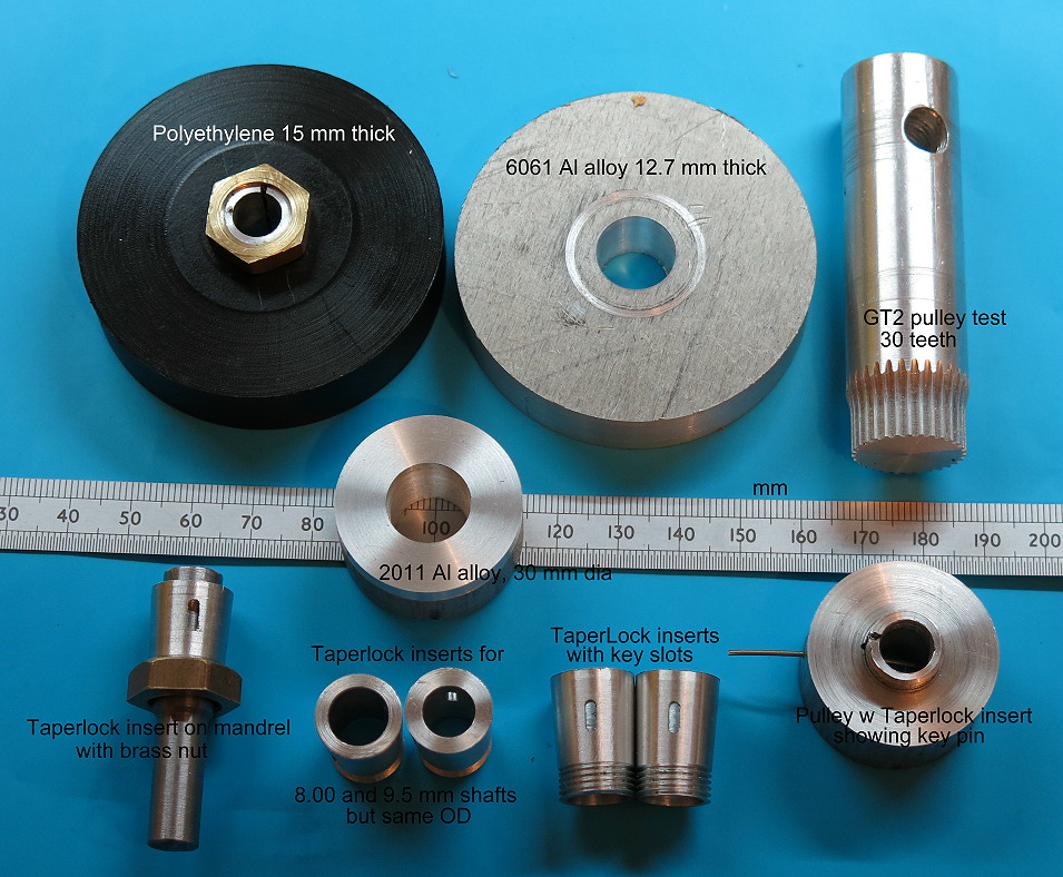

Photo as promised below. From top downwards:
Two large pulley blanks, one in PE and one in 6061. I KNOW the PE is not as strong as the 6061, but the diameter is 3x that of the smaller 6061 pulley, and I know the teeth on that size are strong enough. I know that nylon, in quite thin sections, is often used for toothed belt pulleys. So - an experiment. I suspect the teeth on the PE pulley will turn out excellent.
The PE blank has a taperlock unit in it, with brass nut. The big Q is whether the taperlock will hold against the PE, or whether it might slip. I don't know yet. I don't think cracking is a worry with industrial PE this thick. If it does slip I can put an Al bush insert into the PE with flange screws: commercial nylon pulleys have Al bushes and the nylon is molded around the bush.
Test GT2 pulley, 30T. Just one of a number of GT2 pulleys I have made. The others are actually in use. My cutter (which I made) may deviate from the official GT2 profile by a micron or two, but should I worry about a few microns when the belt face is fabric?
2011 Al alloy pulley in middle. There will be a 3:1 ratio between the big and small pulleys when they are finished. Yes, the bore in these blanks is tapered already: 3 degrees half angle.
TL insert on mandrel. It has 8.00 and 9.50 mm ends.
Taperlock inserts for 8.0 and 9.5 mm shafts: you can see the slightly different wall thicknesses.
TL inserts showing anti-rotation key slots used only when tightening the fitting
Pulley showing pin going through plulley into TL insert. (In this unit the key slot overlays the split, which has been hacked around a bit during experiments.)
Still to do: turn the ODs of the blanks down to correct values; cut GT2 teeth onto blanks; make up side flanges and fit to pulleys; fit and test.

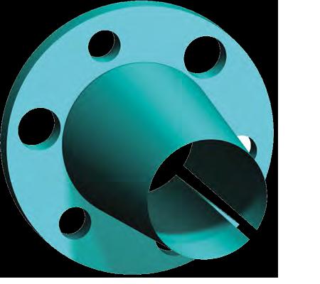

Not wanting to blow my own horn but I published an article on how to make taper lock bushings in issue # 11 of Model Engine Builder magazine. This type of mount for flywheels is frequently used (and made) by Model Engineers.
Tapers are always a bit tricky to cut because not only do the tapers, male and female, have to match, they must be cut directly on center or they will not have straight sides.
If you can find suitable locks, great. If not, contact me off the forum.
Mike

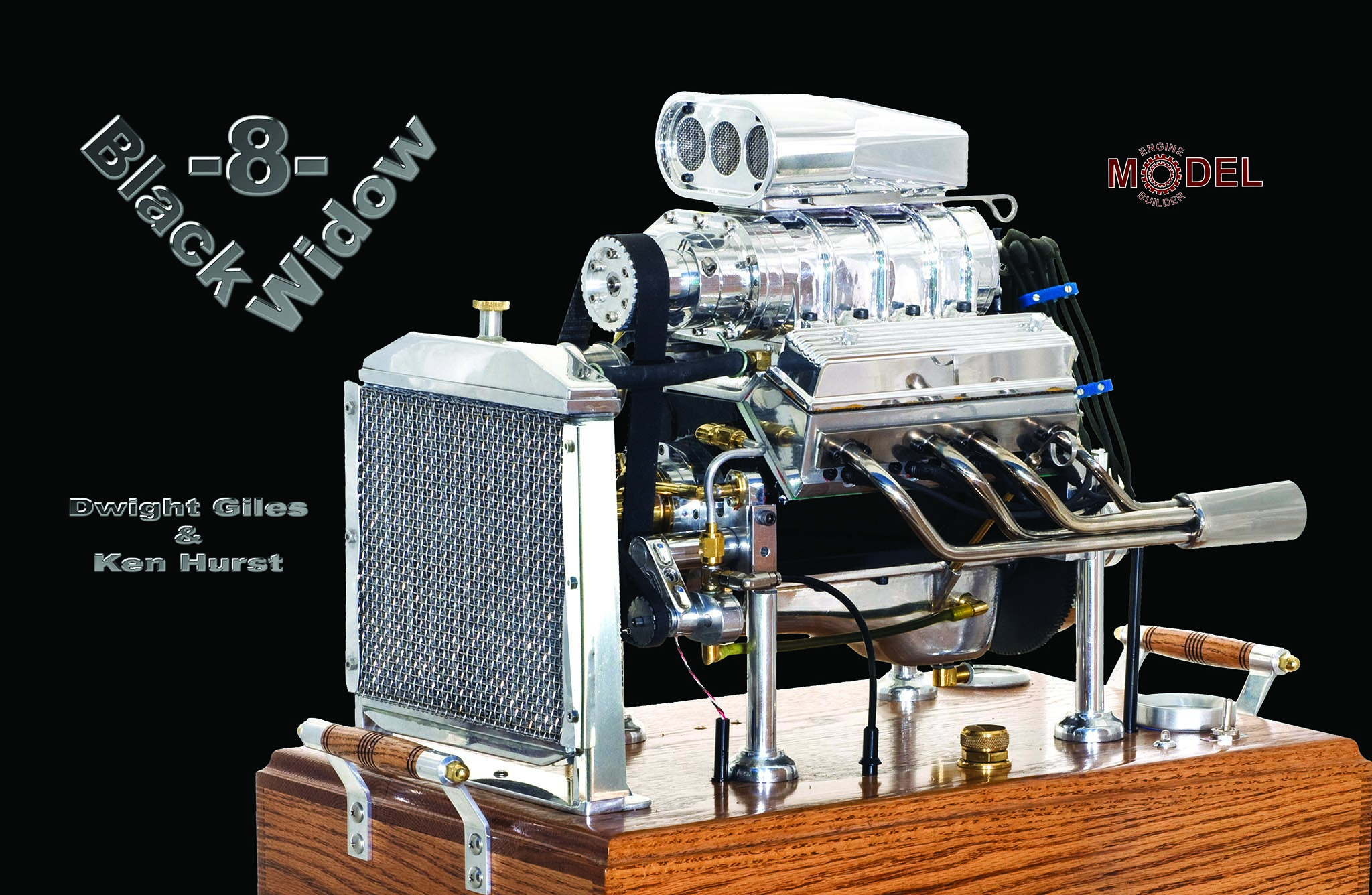

This approximately 10 HP supercharged V-8 model uses a taper lock on the flywheel if I remember correctly. THe engine is about 1 foot long, front to back.

In the end, I found that a 2011 aluminium taper inside a 2011 or 6061 aluminium pulley on a steel shaft did not need a key of any sort. Once the taper has been done up tightly, you need a hammer to break it loose. All very successful.
I will have to make a good gear-puller to get them back off the shafts ...
