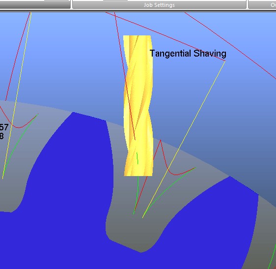

Tangential Shaving Doesn't work
Re: Tangential Shaving Doesn't work
The simulation seems to be matching the final result on the 4th axis.
I can see the simulation being wrong. The tool cuts through the teeth in simulation or doesn't touch the teeth if too small in diameter.
Check carefully the tool setting itself, it can be something like Taper being selected, or some setting that isnt very intuitive...

I checked the tool setting as it was the first thing I suspected.

Still doesn't work for me here. If a smaller diameter tool is selected it doesn't touch the tooth. If a larger tool selected it cuts through the tooth. See attached screenshots please.
Hi Dan:
Must be some setting Im not seeing. Can you zip up your tools.dat file
and the project file of the gear your attempting to cut and post it here?
Having your tools.dat file will show me all the settings you have for
the tools. Ill try to recreate what your settings are. Generally, if clearance
is set to zero, your tool should just kiss the edge of the profile on each pass..
The clearance setting it was. Apparently was not understanding its purpose.
