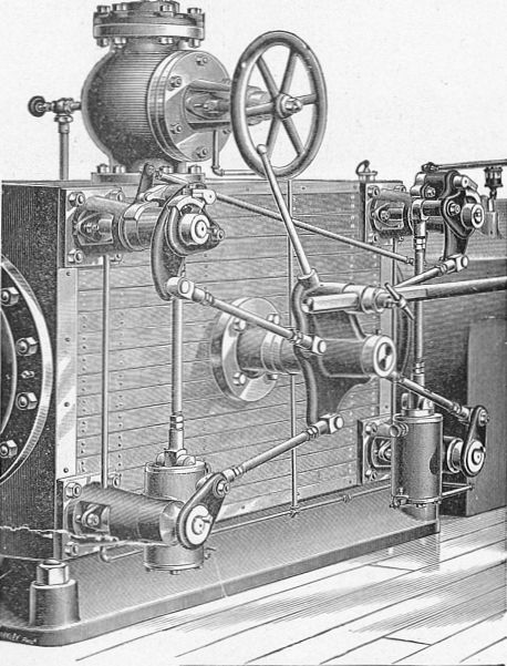

Sounds like you want to reinvent the Corliss steam engine.
