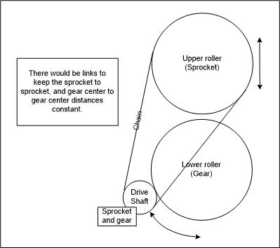

The drive shaft with the crank handle, a pinion gear, and a small sprocket, would go CW.
The top roller with the chain drive would go CW.
The bottom roller with the gear drive would go CCW.
Because the rollers each are driven by the drive shaft, they can be swung toward and away from each other, pivoting around the drive shaft.
Involute vs cycloid. Involutes tolerate a little CtoC slop.

you lost me :) a photo of a hand drawing would help a lot!

The drive shaft has a gear and a sprocket and is rotating clockwise.
The upper roller has a sprocket and is rotating clockwise.
The lower roller has a gear and is rotating counter-clockwise.
The two rollers are rotating oppositely.
The chain and gear are always at optimal CtoC distance.

Its a solution that complicates the build I think, the pendulum like movement of the small gear will make the build and hand cranking more difficult. I will stick with two gears and lousy engagement, in my last simulation I used module 5 and the engagement was reasonable.
In any case, thanks for the time you took to explain it.
