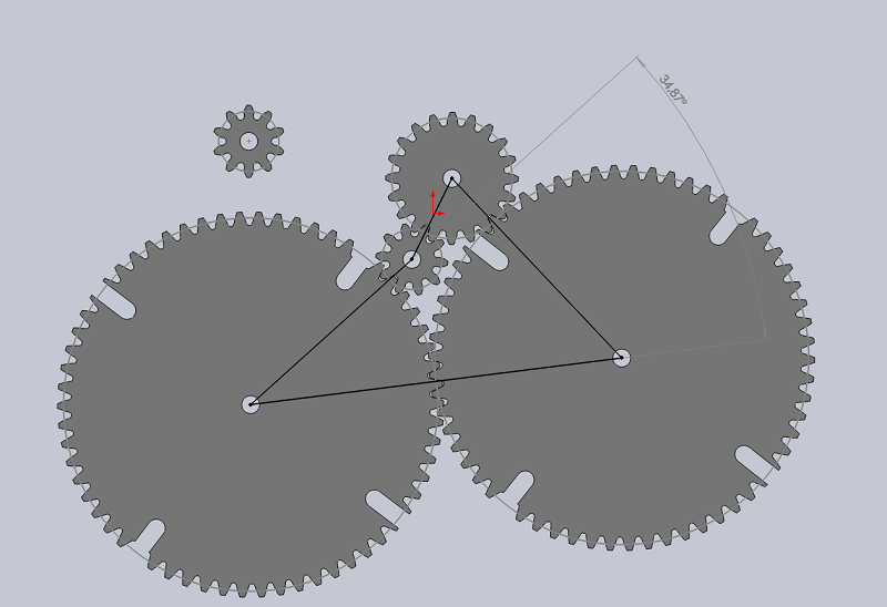

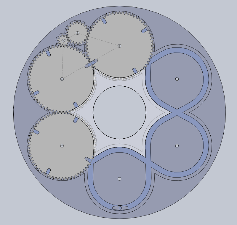

I'm trying to made braider which can be 3D printed.
It's basically finished, with one small problem. I drive large gears with one smaller gear, but becuase large gears have 4 slots, I added one more smaller gear, which intention is that help bigger one through the gap.
Now the problem.
How should I define angles inside trapezoid, which connect centers of gears, that all gears meshes? I tried to use gearotics, but I can't mesh one gear with two other gears, or I can't find that feature.
Gears have 10, 20 and 62 tooth. I may mention that I am hobbyists and I'm not machinist by profession.
4 meshed gears
4 meshed gears

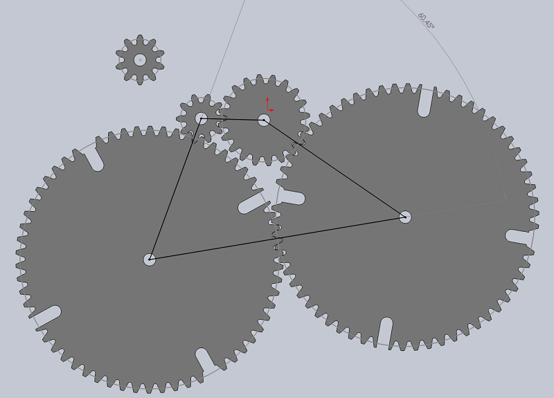

Re: 4 meshed gears
I don't think that is that simple.
Maybe trapezoid wasn't right word to choose. In some cases you can get quite close to it, but it can be quite different. Like in attached pictures.
That problem have more solutions, two extremes are on pictures koti2 & 3. I determined it by hand (eyes). :) It is slow and human error prone process.
So, with G2 one cann't mesh gears in the "circle". I tried to make two small gears, one to mesh with 62 and other with 20 and then move shaft to shaft, but that did funny things to gears (change their module and size).

Re: 4 meshed gears
This can be solved with simultaneous trigonometric equations.
Gearotic won't calculate the shape of the quadrilateral for you, but you can calculate it. I'm sure there is free software out there that will solve it for you.
I'm not sure what you are wanting. To get actual numbers, you need to add one more constraint, such as the quadrilateral being a trapezoid, or the base angles being equal, or something. Otherwise, there will be an unconstrained variable and the quadrilateral will "rock". What constraint would you like?
As long as your side lengths are determined by the radii of your gears, meshing will work.
