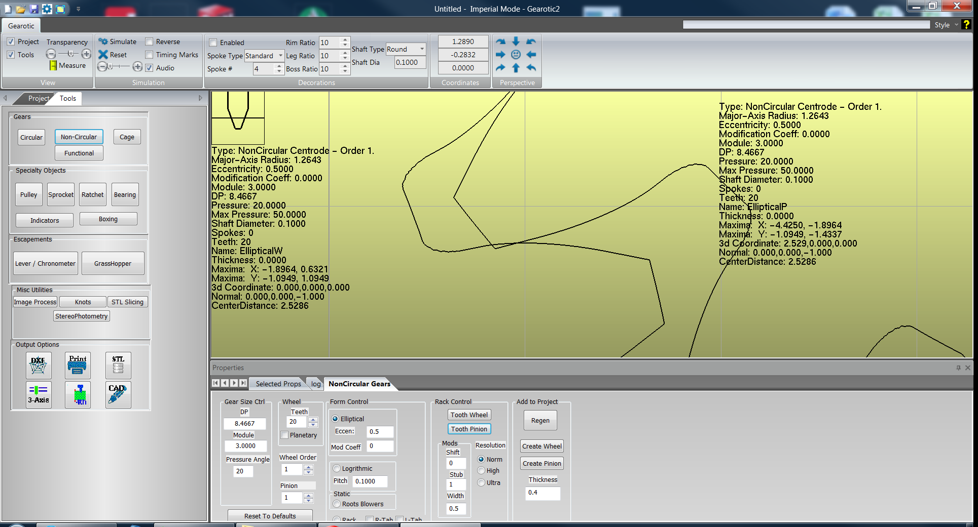

I do it fine right now but I saw some interference, first in solid works but later in Gearotic 2 too, in every non-circular gear, attached a screen shot with default settings non-circular gears.
Re: Solid works - segmented sketch
Yes, non-circulars are toothed by virtual hob, and I have default set to 50% tooth width for tigth fit, I recommend
lowering to the .47 or so for most uses. Youll see that allows a bit of backlash and stops the interferance. NonCirculars have
that kind of responce at times due to the way the pressure line varies..
Width smaller than 0.5 give me more interference, greater than 0.5 no interference. I will use aluminum and a EDM (0.02 mm precision)machine do you have a extra advice ?
I think your there. Sorry, you are correct, the width of the hole is being set as the control actually
controls the shaper, not the gear when doing non circulars. I think you should be good, if no interferance is seen, I expect
youll get a fine gear. Drop us a photo, I love the look of EDM gears. :)
