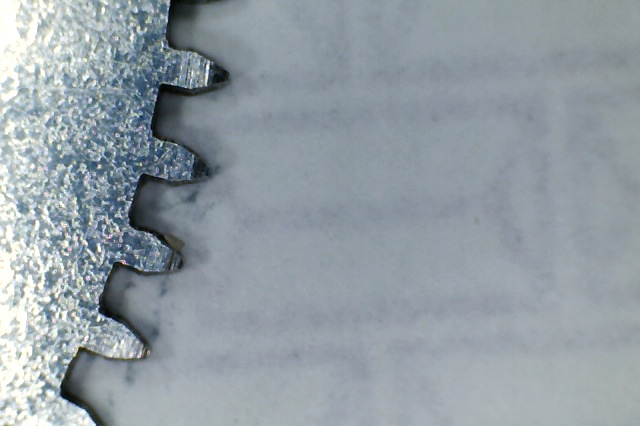

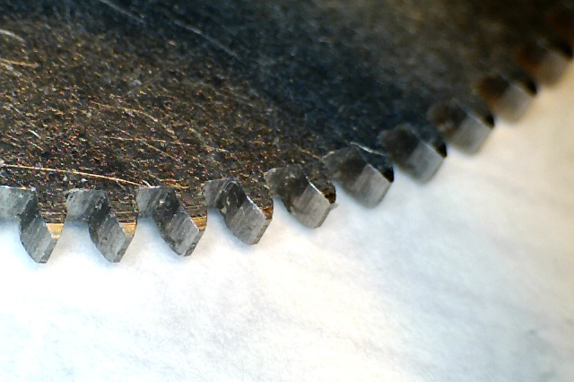

Had a couple of hours, so started by finding a newish 0.016" saw, a better mandrel and some supporting discs (leaving about 0.2" teeth exposed)
I am still using the over long and unsupported mandrel for the blank, the blanks are the cheap hardware washers.
The teeth (72) are 0.6 module, at the base circle tooth width is 0.0325" and the tooth space is 0.037" which given the difficulty measuring is very close to the theoretical 0.0708".
Is the tooth space a little wide? The quality is just superb (IMHO) ;)
Many thanks for your great software and support
David

Re: Tangential Saw shaving 4th axis
David:
Nice work!..
Probably fine for clock wheels, but the space is a bit large, Im thinking it would require a bit thinner saw to make it thin
enough. The program is very good at accuracy, but a bit forgiving as to the diam being too large, it will cut anyway and
make the space too wide. Im thinking this is why the spaces look a bit wide.. but I'll have to check the math.. It may just be
the rooting is too wide.. seems I meant to check somethign there..

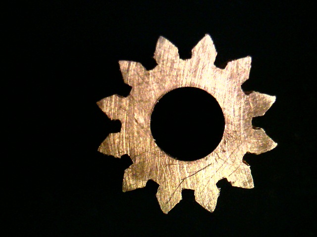

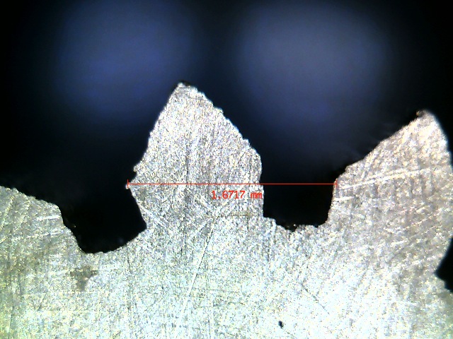

Had a few days break from gears, drew up some clock plates and machined them on the CNC mill, at least I can see them without an eye glass or microscope.
Back to gears, and tried a 0.55mod 12 tooth 0.125" bore gear in brass still, until you are able to look at the saw retract issue.
Very pleased how it turned out (pics attached) pitch circle at 1.171mm ( 0.066"0 very close to the standard 0.070") given the linear measurement rather than on the arc.
The space is 0.65mm (0.0256") and the tooth 1.041mm (0.041")
Question do you think this is now about right, both in visual appearance and measurement?
David:
The rooting looks pretty good, though the involutes look somewhat pointy.. but when you get
real small things get so critical that those really dont look too bad. I guess the test is if they run..
