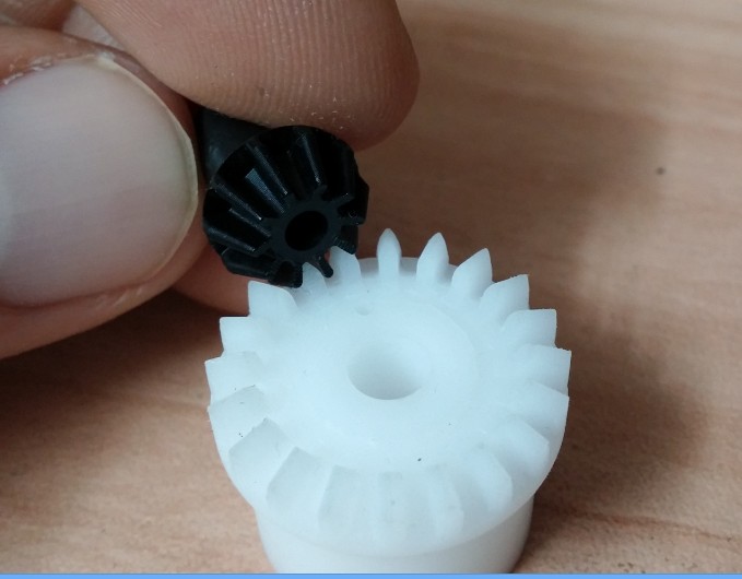

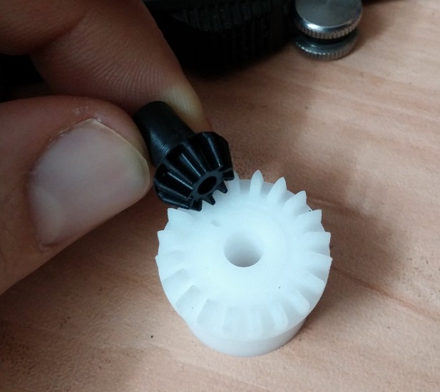

Cut a couple of gears. Used epicycloidal tooth profile, as didn't have an end mill small enough to make the desired gears. They are 20 teeth and 10 teeth module 1. Cut with a 1mm end mill. They mesh, but looks like they have an awful lot of backlash (which the simulation confirms). However, will have to actually mount them to get the real feel of it.

Seems they worked out well enough to work, but the teeth seem thin. If sim looks the same Id check the tooth width
isnt set too small. Othewise ID think the tool was ever so slightly too large...

Simulation looks exactly the same. Changing the tooth width doesn't appear to affect this gear type. I could probably fool the CAM software by defining a larger tool diameter than actual to get thicker teeth.
Any idea how to figure the mounting distance of bevels?
Re: Bevel gear stock data
Strange.. are they epicyclic tooth profiles by chance? I kinda wondered on first look. ..
Epi's are designed to be loose.. its part of their appeal...
Mount distance can be seen as the pitch circle radius from center of opposing gear.

Yep, they are. I said that in the original post ;)ArtF wrote: Strange.. are they epicyclic tooth profiles by chance?

Sorry, I missed that point. Epi's are pretty loose by design. (Ill wait for your new topic. lol )

How is the pitch circle defined for bevels? The on-screen info says "Center Distance (from outside pitch line): 20" - what does it mean?ArtF wrote: Mount distance can be seen as the pitch circle radius from center of opposing gear.

It means the rear point of the gear where the two bevels touch one another to the center..
_____|
from the bottom right to center of the above glyph would be the outside radius
of the bottom bevel. ....
