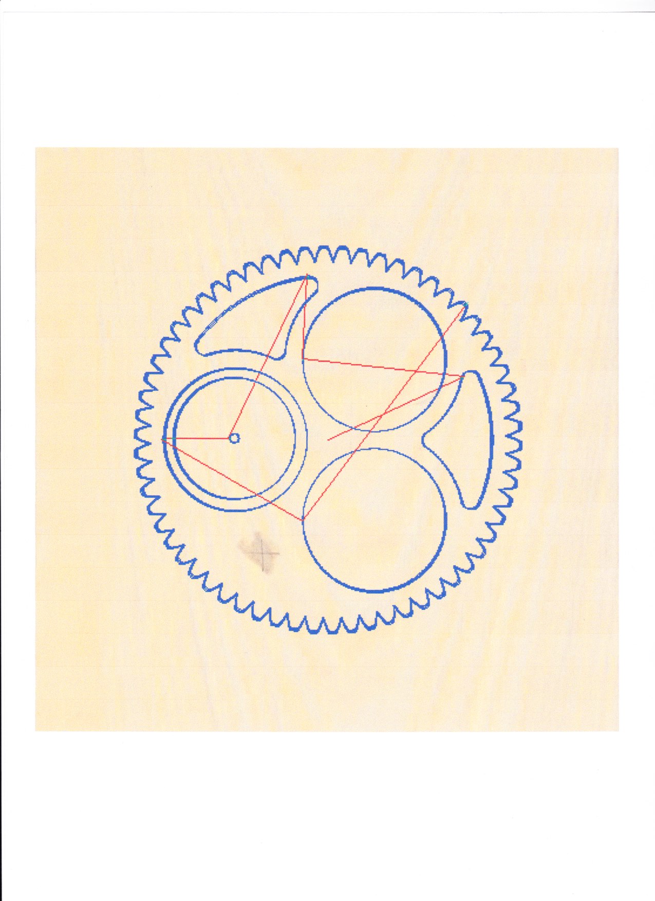

Mark thanks for the advise I was playing around in vectric and did what you are saying. but had a problem I started with center gear closed vectors, did toolpath and when I run simulation it only cuts everything but one of the pockets any ideas what I can do thanks Don
- Scan_20160509.jpg (265.33 KiB) Viewed 4959 times

I'll answer your last two questions. Send your Vectric .crv file to my e-mail address and I'll take a look at your toolpath. It looks to me like you didn't select the last cutout when you defined the toolpath. As for the two second pendulum, a pendulum's period is a function of it's length. In Gearotic under Indicators, there is a button called Pendulum Calc. You can enter the period you want, in your case 2 seconds, and it will tell you how long to make the pendulum from the pivot point to the center of mass of the bob. Entering 2, returns a result of 39.112 inches, simple as that! Remember this is a theoretical number assuming that the rod has no mass and that there is no friction. Best thing to do is add 5 inches including a 2 or 3 inch adjustment screw and you should be able to dial it in.
Mark
