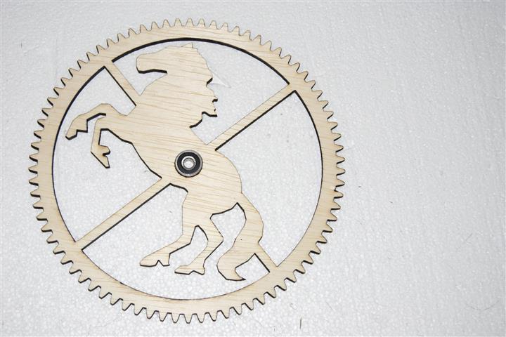

Well I really went off the deep end. I went to a web site that had line art pictures of various items. I thought a stallion would look great in place of spokes. I saved the image to the pc and then using a great raster to vector program called Vextractor converted the file to a vector. Then in Bobcad I scaled the image to fit onto one of the gears I designed in GM and then laser cut it.

Looks pretty good. :)
