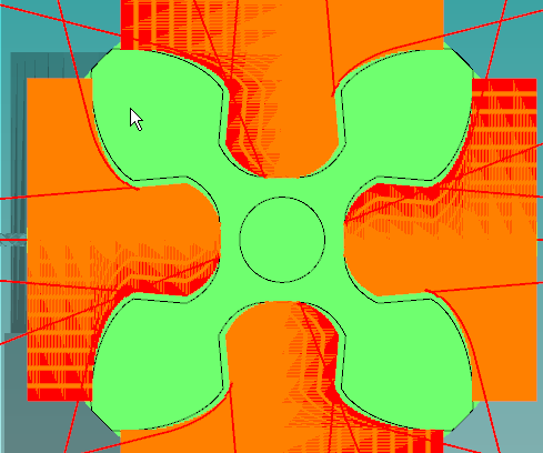

To illustrate, look at the rooting ( on very fine passes ) on this version of your worm ( as a spur). You can see the rooting doesnt touch
the profile ( thought its very very close.). Any zero shift will gouge. In fact on reviewing all this Ive decided its way too close and will be changing it
by the time you get back to be far less close on roughing. That in itself may solve the issue, but I just wanted to show how the spur may better visualise whatever is going on.

The z zero was within + or minus .03mm.

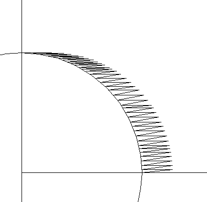

I notice in your spur gear screenshot that the line of the cut profile doesn't follow the line of the tooth profile but gradually converges on it, also it does still leave a small anomaly at the tip of the tooth, and both of these points are in common with the issues seen on the helical. Have you run that spur with a larger tool and coarse feed? Unfortunately I can't load gearotic to my employers' PC.
No, unfortunatley I'm not setup at the moment to run such a test so Im working solely with numbers. But lets discuss that photo and its convergance. The toolpath shown is exagerated of course as its very small step down, but in roughing there is no rotation. So lets just look at that spur gear. With no rotation the path above should generate a tooth shape just barely away from the profile at the top, but a bit further away at the bottom. The photo uses the actual numbers for position so in theory the shape above shows a very tight root for a tooth that will not rotate during the cut.
I did this for a reason, in early GM I had many people tell me I left too much on the flanks during the root, it caused the bit to be stressed
(Primarily of course with small bits) during the tangental run.
>>Step 1: use an end mill to rough slot to maximum depth and width, cut per step user defined (leaving material for a finishing cut - user defined). It would need to auto do some widening if the useable flute length is not sufficien t for the full depth.
This is basically what is being done. Look at the photo, this starts at the top, and works its way down clearing each depth from side to side until
it misses the profile by the setting of 10% of the bit diameter plus a clearance factor. THEN, two passes are made, they are made with rotation, first the straight wall flank of the root is rotated to be straight up and down and a pass is made ( with side offset ) so the bit side just cuts that wall.
The photo doesnt show the tangental path, but in the tangental passes the flute is placed so it just rubs the profile edge, thus making a clean line up the involute.
Now, your cuts shows something bad happening with the root cuts only, and it seemed to show the root was cutting too wide. So again, lets look to the
roughing pass in the photo, how could it cut wide and into the tooth? I see only 1 way, if the toolpath is moved downwards we get exactly as you got in
cutting. And I do mean exactly. Its what the numbers show. Now, does that mean you were off zero? No!, it could mean IM off zero. Im crunching the numbers
to see where I can be off, but logically, if the path shows proper, but the cut isnt, there must be an offset somewhere..the path , so long as the display
doesnt show a cutoff must be correct, but perhaps the output code isnt. Im still looking but cant find it yet.

Art, is the fact that even for you spur screenshot the cutter does not correctly follow the involute profile but converges on it not an indicator of a systematic error in the gcode at least.

Looks like it ...but not really. Consider if the bit is down in the root. With a 1mm bit the toolpath must remain .5mm
from the side. Else it gouges. Now consider each point up the involute slope. For the outside tip of the bit to miss
gouging the edge, it can come closer and closer to the profile to maintain a .5mm distance on the flat plane of
the bottom of the bit to the sloping involute profile. Measure at any point from the toolpath sideways to the
profile and it is .5mm. It just LOOKS like its getting closer..but again, it IS critical and only happens with
very few teeth because normally the outside tip of a tooth is never on such a 90 degree tangent to the tool..
Hmm, hard to explain in words. Draw a circle. Starting at the top , draw a .25" line from the circle out .25" and put a dot. Move down 1/8" and repeat till you get 1/2 way down. Actually, thats easy to draw so here it is in the attachment. Its an illusion that the squiggly line is getting closer to the circle on the X plane. All the squigglies are the same distance out on that plane, and its the only plane that matters. The same effect is in the toolpath, only worse because the involute shape is going onto a flat plane ..faster...its as if your zooming into the very top of this illusion below. Now it is possible thats where the numbers are bad..Ill check that to be sure, the trouble with tangents is that they approach infinity as they approach 90 degrees. Again, 4 teeth puts us very close to 90 degrees..good chance thats where the error is..
Hmm, you know, Pulling up the bit zero to .1 or .2mm may be all it takes to fix it anyway, as the tangents shaving would still work the same and all thats affected is the rooting angles..which are so critical that a .1mm upwards motion of the rooting bit is amplified greatly in effect at those angles..Ill give it some thought..

grows larger as you raise it? And the effect is equal on both flanks.
No, I was speaking offcenter as in raising the bit. As you raise the bit the offset to the profile gets larger only on the
tight portions created by having too few teeth. What you describe for an offset is exact what it does now, the crux of the issue is that the offset works fine except in your case where the profile lies flat on the X plane..only happens on less than 8 teeth or so..
Again, look at the sample toolpath, image it up just a small amount, see how the distance from the profile

Hi Art, I'm not sure what's going on when rooting. With a step of 0.5 things look as expected. If I have a step of 0.25mm it steps correctly to a depth of 2.0mm then it jumps to the full depth of 5.625mm?
Re: 45 degree worm M2.5
Success, very well done Art.
