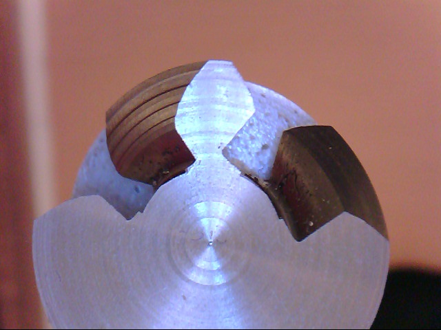

Regarding the tool marks on the tooth flanks. I checked for lost motion on my machine and I have only 0.02mm on the y axis and 0.003mm at a 10mm radius on the A axis. In any case looking at the code the y axis movements are all in one direction and the only cut where the end corner of the end mill is at the tangent point is the first cut. So the most probable cause of the tool marks may be left-overs from the rooting stage, although the number of marks doesn't seem to match the depth per step for the rooting. I may have to play with the rooting clearance some more. I'm not sure using the same tool clearance number as used at the end/beginning of each pass is a good long term solution.

Sorry Art but I don't think we are there yet. See attached photo: Left tooth space is set to 25% clearance and the right tooth space is set to 50%. The tooth profile includes the toothing cut in both cases. I'm not sure I still have the file but I think yesterdays run must have been set at 10% clearance.
Also the tool marks are from the toothing cut not left over from the rooting cut. I managed to get close enough to see what was happening. Z may stay constant but because of the blank rotation the tool tip effectively rises up the tooth flank for each rotation step. If the tool flank shaved at the tangent point rather than the tool tip at the tangent point then the tool marks would be avoided. Probably much easier said than done. Possibly all that is needed is to subtract a small % of the tool diameter form the z height. for each toothing pass.

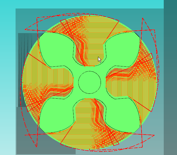

New version is now online. Heres a phot of how my test 4 tooth output looks. All numbers crunch well,
Ive blocked clearance from being able to push back beyond center, so the flank erasing shouldnt happen anymore,
(Im hoping that was it as I cant find any other excuse for why clearance increasing erased your flanks.)
Youll notice now the rooting doesnt try to cut outside the blank at all, the tangential passes no longer move the Z
at all, Z stays at the calculated base circle value. Im going to make that the true base radius for involutes, but since sprockets, pulleys and other types dont have base circles, Im hoping the AI works in that regard.But I dont mind doing code that recognises Involute gears for special handling..
