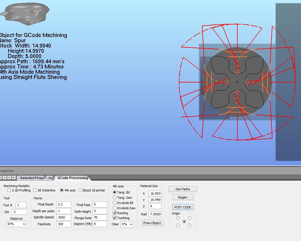

Phil:
Set your final depth as a positive number.. In 4th it translates to "final Thickness" and a negative number had an unknown effect.. (Ill fix that..).

Then I'm confused. What has final depth got to do with the blank thickness, final depth should be fixed at the distance the root is below the top of the blank (the z = 0 point). Why does the CNC processing redefine the blank thickness This is confusion total confusion!!!!!!

Of course, I had assumed that total depth related to the cut depth in 2.5D and had nothing to do with the 4th axis. It's difficult for the user to guess that you also use total depth in 4th axis to vary the gear thickness to avoid having to go back to the design stage. Seems to violate the whole principle of what you design is what you get. Total confusion for the user comes from throwing all parameters in one box then later using a parameter for another total unrelated, none intuitively function. Clearance seems to be another example. This is all very frustrating.
I've been using negative DOC since the start but I don't recall ever see a blank that was wider than the cut or have gcode that had an x move less than the blank width ( I would remember that) until today. I see that the my same helical input today doesn't generate the same gcode as yesterday with respect to the x axis travel?

Hi Phil:
The paths HAVE changed for sure over the course of this. When I have my fingers in there I tend to change things I see that arent right.
The negative DOC wouldnt have affected you till I fixed it yesterday. Till then only the spurs were affected by DOC. SO it likely didnt affect
anything you did up till now anyway.
The X axis travel should have stayed the same... at least if the DOC is set to the same width you had set for the helical yesterday.
The DOC should fill in with the designed thickness when you select the gear, its only an override if one wishes. ( Kinda handy to have though..)
Ill run a few more checks. It wont be long before the tabs get separated and Ill rename variables them to stop any confusion and allow settings for
some of the stepping values. Once it has its own tab the 4th wont have to share variables with the 2.5D

I was speaking of the rooting. Raising the rooting would have had the effect of stopping it from
touching the tooth profile. But yes, I did also lower the tangent point. Or to bne more specific , I stopped it from calculating the tangent height each pass, and locked it to the base circle height.
Really, other than stopping the rooting from going outside the balnk I did nothing else, yet
you went from a fairly good cut to a very very bad one. Im still analysing, but Im still confused.
Take that last spur cut, its asymetrical..that should be impossible unless the Y wasnt zeroed dead straight up form the center. I havent suggested that because I doubt you did that. So Im still plotting
the toolpath to see where it hits..so far, it doesnt, but the plotting isnt automated so it takes me awhile, Ill find it yet..

Im away most of today, but I have uploaded a new version. It relabels the depth and thickness overrides, and when you press the GetFromObject button you go back to the actual design thickness
and such of the gear. There is a new checkbox that turns off the cleanup section of the rooting,
this may have caused trouble with any undercuts.
I still cannot find what is causing the variations, but it is warming fast here so it wont be long. So far each tool simulation I do shows no collision, but I have decided after all this to make a simulation
on screen so I can watch the damn thing cut in real time.. :)

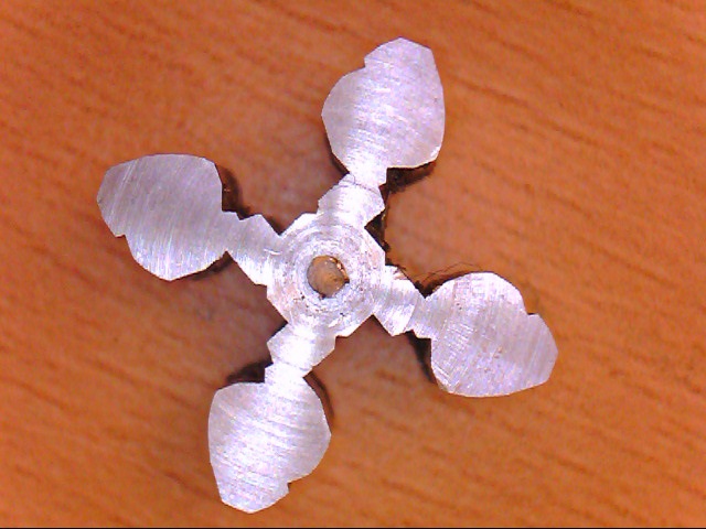

The spur was very small, 15mm OD, and I used the largest possible end mill 3mm, as this was the size I used for the helicals (for comparison). Maybe the cutter size and the relatively small number of root passes is the cause of the ugly spur?

Art. having a square ended tool dancing around in a confined space trying to produce what should be a convex profile was always going to be tough ask. Surely a bullnose cutter would stand a much better chance and at the same time be able to do the tan shaving and have the potential to minimise tool markers. Basically this is effectively 3D milling, which is bullnose territory.
