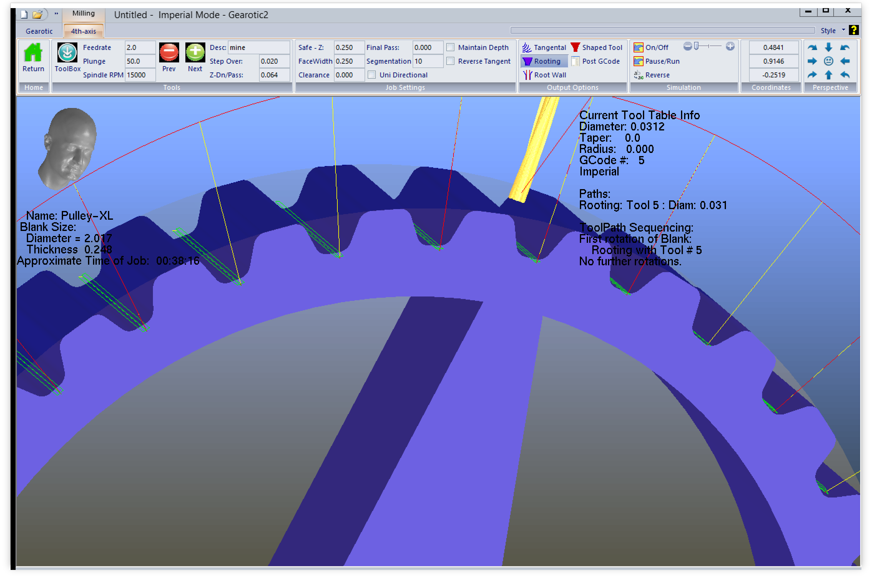

Okay, I confirm they are moves outside the part/pulley.
I'm not sure I see the wall being cut, even at the slowest speed it is hard to see. I have tangential and rooting turned on.
I see it cut to the root, but then it looks like it goes to cutting/shaving the tiny radius at the upper edge.
If I turn on root wall it makes a straight up and down cut, no angle.
It would help if there were a step by step animation, or a slower visualization.

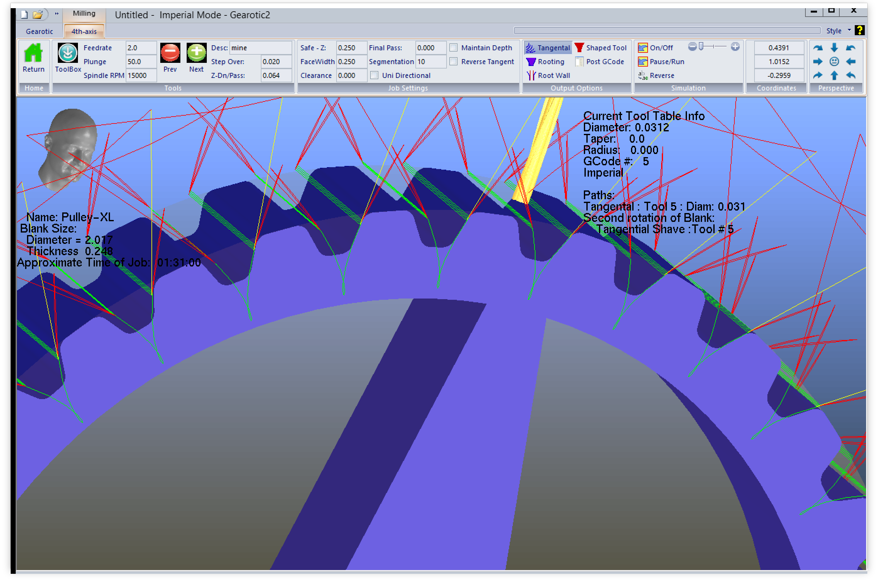

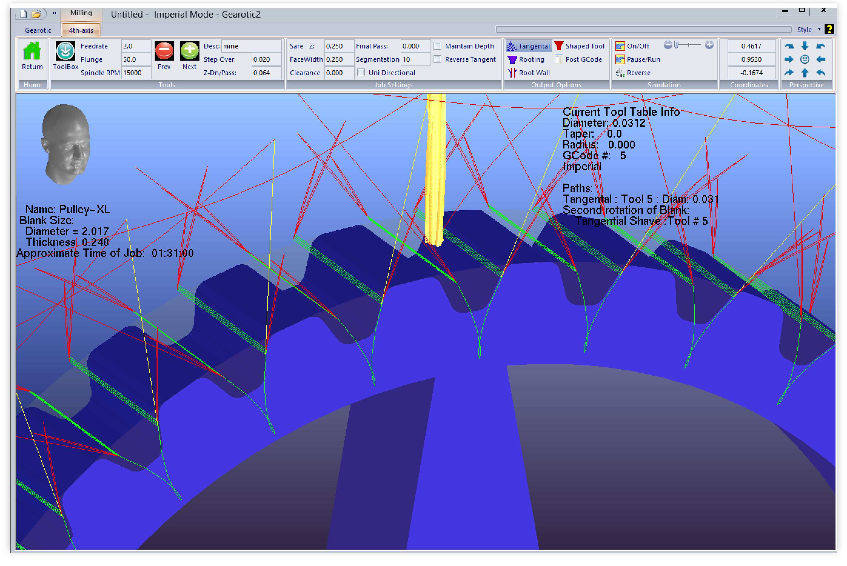

That's not correct Art. I am watching it with the slider all the way down.
Anyway, with the sim zoomed in so it just envelops the action, and tilted for the best observation I have watched what is happening; watched it for quite a while, and I don't see the walls of the pulley being cut.
During "tangential" the tool only shaves the small radius, goes down outside the pulley and loops over to the opposite radius to shave that.
During "rooting" the tool only goes straight down, no movement of the 4th axis except to move to the next tooth.
What am I missing?
What am I missing?

Here's another shot with the color changed slightly. Only the bright green are cuts.
Re: XL pulley 4 axis cutting
Ozzie:
Doesnt sound liek your missing anything. The root wall routine rotates the blank so the root wall thats straight is cut in a single pass, the tangental wont try to cut anything that isnt curved, curves are the only thing tangental can really do. As the root wall is a straight line vector, the program puts a single line pass on it to straighten it, then applies the tangental only to the radius at the top. Unlike normal spurs, the side walls of that
timing pulley have no real curvature. The bottom radius cannot be cut by either so
the rooting section does the best it can there.
So in your case it sounds like the rootiing isnt doing what it should, but it may be trying to do it in one pass, in which case the smallest radius at the bottom is all thats cut. If it is rooting in passes, each higher pass can typically cut a bit wider. Change your depth per pass and see if the rooting ( not the root wall) cuts wider on each pass..
