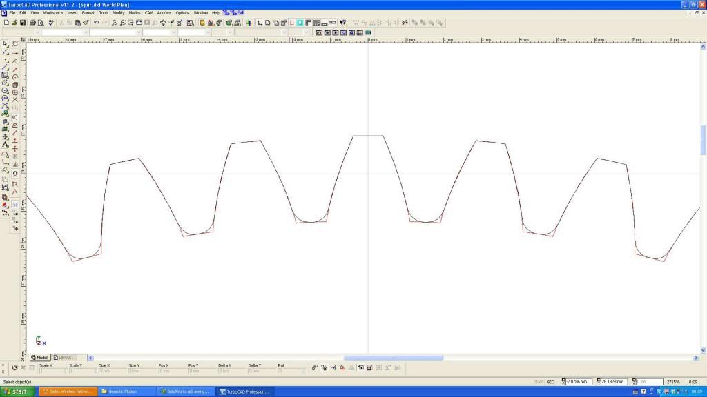

Hi Phil:
I just double checked that combination to make sure youd be OK.. I suspect you will be though
you'll get a bit of a trochoid on the root with a 1mm tool. Im going to do have to redo that math on the
max tool diam though as Im pretty sure its wrong. Looks to me by measurement that a .8 is the correct
size for a mod 1 tooth.. Ill do a check on Monday and likely issue a fix. (I think 1 1mm will work, but the root
area will be larger than onscreen..I have to consider why its wrong..)

GM gives max tool diameter as 0.8398mm, so maybe the GM math is correct?

Re: GT and GM numbers not the same
Phil:
No question, GM is more correct. GT tries to generalize so it can be used with all types..pulleys, sprockets..etc..
Doesnt work very well for Evolutes though, SO Ill probably swap it to GM's old code just for spur gears..
