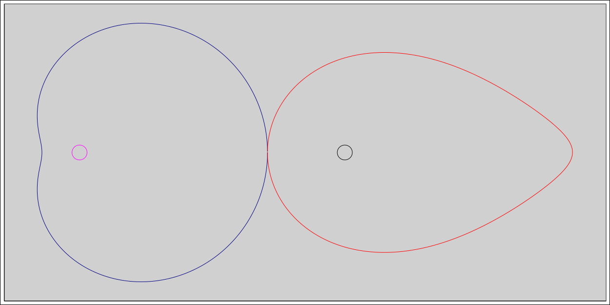

Yeah, the numeric profile generator seems much simpler than the analysis.  The cardioid is 1.5+cos(theta), the egg shape is generated to match it.  I haven't done pressure angle calculations yet.  Are there any other easy checks I can do before making the gears to test them?
Re: Non-Circular Gear Theory
HI Nate:
  On gears such as you have pictured, the issue often isnt the pressure angle. Its the toothing, depending on the teeth they can be hard to place
in concavities. I notice my functional generator works with  the formula theta = 1.5+cos(t) and provides the expected image only with a low number of 4 points..
(Ill investigate to see why I made such a limitation, I suspect the numbers are beiong clipped in a safety with that formula, however, even with 4
points it does show the sape you have and it reports 56 degrees max pressure angle.
Nate:
I was curious so I anaylysed why the functional doesnt generate that gear pair form that formula, Gearotic see's it
as degenerate, it runs under the radius of zero, so it limits the inflection to .2 , this makes it effectively a circular curve in the inflection
zone. But with only 4 points selected, it never see's the inflection, so you get a close approximation to the cos( theta) gear without the
inflected concavity.  The pressure angle min/max is approximate, but correct. About  56 degree's , That seems quite reasonable and if you make them
it shouldnt be an issue. (Ill have to consider if I should auto rescale such formulas to allow for the same sort of generation you show..)
  In gearotic of course, the scalar would have to be removed from the formula, the 1.5 additive term just shifts the curve to one side and the radius
is then clipped. Its that that I think perhaps I shoudl readjust my thinking on..

Maybe I'm not following, but you can't just remove fixed radius offset like that without changing the shape.  For example, that the pressure angle due to the roll line (i.e. the 'u' in the formula above) is atan((dr/dt)/r), and adding a fixed offset to the radius will always move that closer to zero.  Similarly if you remove the 1.5+ form that cardioid, you get r=cos(theta) which is degenerate as a gear shape in multiple ways.
Nate:
Your right of course, I spoke too quicky, you should get a .5 radius min to 2.5radius max in this case... I was thinking G2 was autoscaling it.. Ill dig in the code to see wht with more than 4 points it does what it does..
Nate:
  lol, you know , Summer breaks really hurt your head. I went back and looked and it became obvious. Your formula would indeed give
that shape,but in Gearotic the formula you enter is not used for the shape of the gear, its the first derivative of the formula that defines shape.
This makes the gear ratio implied by the formula to hold true. The formula is meant to specify
the ratio of the two gears. Its why t2 = t gives a circle, it implies the two gears run at a 1:1 relationship throughout 1 period.
  I wonder if perhaps an option to enter the shape by formula with the resultant ratios ( whatever they may be ) is worth adding at some point?
