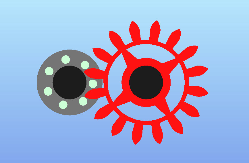

Im assuming you want as the attached photo shows?
To mate a cage with a epicycloidic pinion, you can first make a cage gear. Take note
of the MOD number used. ( or DP if your imperial).
Now make the normal hypocyclooid mate for it and place it on the screen meshed to the cage.
Now you can replace the hypocycloidic with a epicycloid by going to the circular gears tab,
now select epicycloidal as type. Select the same MOD ( or DP), and the same tooth count as the
mate to your cage. Add this to the project but put it on the shaft of the hypocycloidic.
They now sit in a proper spot to mesh, but dont because they arent linked. Delete the
hypocycloid gear leaving you with non meshed but proper centered two gears. Now use the
add link while selecting the cage gear and the epi shoudl show up to link to. Link them
and they will mesh and simulate as the enclosed photo. Takes a few minutes but its the only
way I know to get them work the way you describe.

Re: Gear epicycloidal + lantern
Hi Salvador:
The sample picture was from Gearotic2 , Im not sure why your getting the error and I didnt
but its possible that while you cant just place a round gear on a cage, you can place one
on the same shaft and delete the original, they should link. I do understand thats rougher
to do , and the diamter of the pins is an issue as to correct size, though usually so long
as their loose they should work fine. Epicycloidics are generally meant to run pretty loose.
I will take a look though to see if I can simply allow you to just grab an EPI and mesh it directly, I suspect I just need to turn off a safety. Ill see if I can allow some way to judge
the pins if you want exact match, though I think the max tool diam. stat shown on the epi
generation will be the right pin size for that gear.
