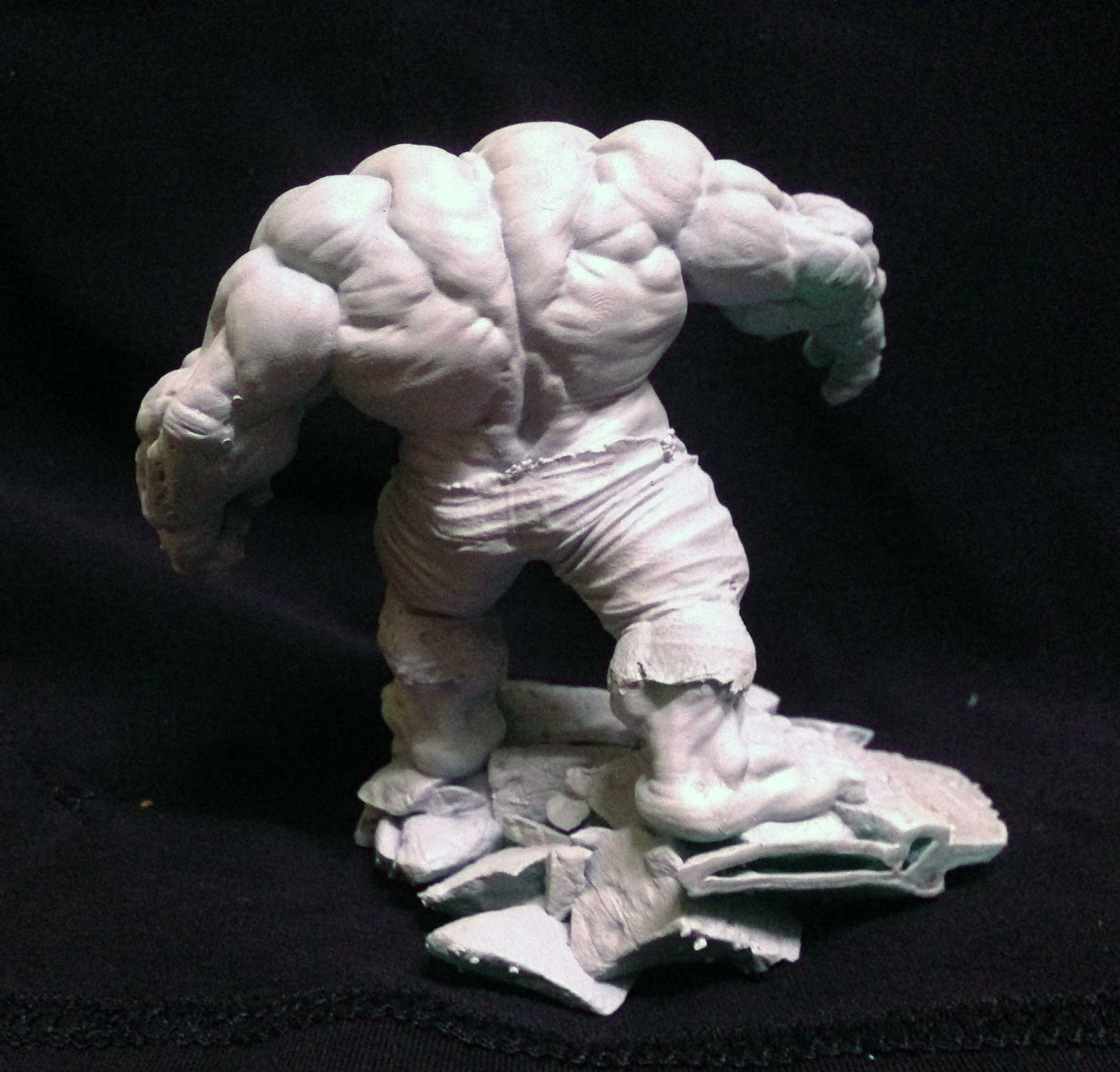

Hey G'day folks,
Reason I ask, I bought myself an AnyCubic Photon, inexpensive and well so far fantastic prints, so far printed all sorts of stuff, chess pieces and other high res Miniatures and the like for the grandkids.
Haven't gotten around to testing gears as yet so wondering if anyone else has?
Im looking forward to making some mechanical geared toys.
Cheers and avagreatday from the colonies downunder
attached just one of the things Ive made...
