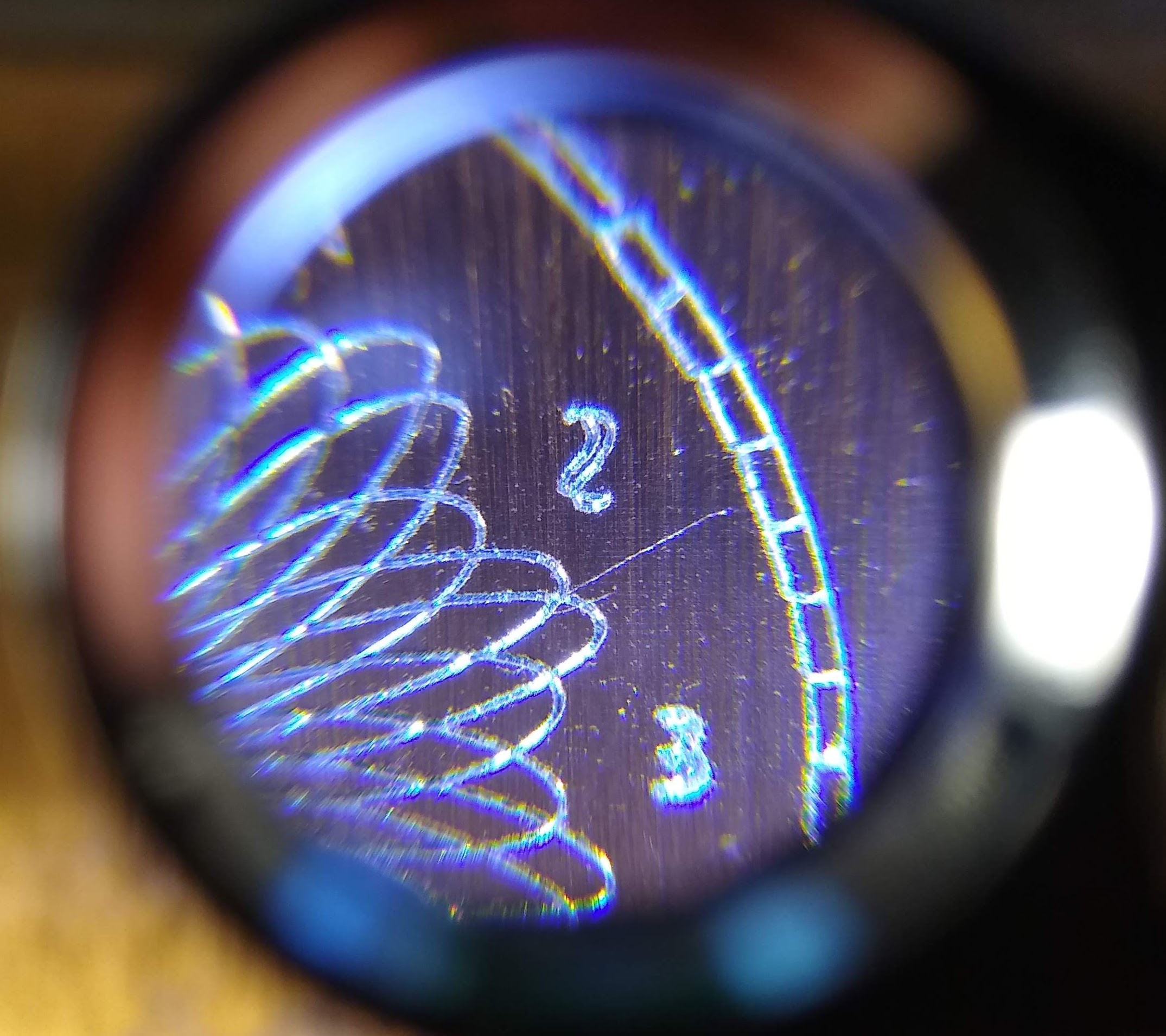

The 3x3 gear array crashed Carbide Create multiple times, maybe it was too many small vectors. So for fun here's today's project. I tried an online gcode optimizer on the second one, and while it reduced the rapid horizontal move total length it didn't change the engrave time noticeably. What it really needs is eliminating a number of unnecessary up and down movements by optimizing the cut paths. For example the dial circles could have been two cuts, not a series of ups and downs distracted by the tic marks. Oh, well, still took under 5 minutes although I've done some non-gearotic engraving that took well over an hour, a raster to vector converted pencil sketch that I worked on almost 10 years ago. Too many small artifacts that didn't get edited out.
There's a small gotcha in the "2" in the magnified picture, one side is an S that descends below the bottom line. These were un-snippable in Vexx. Not significant since it's the old editor.
This is clock dial from the Auggie wizard with a simple guilloche pattern overlaid on top, diamond dragged at 800mm/minute and with the spring compressed 5mm (half way), trying 2.5 was too shallow a cut. That 5mm, plus the 1mm safe height, consumes most of the cut time as it makes 200 trips up and down.

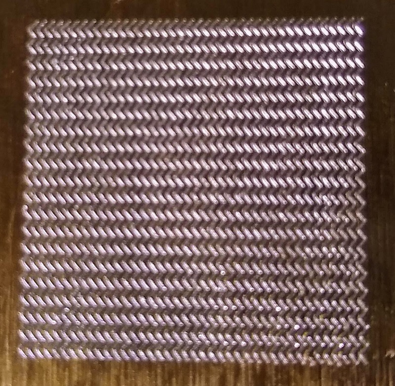

This may not look like much, but the svg file was generated with a 30 line program written in processing that creates a triangle straight line machine pattern bar and then steps it across the workpiece. The scaling is way off, one might say non-existent, no way to change parameters except recompiling, no phasing, masking, spacing changes, pattern bar changes, etc. Lots more to go but actually achieved a CNCable file! First code I've written in quite a while, first attempt at processing too. Not the easiest way, but it allows for other styles, or even customized, patterns. Who knows, might evolve into a straight line guilloche machine simulator.
25mm sq, 90 degree diamond drag on anodized aluminum, 800 mm/minute. Still haven't got the lighting thing, very sparkly in real life.
For grins here's the program, probably needs some comments :) :

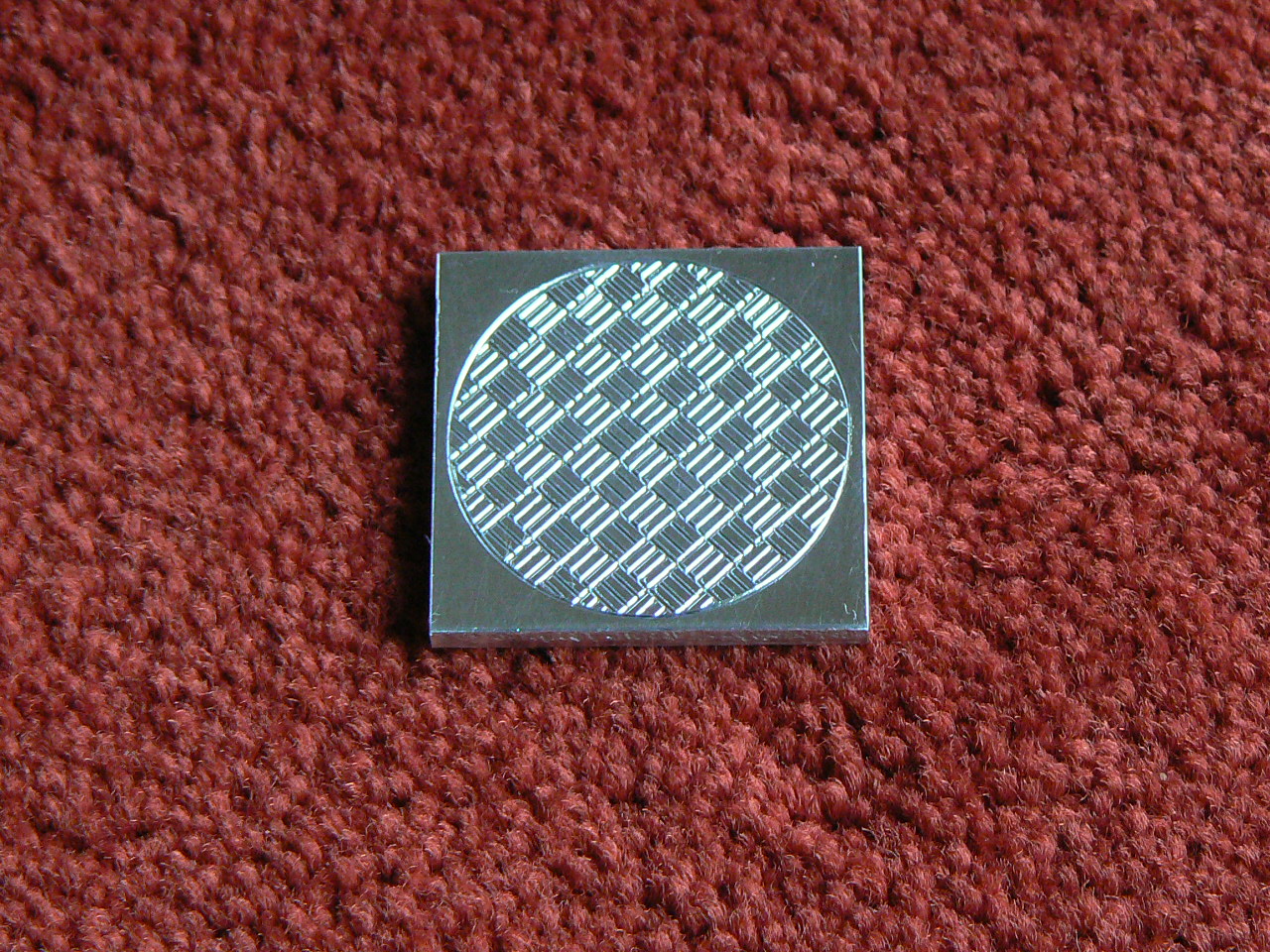

Here today some "straight-line engine turning...", with the mill.. ;).
The "basket weave"".
Small diamond engraver, aluminum (polished previously), diam. 30, depth ~ 0.05 mm, feed 75mm/min.

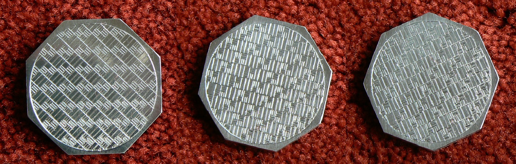

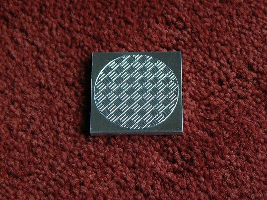

Inspired lately by the guilloch? messages from Mooslake (Kirk) I did a few other trials.
If I did saw well this week, Kirk posted a message in another subforum here, so I hope there is some form of recovery from the latest medical procedure.
In that case.... it's time for a few pictures.
First the "basket weave pattern", well known.
But in a video here above we saw that master engraver/horologist Joshua Shapiro, made a variant on the basket weave:
Some baskets .. are left empty in first instance, but later.. filled with an even smaller basket weave pattern.
So a basket weave within a basket weave.
Time for some amateuristic imitations....:-).
In the second photo the circle (about 30 mm) is only rotated a few times, to show in all three the same object, but only with that rotation
(to show different looking patterns, ONLY due to the position of the light).
Hessel
Hessel
