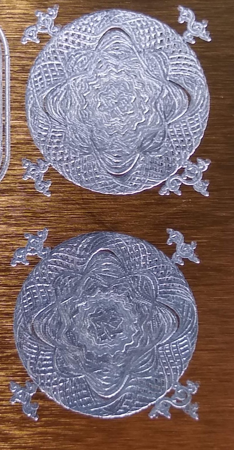

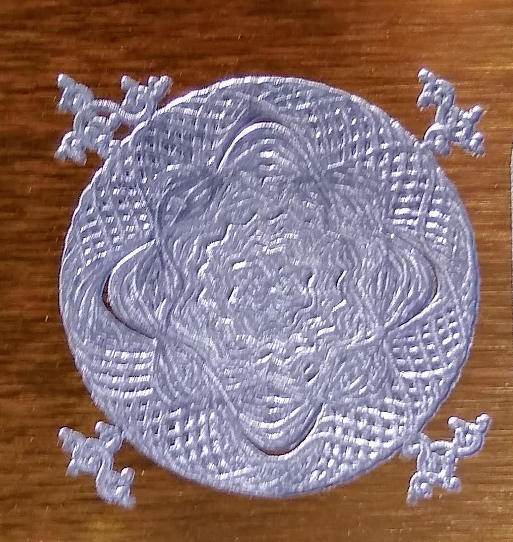

A drop of tapmagic self-distributed (sprayed everywhere) but it spread out nicely with a little finger wiping. Today's effort was at 0.05mm with the 90 degree bit, planned to do another copy at 0.1mm but between the shelter trip (will be taking the moosedog next time, after we get a copy of his immunization records from up north) and taking Mrs. Moose to dinner have run out of time.
The outer pattern came out well, more chiseled looking in person if not the video. No burrs on the edges at 100mm/sec, might boost the next test up to 200 (yes, I know, shouldn't change two parameters at a time). The center was too much detail and washed out, will see if deeper makes it better
Edit, thought the lighting and focus came out better, guess not. Need to figure out how to photograph these properly since they look much nicer in person. There's a flourish in each corner, but they didn't turn out real well at this cutting depth

Got a chance to try again, 0.1mm and 200mm/min. Overall I think the first (top in the picture) looks better but it's close. The center is still wiped out, past the limit that this bit/machine/material will do. Vexx was still open so I screenshotted the actual design for comparison.

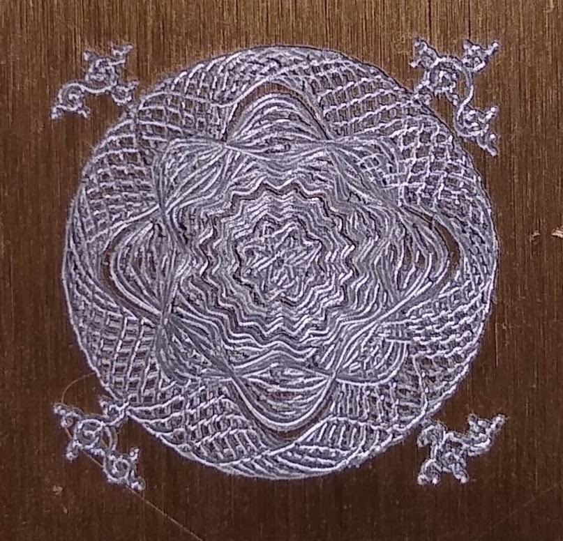

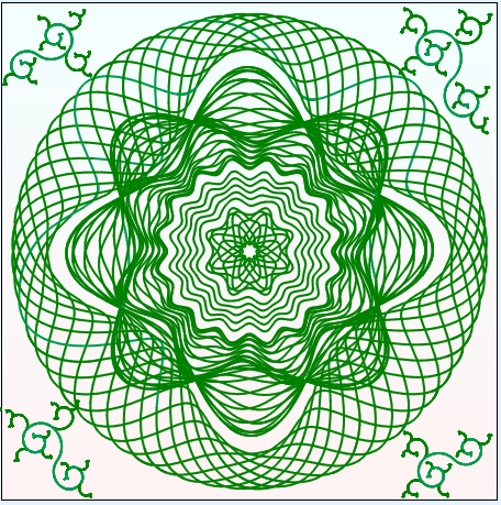

I think there's too much detail in the center for it to work, at least in mystery aluminum, just levels it off instead of leaving a pattern. These are intended to see what the machine and I can do, may have limited out the 90 degree bit. I might try a new 20 degree just for fun, see if it does any better. I've found somebody that's tried the $50US eBay diamond drag bit on acrylic with good looking results, but am strongly resisting the urge to buy one until I've figured out the V bit. I'd like to try some boolean operations with line art images and guilloche too, like mask off a leaf shaped area from a pattern and see how that goes. I spent a little time playing with a free program called ZebraTrace, turns pictures into guilloche like patterns, but it relies on cutting deeper to get wider traces and this material is too thin. Since it's double sided taped to the spoilboard it'll have to wait until I finish up this workpiece first, plus it's another distraction from my primary mission.

Did the test pattern again with a 20 degree flat v bit, 0.1mm doc, 100mm/minute. While the detail is better I don't like the effect as well, lines vs chiseled cuts, and it left a burred edge. Caved in and ordered a 90 degree diamond drag bit and collet set off eBay, will see how that works out, but for now the 90 two fluter wins.

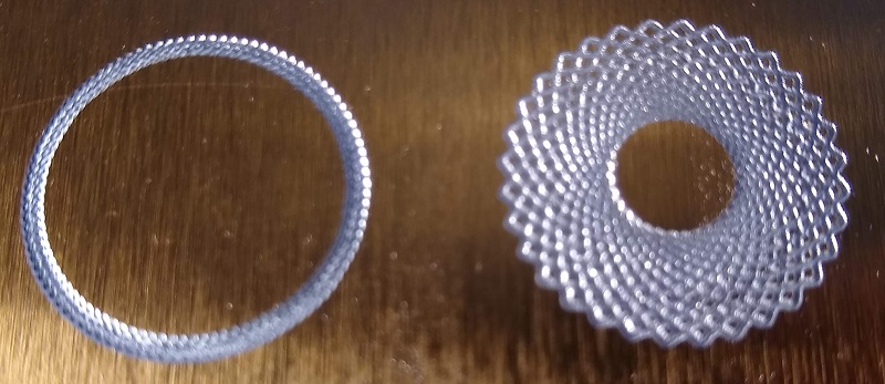

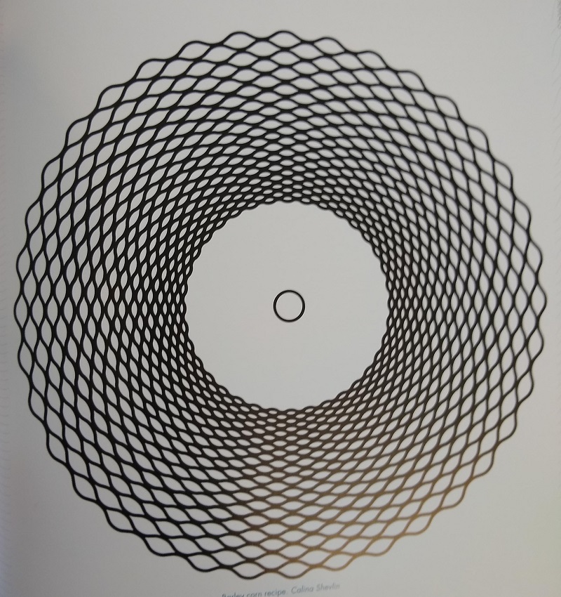

Barleycorn! Aka Grains d'Orge. The first one is a (simulated) 96 lobe rosette, the second is a 32 lobe. I adapted the recipe from my Guilloche book. Giggle "barleycorn guilloche" and you can see how the experts do it, in gold on expensive watch dials.
Creating them is fairly simple, if tedious. Set the inner and outer elliptical order to the desired number of lobes, and set both elliptical coefficients all the way right (you could use a higher number but for my 25mm size the smallest, i.e. most defined lobes, worked best) and set both phase sliders to 0 (not completely necessary, but if left at 100 you can't read the numbers easily). Set the maximum radius as desired, fill type to line, density to one. Using the outband and inband radius place the outer wiggly circle where desired. Click next. Enter a bigger max radius, then adjust the inband radius so the new line is just inside the first. Use the phase controls so the lobes touch, i.e. the valleys on the outside line match the peaks on the inside line, both should be the same. You will need to tweak the inband (or outband, either works) radius, I zoomed in on one lobe and stayed their, panning the display when necessary. Happy? Click next, readjust the max radius (you need the outband outside the new line), set phase to zero, tweak inband radius (the left and right arrow keys are really handy) so the valley and peak just touch. Repeat, varying the phase from 0 to what works, each time. Hey, it's easier than clicking the rose engine pawl 25 times.

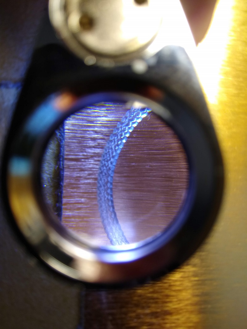

The 96 lobe, my first try, looks good under magnification but is too small for these aging eyes (cataract surgery after the knee heals up...). The 32 lobe pattern is just a little too coarse, should have either used a higher elliptical coefficient or more lobes since it left some uncut aluminum in the outer rings (I think there's 16 loops, something like that) but it otherwise looks pretty good magnified. I also attached the printed version from my book (all rights belong to the author, of course), so you can see how it's laid out.
90 degree two flute endmill, 25mm diameter, 0.1mm doc at 200mm/minute. Output as dxf and cammed with carbide create. And don't save your vexx file as .dxf, by the time I realized why Carbide Create didn't like it I'd already restarted from scratch and overwritten the file.

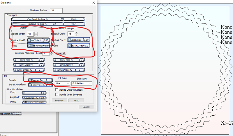

Re: Guilloche!
Hessel
I'm sort of working along with a book on Guilloche and Rose Engines and trying to duplicate some of the simpler patterns, of course no guarantee that this is the right or best way since I'm really using the wizard in unintended ways.
I used the Elliptical Order box to set the number of lobes, and slid the coefficient slider all the way to the right to get the "gently undulating" curve. I've been setting both the inner and outer envelopes the same for now, but real rose engines used a variety of shapes. Search for Bill Oombs for a rose engine simulator, trying that out is on my list for the future. I set phase% to zero, only because it makes it easier to read and match up the numbers on successive traces.
Fill density is set to 1, Fill type to line.
The maximum radius will need to be adjusted to be greater than where you want the trace. Use the Outband and Inband Radius sliders (if you click on them you can use the keyboard arrow keys for fine adjustments) to get the size where you want it. When the outer ring looks right (it's actually the middle one in the screenshot) then click next.
I closed Vexx before the second screenshot so some values might be a little different. The Maximum Radius will change, set it back to your first value or something that gets the outer envelope outside your work, in this example I made it a little larger. You'll do this every time, different values for max radius might make the slidering easier as the pattern gets smaller.
Use the InBand Radius to get the second trace close to the first one, then use the Phase slider to align the high spots so they touch. You need to set both the inner and outer phase the same (or maybe not, if you want a different effect). Then zoom in and get the two bumps almost touching, and adjust the phase if necessary. When it looks good then click next and repeat, alternating a phase of zero and the value that lines them up. After a couple passes it goes fairly fast. Repeat until you get the desired effect or get tired of repeating :)
Hope that helps! After rewatching the Vexx videos I'm going to try the celtic knot cutout again, maybe with the snip tool and reworking the knot dxf to make sure all the shapes are closed. We'll see. My inspiration is attached (this one is from a swiss watch company via a link on cnccookbook.com) but I'll never get that good. No special reason for the celtic knot other than I like them and had this particular dxf sitting around. Why try something easy when there's something much harder sitting around :)
