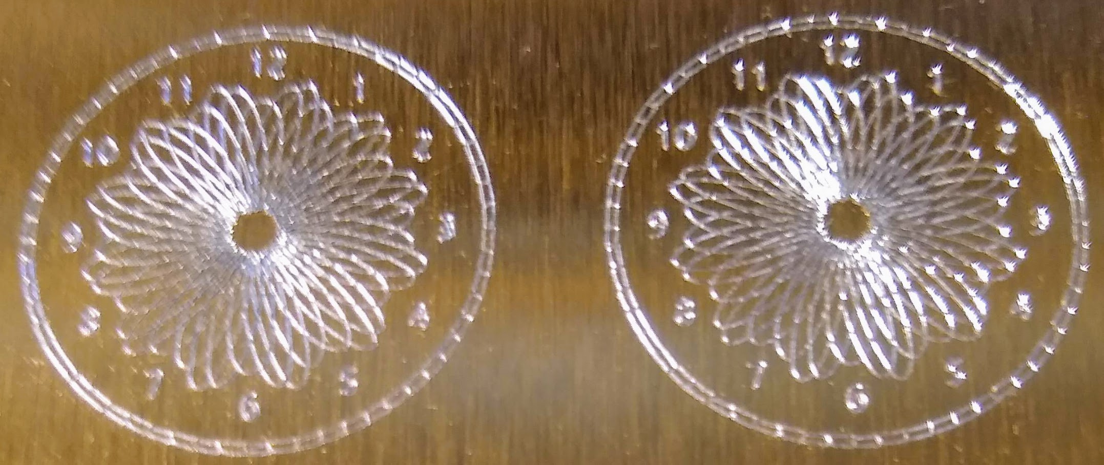

There's a small gotcha in the "2" in the magnified picture, one side is an S that descends below the bottom line.  These were un-snippable in Vexx.  Not significant since it's the old editor.
This is clock dial from the Auggie wizard with a simple guilloche pattern overlaid on top, diamond dragged at 800mm/minute and with the spring compressed 5mm (half way), trying 2.5 was too shallow a cut.  That 5mm, plus the 1mm safe height, consumes most of the cut time as it makes 200 trips up and down.
