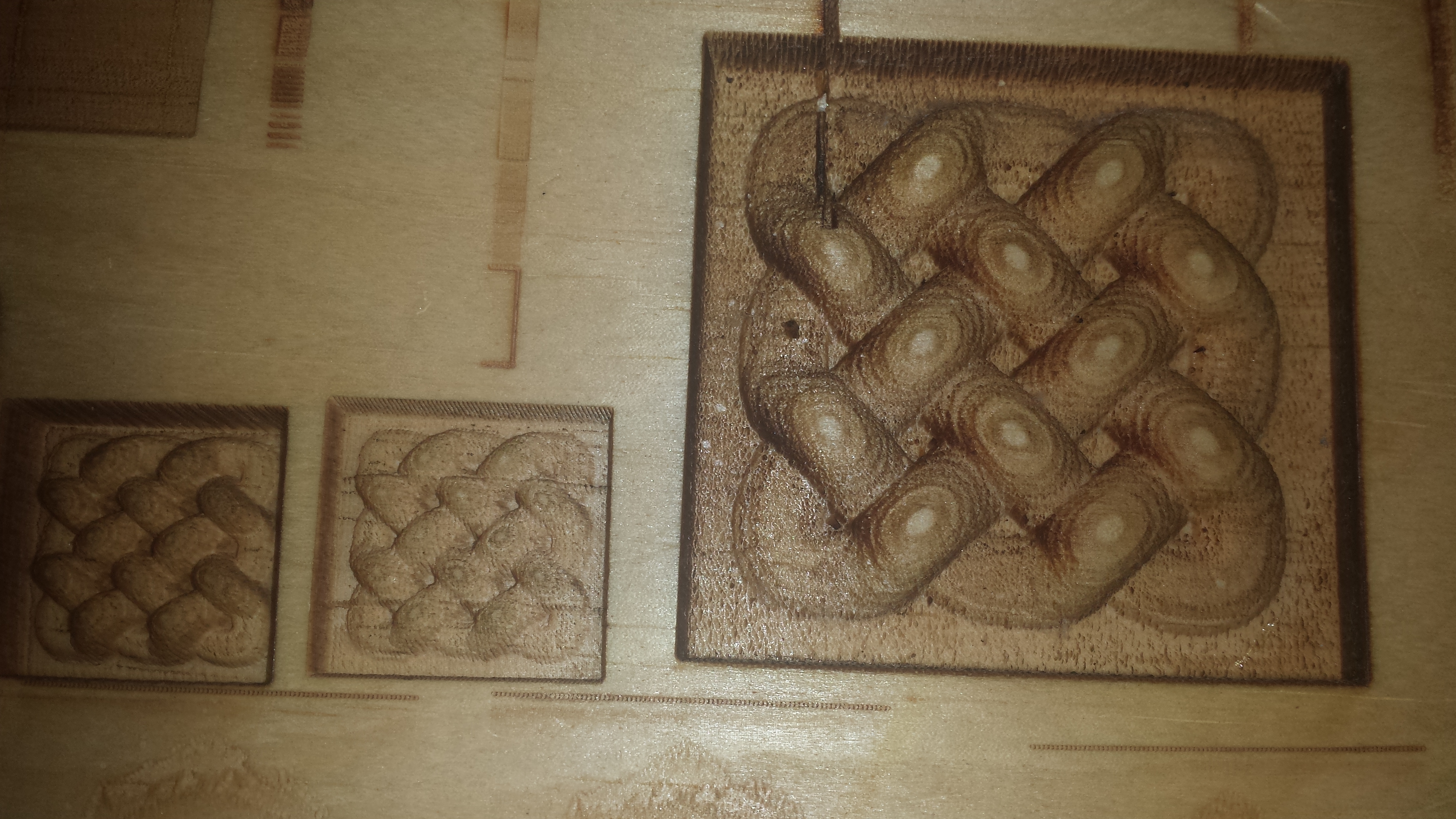

Though you might like to see a photo of laser engraved celtic patterns I did yesterday
in testing. Their pretty nice for a test..

Those are amazing looking for laser engravings.  They look like they have a lot of depth.

The large is about 1/4" deep, the leftmost one is 3/8.
Large takes 10 passes, total 12 minutes, small ones take about 3 minutes to do in
the same 10 passes.

Wow, I didn't know you could get so much depth without burning the wood.

kinda like milling, you take a bit each pass..
