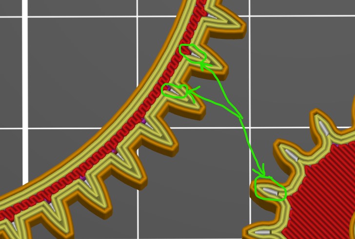

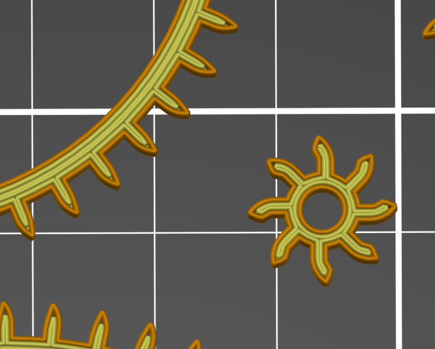

The pictures below show the sliced output of fancy gears and normal gears. Notice all the tiny infill segments on the normal gears (marked in green). Each one has a retraction and the possibility of creating a string or a small blob. These small imperfections add slightly to the surface roughness. The fancy gears print about 25% faster and are amazingly smooth.
It looks like involute gears could be made with as few as 8 teeth or possibly even 6 teeth using this method. One downside is that the gears become directional so you have to be careful to always use the active side of each tooth.

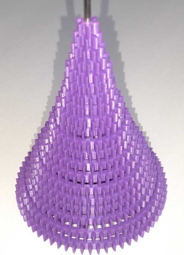

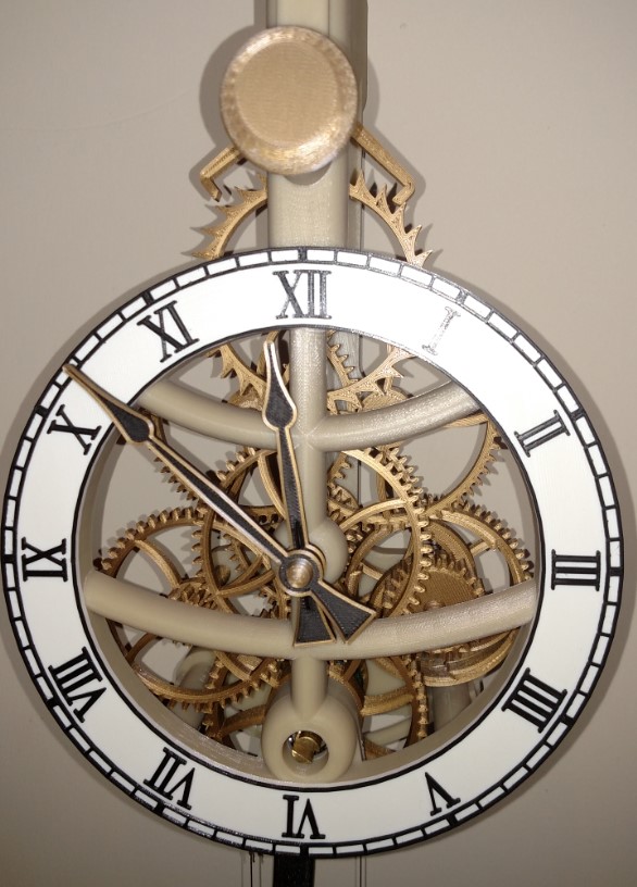

Here is a picture of the completed clock and a stack of test gears in various sizes. The clock looks a lot like the normal version because the large gears have somewhat normal shaped teeth. The pinions look a lot different, but they are mostly hidden from view.
I was a bit worried about the tooth strength because of the narrow root. However, they are quite strong because the print path is a continuous length of filament. The rim flexes well before the tooth bends.

The latest PrusaSlicer (formerly slic3r PE) claims to have added wipe into infill, wonder if it might help with the infill related roughness on the gear teeth. I'd suggest you try a really fine nozzle diameter, during a tiny tree frog competition a long time ago I made nozzles down to 0.2mm on a Unimat SL, but I suspect it's easier to buy them these days.

Wipe before infill looks like a good option. I am using PrusaSlicer, but it might have a different name. I will search for it.
The biggest advantages with fancy gears is additional clearance with low tooth count pinions. My last clock uses 12 tooth pinions. This increases the size of everything else and the total print time is around 90 hours. Fancy gears should allow the use of 8 tooth pinions and a much smaller clock.
