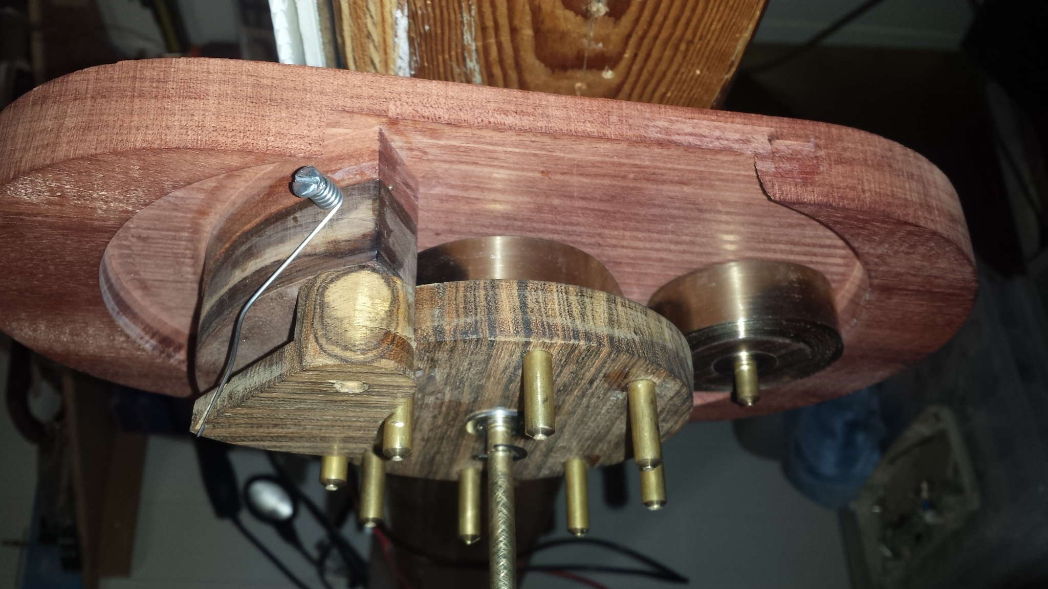

Heres a photo of the engine Im working on.. the top rotating stage isnt on it yet..
shows the spring arrangement though..
Couple more showing how the spring is used..
This is a spring from vuclan springs, the constant torque, should give a few hours of motion..

Looks well built Art, beefy !! I'm curious about your mechanism, I'm imagining pawls on the outer wheel, that will trip that pawl off it's pin on the backstroke? Does it advance one pin at the time? What size spring you got there? You've got me intrigued to say the least. Looking forward to pics of the outer wheel.
Good stuff,
Eric
Good stuff,
Eric
Eric:
I got the springs awhile back, as I RECALL they are 4lb CT, about 160" long or something.. takes
20 winds on a 3" take-up spool. The outer pallet, as it spin's backwards grabs the pin the main ratchet is on, a magnet on the outer pawl then pulls the ratchet away leaving the outer pallet holding the pin on its own,This makes the outer pallet turn in reverse, and as it pulls away, the magnets separate and the main latch trips back in, thus one pin has turned. This means about 45 degrees of push per trip. This uses 2 magnets in a dual action, the first pulls the outer pawl in until it hits the pin, the magnet on the lower lever now is just offset enough to pull it outwards when friction releases it. This makes it dual action, the outer level pulls inwards to a limit, then the inner pulls outwards to the magnet, then it all reverses.
In testing, it seems ok but hasn't yet been fully assembled, I may end up switching the way it works as yet,
but I'm happy with the bottom, seems strong and has multiple possibilities for tripping.. just gotta find one..

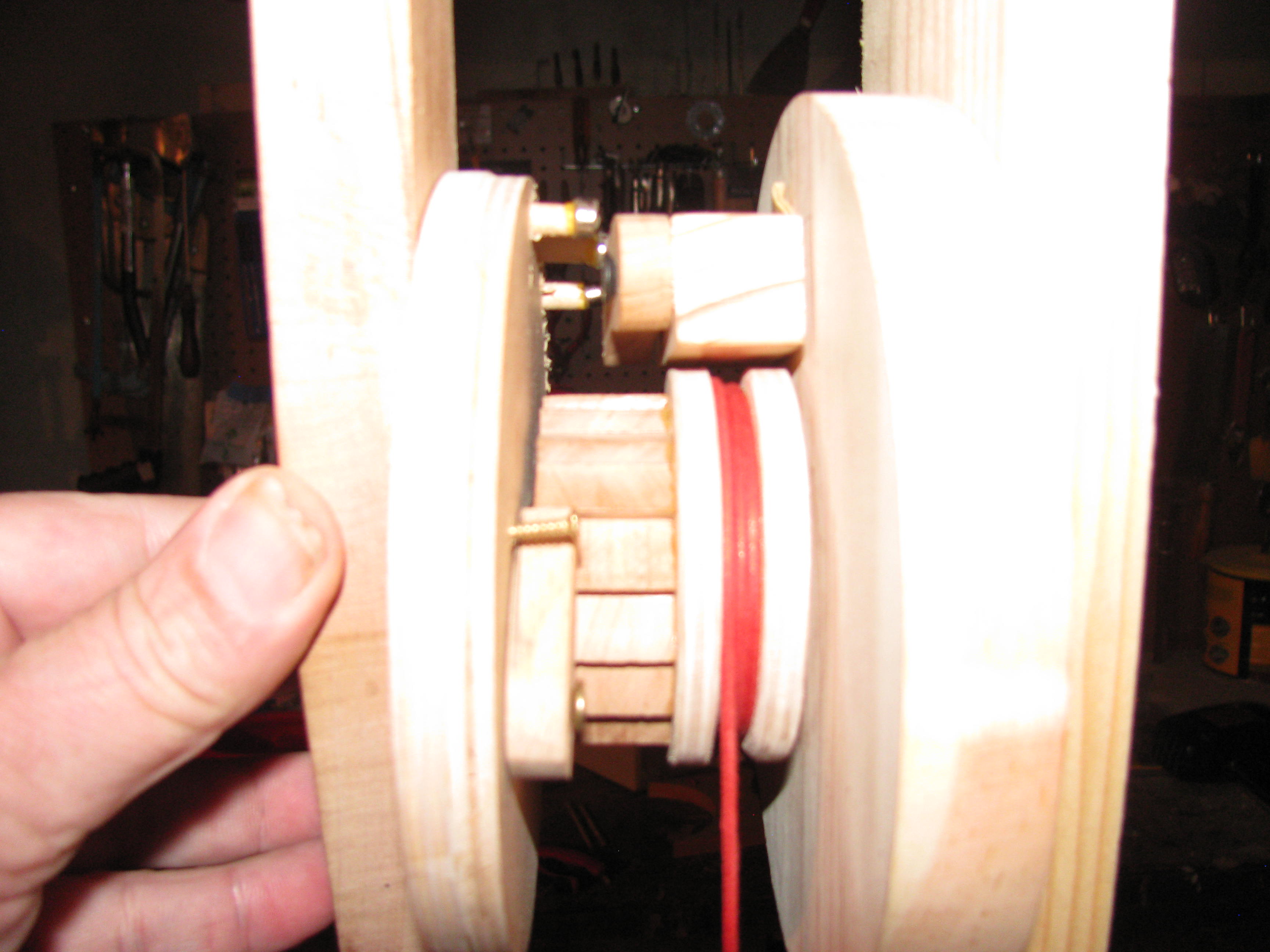

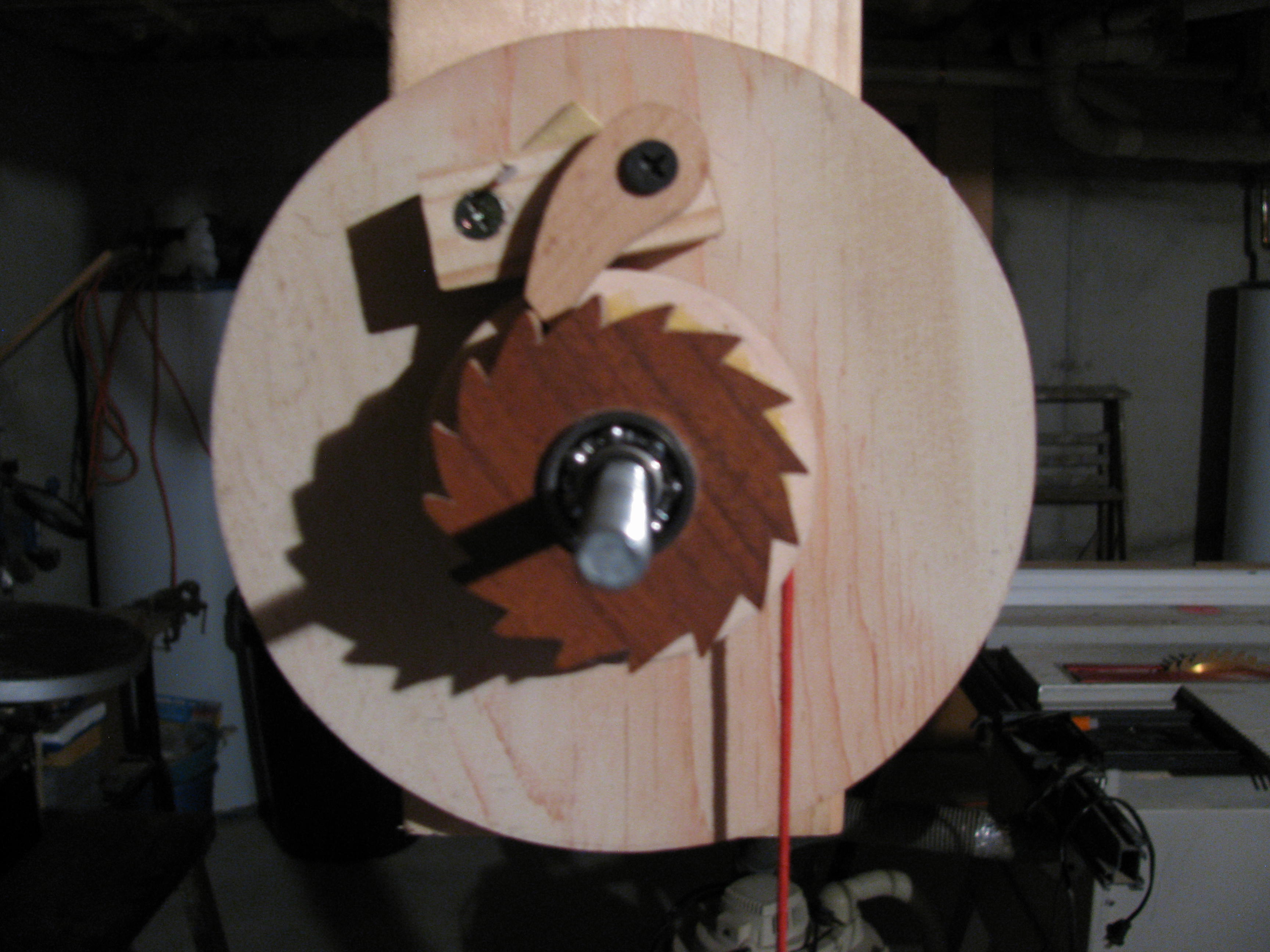

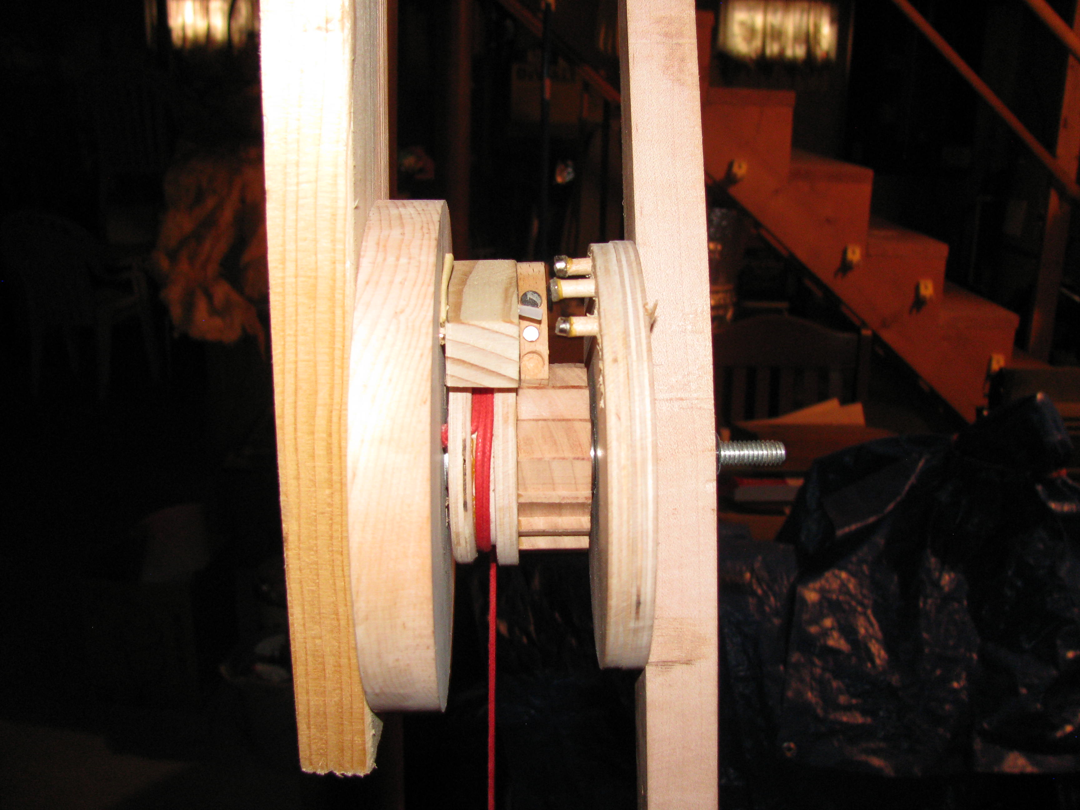

OK Art, gotcha. I get the jist of your engine. They are hard to describe, but here goes....
Here are pics of my unfinished project. The upper (inner) pawl is lifted by magnets glued to small dowels inserted in the outer wheel. They are adjustable, hence the extra holes. In the pic in the following post you can see the outer pawl catching the ratchet as the magnets lift the inner pawl. Gravity drops both pawls. The magnets are placed opposite the heavier end of the arm, to get the most from the back swing.

A couple more.....
Sorry for the huge pics, again, I don't know what I'm doing...... :-\

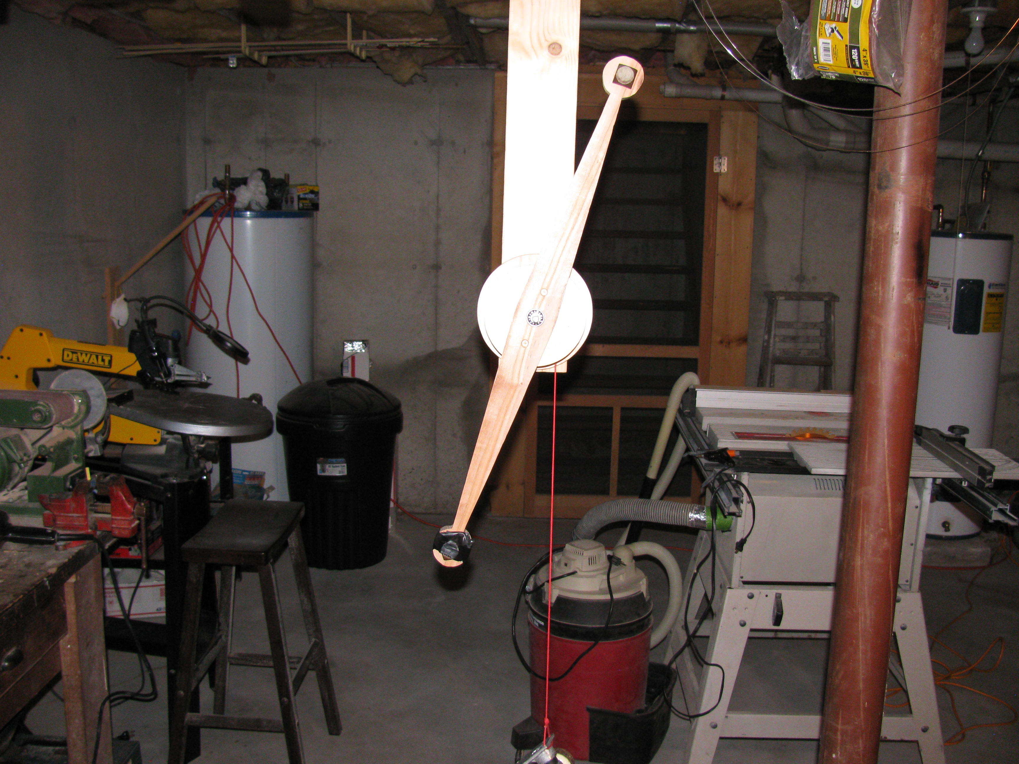

Art, I was thinking that David Roy's pawl is shaped to avoid slipping off it's pin. If you wanted to eliminate that spring you could sand the end of your pawl....
these pics show the wheel coming to rest, reversing position, and starting again.
