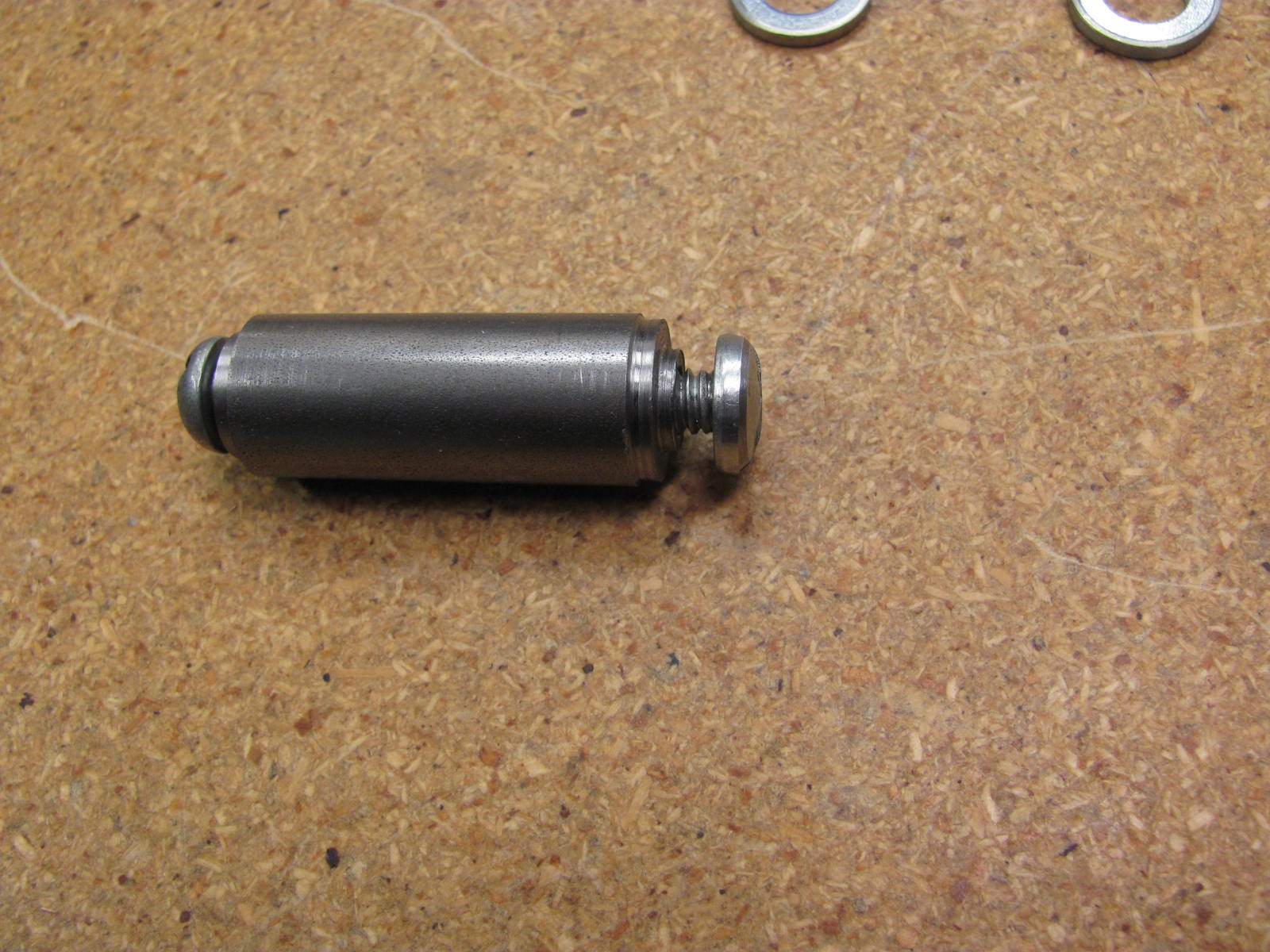

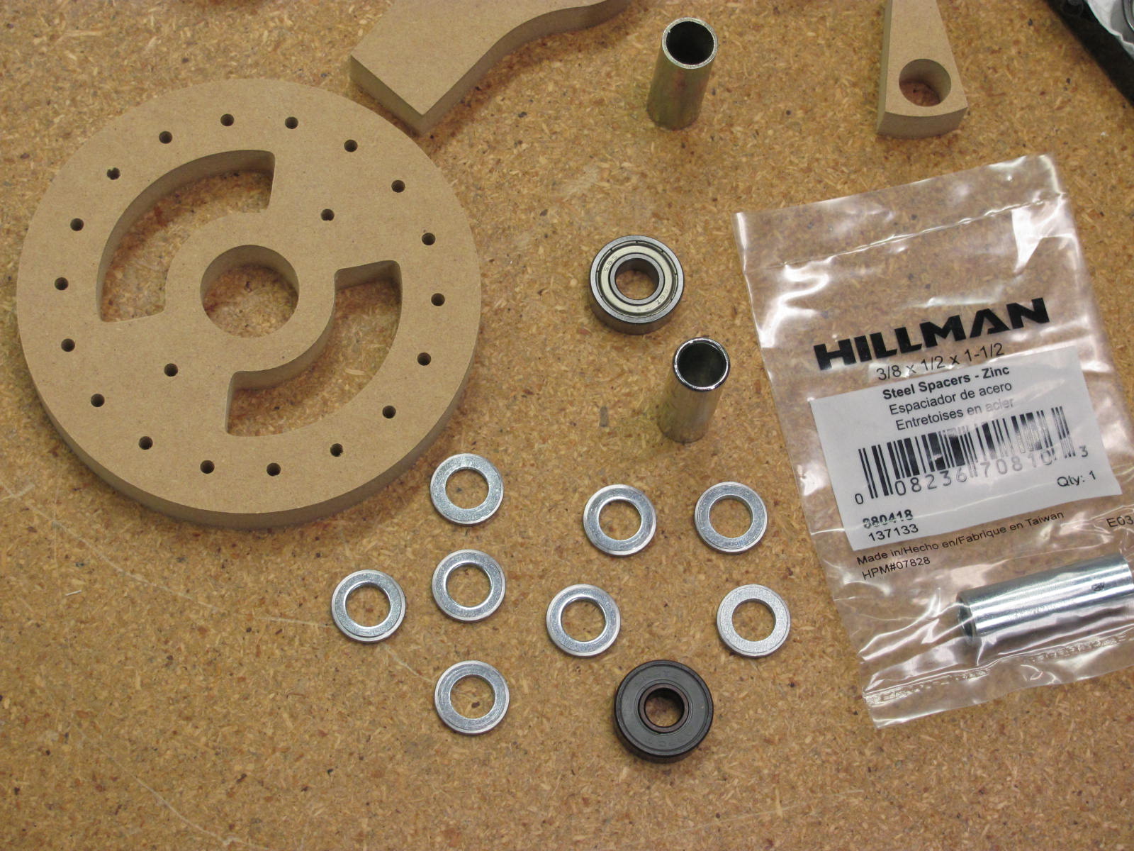

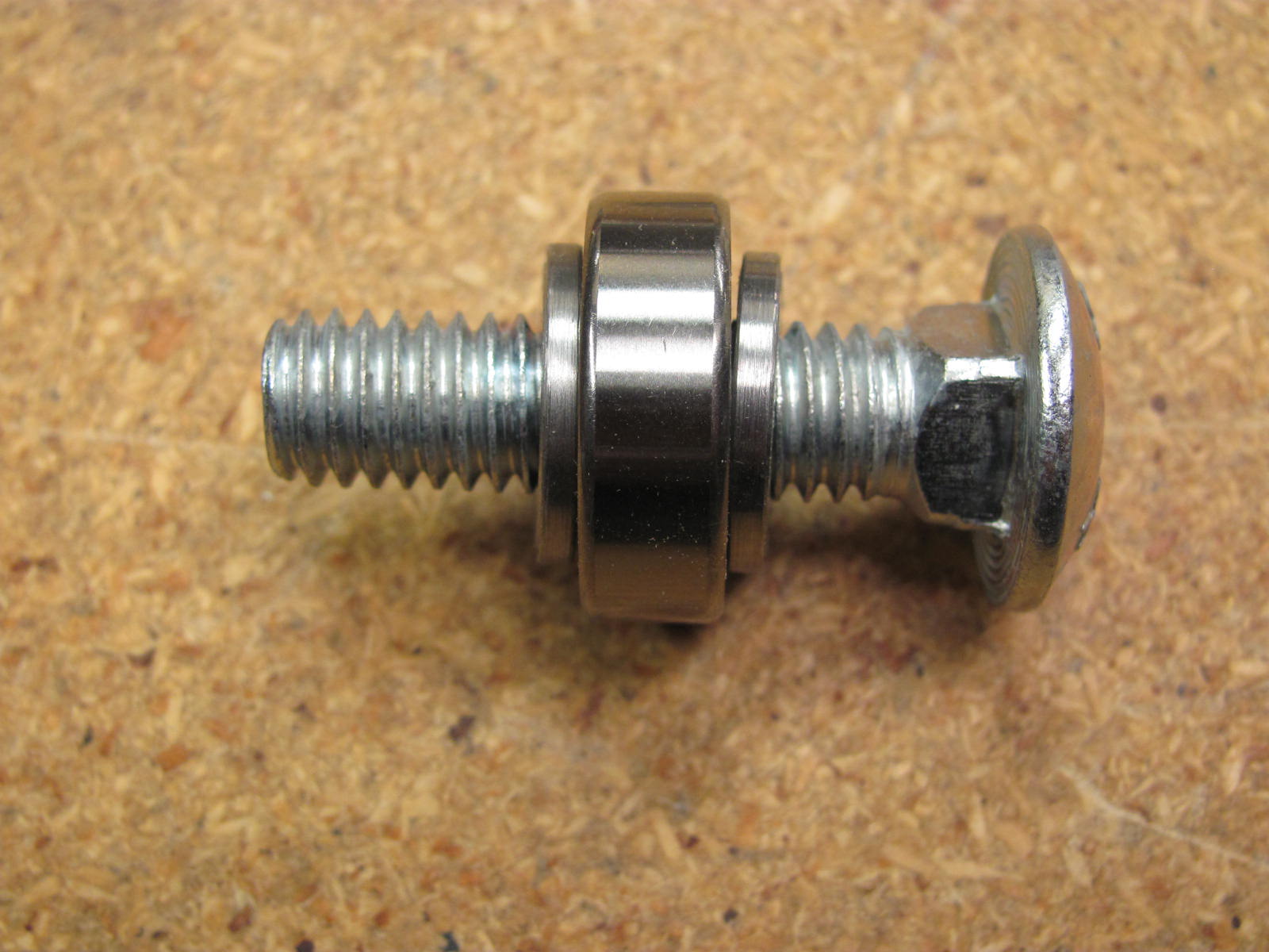

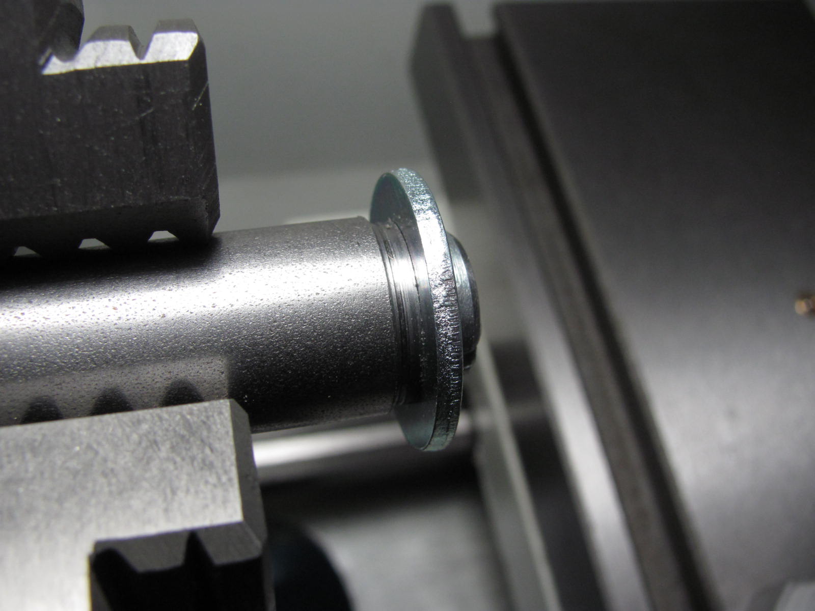

There seems to be a lot of interest in bearings and their importance in kinetic sculptures, clocks, etc. so I thought a new discussion thread with the topic might be useful.  Although it is probably obvious to anyone using bearings, one hint is to make sure nothing touches the sides of the outer race of your bearings.  I am fortunate to have a lathe so I can machine washers to an appropriate OD by holding them in a jig designed for the purpose.  The washer is held on a mandrel with a lip slightly less than the thickness of the washer, the lip is machined to the ID of the washer and the washer is held in place by a screw when turning.  Tube spacers are also useful for keeping things properly positioned and allow all components on a shaft to be tightened securely without compromising the reduced friction afforded by the bearing.
