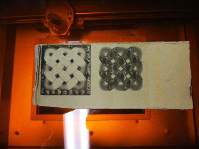

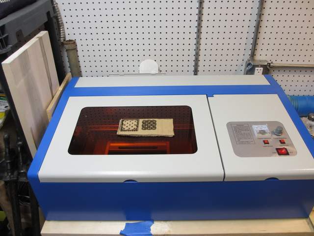

The laser has landed!  After unpacking, fixing a couple loose screws, a quick alignment test (almost, not quite, needed a bit of adjusting), and installing the included LaserDRW I fired it up and engraved a Celtic knot pattern on cardboard.  Not the best looking results, but it proved it's working!  No outside venting, the window I was planning to use was caulked shut so I need some driver vent hose to reach an unsealed one, so I didn't get very adventurous.  Still, it'll engrave or cut cardboard on very low power, and I did a little practice Plexiglas engraving with some of the kid's drawings.  I'll try Gearotic DXFs with the included sw next.
It came double boxed, almost 2" of foam sheet around it, and the tube had (synthetic) foam rubber pads to protect it.  Using about a 4 gallon drywall style bucket for the cooling water (no leaks), and our soft tap water.
Couple pics attached.  I took some unboxing pictures that I'll post somewhere, too.  I'll seek out some dryer vent hose, distilled water, some RV antifreeze, and a bigger water reservoir tomorrow.  Flow switch and other goodies ordered, need to 3D print an air assist nozzle.

Thanks for pics  I had no idea how big a laser unit was - I probably can't afford it anyway but it looks pretty compact.  Lots of smoke?

Excellent. I see the software actually varies the power over the run based on greyscale, I wish mine did.
Ill be interested in comparing cut power and depths with you. Let me know when you figure out speed
at 100% power to cut say 4mm acrylic or so.. Id be interested in your results.

It's 32 x 20 x 10".
You'd be surprised (I was) at the price, $365 US delivered.  The eBay prices vary quite a bit, I ordered it on Friday with free shipping, and on Monday it was an additional $35 to ship.  There's a large number of sellers that ship from a US warehouse, but I hear they are mostly the same two Hong Kong based companies.  The machine was made by the Liaocheng Shenhui Laser Equipment Co., Ltd., which I read makes most of the K40s.
Wife complained about how smoky the basement was.  I really need to get some dryer vent hose, rather buy some more than unseal the formerly leaky window.  It's now under a porch and doesn't let any light in.
