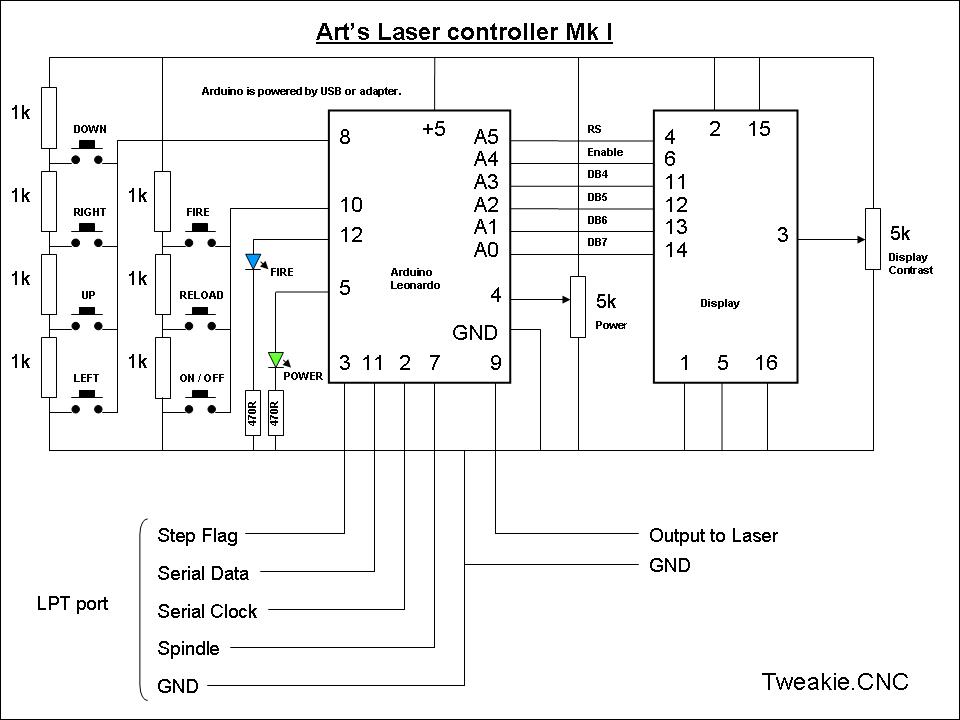

If it?s any assistance to others that follow with this project I have redrawn Art?s circuit diagram to show the interconnections and pin numbers shown on my Leonardo.
EDIT Circuit diagram updated to include series resistors for LED's
Posts: 4648
Wow.. Thanks Tweakie, that looks awesome...
