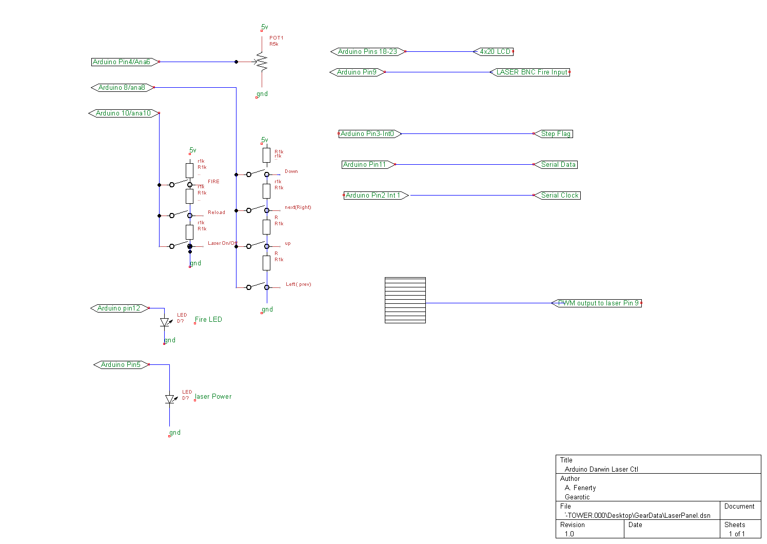

The software in the arduino isnt very complex, as my first arduino experiment you can imagine that
it wont be up to a knowledgable arduino programmers level. One of my hopes here is we attract such
people or we learn together how to do this better. Also worth noting is that while it was important
to me to have a diagnostics panel at the machine for testing and calibrating future engravings to the
material at hand, you may not want a diagnostics mode at all, and if so, just a simple arduino with
no box, buttons or LCD display would work fine, the program would simply require a bit of recoding
and you could hot glue the arduino into your cnc control box to permanently control your laser power
with no interaction. Point is.. there's lots of room for altering what we're doing here.

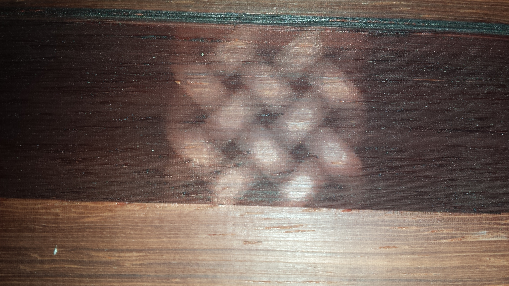

So thats it really, not very complex, and from a programming standpoint not very hard to implement
so far. Ive cut many photo's and each is an interesting lesson in power vs speed vs output. :)

That makes a lot more sense to me now. I never did more than a set of digitalOn/DigitalOff and sleep for a few us to get the pulse. I never fooled around with the OCR1A register.
How about posting a snippet of code that does just the tickle so I can try it for myself while I wait for the rest of it?
Hi Sky:
TO do that Im using a PWM library for the leonardo..but.. it was set to do only phase correct
PWM, in that mode if you change duty on the fly it creates a double pulse... so I modified the
library by changing the control bit to be FastPWM.. So if you use the library the following code
will allow one to control the PWM duty cycle on a pulse by pulse basis.
(I include the PWM library as the one I modified). Ive modified a coupdl fo the system files for
this project.. so just be aware when I post a library it may or may not match with the Arduino libraries
as released.

I dont normally draw schematics, so forgive the poor quality. Here is the wiring of the laser
panel, as you can see its pretty simple, just a few buttons, an led and a few wires. Not shown is the
5vdc and 0vdc wires connected to a breakout baord or external 5vdc power supply. You also need to hook
the negative of the 5vdc t0 the ground of the breakout board..
(Schematic Modified Oct 1/2014)

do you think it might be "safer" to put 47k pull down resistors on your analog button reading pins ? . I'm assuming you have weak pullpowns turned on but a noise spike on the fire button could be nasty.
Hi Richard:
Noise spikes typically have very little current capability behind them, but with 1k to ground as worst case
button press we get about 5 ma in normal operation, the pin will only source about 50 ma I think.. so even if the voltage
on a noise spike got to 50 volts, you'd still be at max about 50ma and even then for so small a period that actual power
dissipation would be too small to care about. Induction of enough power to hurt the arduino would be near impossible
on the button lines, so 1k is likely more than enough. Feel free though to use pretty much any resistance you like as
its truly not critical in this type of circuit. Its more about the ratio than the actual values.. I would worry about too high
a value making the circuit a bit more susceptible to noise.
(All just my opinion of course, I make no pretence at an engineering degree. :-) ). All that having been said, those are
the reason I picked those values, and since you ( or anyone) may know better than I, please use any values you might
calculate and let us know. Id worry on 47K though ( if used on all pins ) that youd then max out at around 200K for one of the
button presses and with that low a current flow noise could give wrong indications. ( 4.7K perhaps though)
The reason I state ratio's are more important than values is simply the code gets easier if all values are the same.

I should add one more thing.. the labels for the button names are wrong in the schematic, I just relaised
I used an old napkin sketch and cant find my final layout paper, so Ill have to trace the code to see what
button is actually which in their respective groups.

- Posts: 152
art
my concern is that the analog input pins are essentially floating until a button is pressed . floating pins are very subject to noise
Richard:
In this case I turned on the internal pullup resistor with a digitalwrite to that analogue pin, it keeps it pulled high until a button is pressed, that seems to make it resistive enough to noise .. or at least on the buttons I haven't seen any..
- Posts: 152
art
I'm mainly thinking of others making this , where the buttons may have longer cables attached and or high voltage laser supplies may be employed , the internal rpu (pullup resistor) can be as high as 50 k . a lower impedence wont affect the readings and will give greater noise immunity.
just a thought , great project though
Richard:
Very good point. I hadn't considered the folks with high voltage supplies.
I will change the documentation to show 47K's as the resistors. Your quite
right that there really shouldn't be any downside to it, though Ill wait till
I hear from someone with higher values before making it official.
Im sure over time many such changes will take place , as this is my first
arduino project Im happy to hear such suggestions for change. So long as the
same values are used for all of the resistors the code should remain valid.

Hi Guys
Playing with 3d sculpting.. first try with a single pass of a celtic knot output.
Weird looking, looks ghostly..
