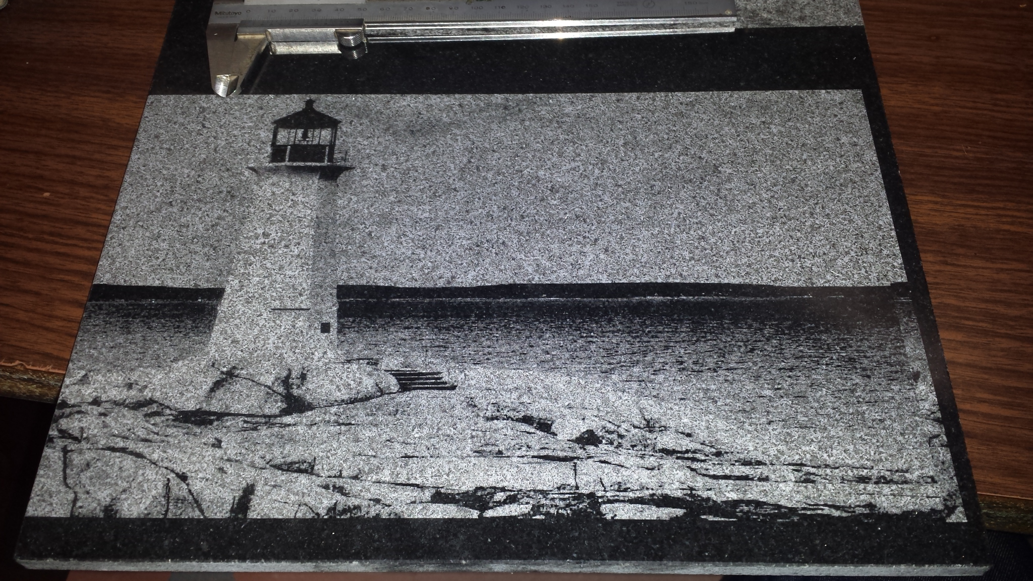

Just tested some new power routines, heres that lighthouse on a granite tile, 300mm x 200mm , with a power gradient of 5% to 70% , it probably should have been a bit lower power.. but its all coming together. :)

for a test that's pretty cool
Not as white as Id like.. I think perhaps its the type of stone..thats just a 6.00 polished granite tile from home depot.. Im thining different stones likely give varying
grey scales..

Very nice work indeed with the lighthouse on granite - I really must try something like that.
