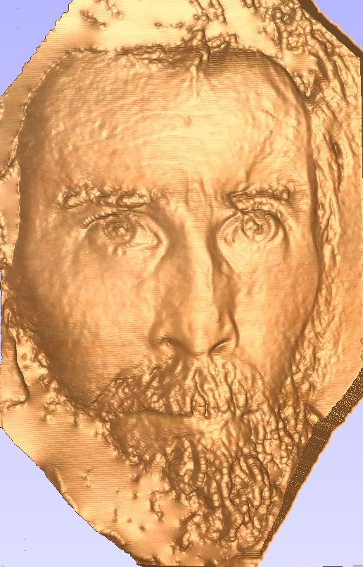

hi art tried the webcam in my scanner box the picks came out ok with me turning lights on and off by hand.
had settings at 176 x 144 YUY2, confidences at 270.9, gradient scale 0.01 I put the image out at x 176, y 144 and z 14.81831, vertices 6331. see attached pic
it would have worked better if i turned lights on and of at the correct time got it close a couple of times pic`s came out quite clear so if you wont to add out put light control through a arduino that would be cool this year next year when ever.
if you did I think it would be as good or better than the scanner program I use.

hi art did not see your reply did some playing with a black back ground so much better the area around what I did images off is single colour and flat.
I will add images of result from cut 3D
a is same settings as before as a negative, 3 is image

I have run in to a big problem the X and Y are the same as the aspect size but Z is coming out as just over 3 meter in depth I change x to 200 it goes down to 1 M
Re: WebCam Data
Wow, those are pulling out nicely.. just lower your scale slider, it should lower back to a reasonabel pull, I aim for about 150 as a good scale.. but it varies from data to data set..

Hi art moving the slider down to 1 leaves not a very good image, having it set to 2.5 is a lot better but it has a 80 mm curve ever negative or image it`s all the same.
so the scale of negative to image is good
but the curve is way to much the whole image will be curved cutting the side of helps a little bit.
I have tried a flat black back ground it make`s it worse bigger curve.
A flat white back ground is better, between black and white is 200 mm
it would be good if you can reduce the Gradient scale so if its at 10 it would be 1/4 or less of what it is now but keeping the image just as good or have it how it was in the last version I tried the one on your site had barely any curve to wear there was a flat back ground sorry to be a pain
picks 1 is negative, 1 on gradient scale pick 2 is negative, 2.5 on gradient scale, picks 1a, 2a is image same setting`s
threshold is 0.1, zero noise gradients is un ticked, ambient correction same, fullres resolution is 176 x 144 yuy2--format 2

here is a pick done with my webcam sitting on my laptop I have background lights on so its not the best but it half the depth of doing it in my scanner box with the Gradient scale at 3
