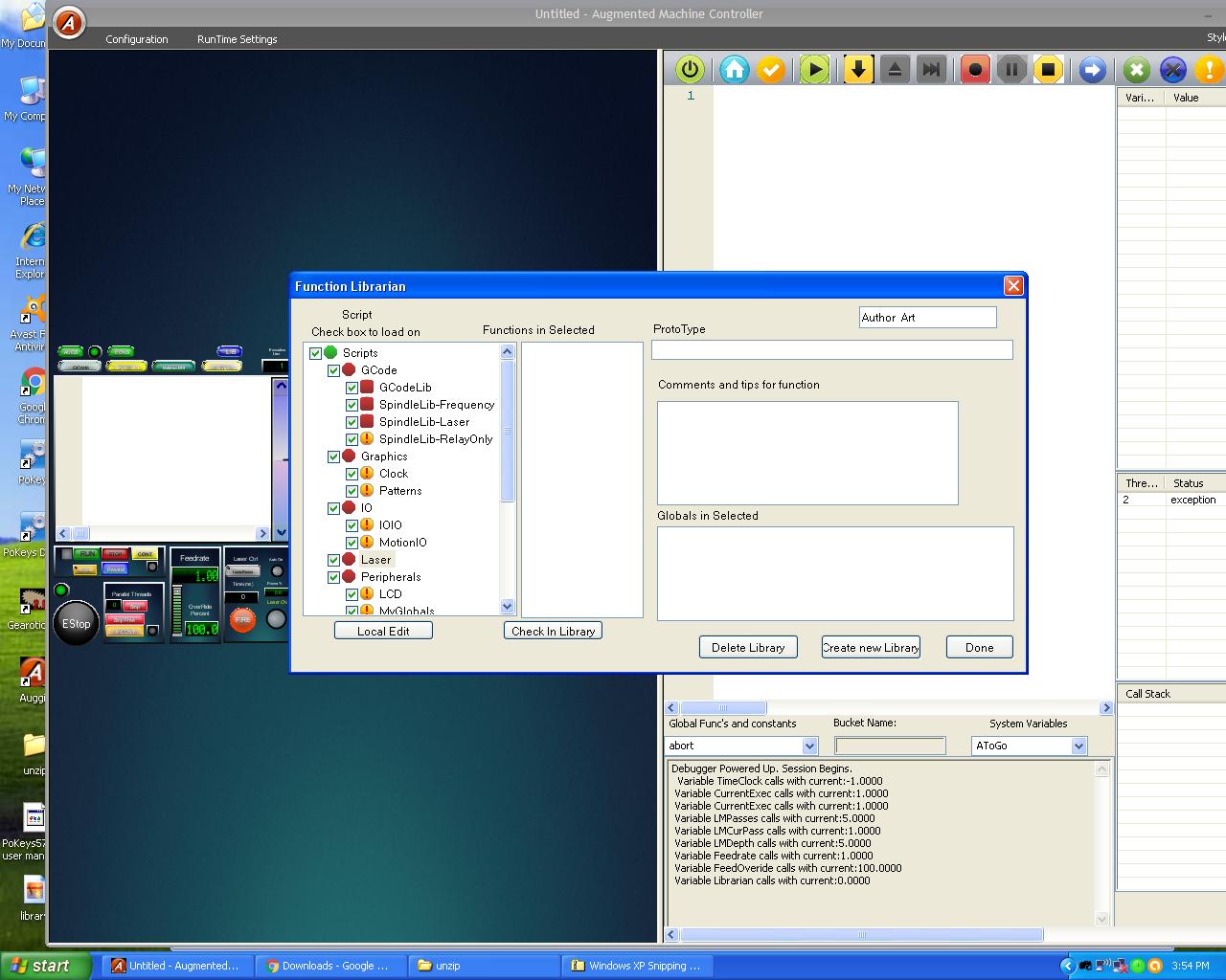

Seems like it may be a ui issue, and the libraries aren't being selected.
First screen shot is all libraries selected. Noticed the check boxes don't turn green,as they do on win 10 machine. Also the icons are in random state each time I open the Libraries dialog.

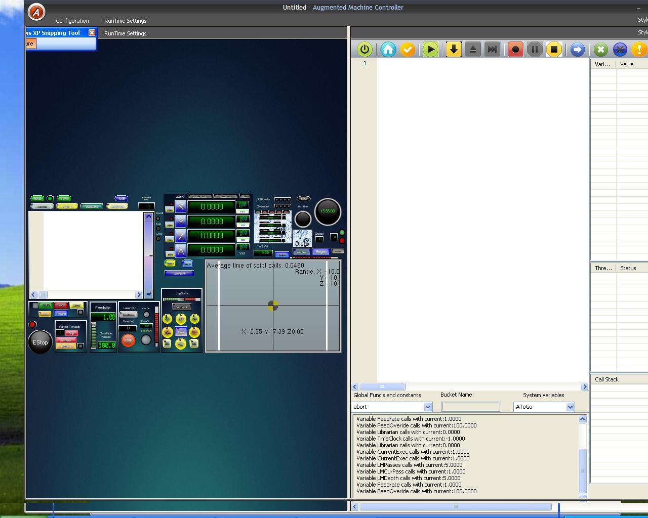

Second screenshot is scripter after I hit OK on Libraries dialog. Also attached the errorlog with log checked.
