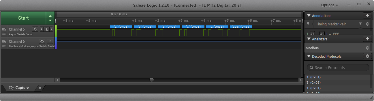

so far so good , one little weird bit
myser.SendTable();
does nothing &nbsp;unless preceeded with a senddata() &nbsp;at least once
so I did it this way &nbsp;, result below &nbsp; :)

not sure whats happening here ,&nbsp; vfd[3] and vfd[4] don't get sent at all they just vanish

100% SUCCESS
global SpindleSpeed = function( speed )
&nbsp; &nbsp; if( Engine.GetSpindleState() != 0)
&nbsp; &nbsp; {
&nbsp; &nbsp; &nbsp; CRC=0xffff;
&nbsp; &nbsp; &nbsp; print("speed set to " + speed);
&nbsp; &nbsp; &nbsp; vfd=table(0x01,0x05,0x03,0,0,0);
&nbsp; &nbsp; &nbsp; freq=speed/55.0;
&nbsp; &nbsp; &nbsp; freq=freq*100;
&nbsp; &nbsp; &nbsp; vfd[3]=ToInt(freq/256);
&nbsp; &nbsp; &nbsp; vfd[4]=ToInt(freq%256);
&nbsp; &nbsp; &nbsp; FreeSetSpeed( MySpindleAxis, speed);
&nbsp; &nbsp; &nbsp; print("Frequency&nbsp; set to " + freq );
&nbsp; &nbsp; &nbsp; for (inx=0;inx<6;inx+=1)
&nbsp; &nbsp; &nbsp; {
&nbsp; &nbsp; &nbsp; myser.SendHex(vfd[inx]);
&nbsp; &nbsp; &nbsp; CRC=Crc16(CRC,vfd[inx]);
&nbsp; &nbsp; &nbsp; };
&nbsp; &nbsp; print("the CRC " + CRC);
&nbsp; &nbsp; &nbsp; myser.SendHex(ToInt(CRC/256));
&nbsp; &nbsp; &nbsp; myser.SendHex(ToInt(CRC%256));
&nbsp; &nbsp; };
};&nbsp;
