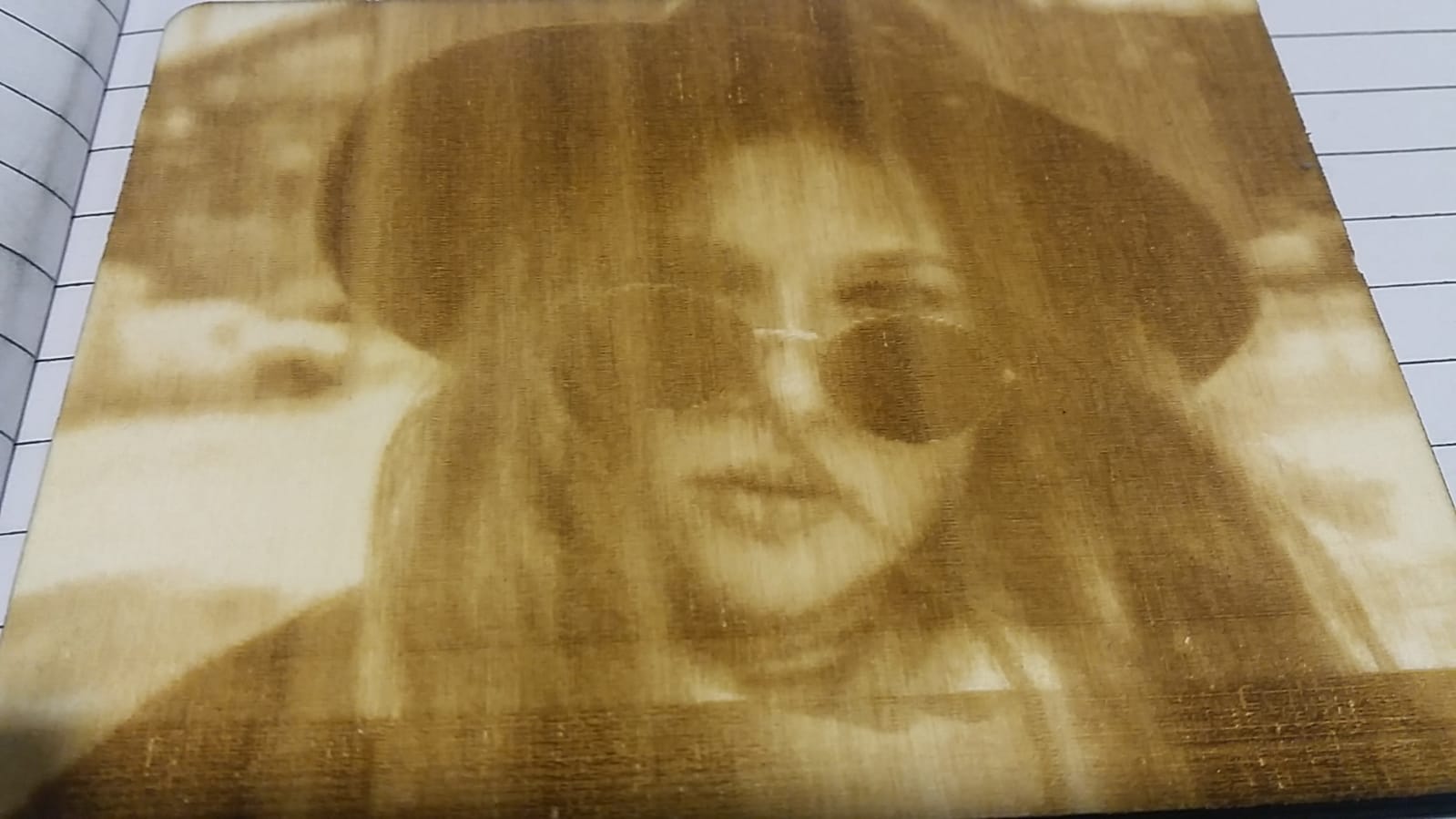

Re: My laser engraver from 0 knowledge to 32.461% .... probably

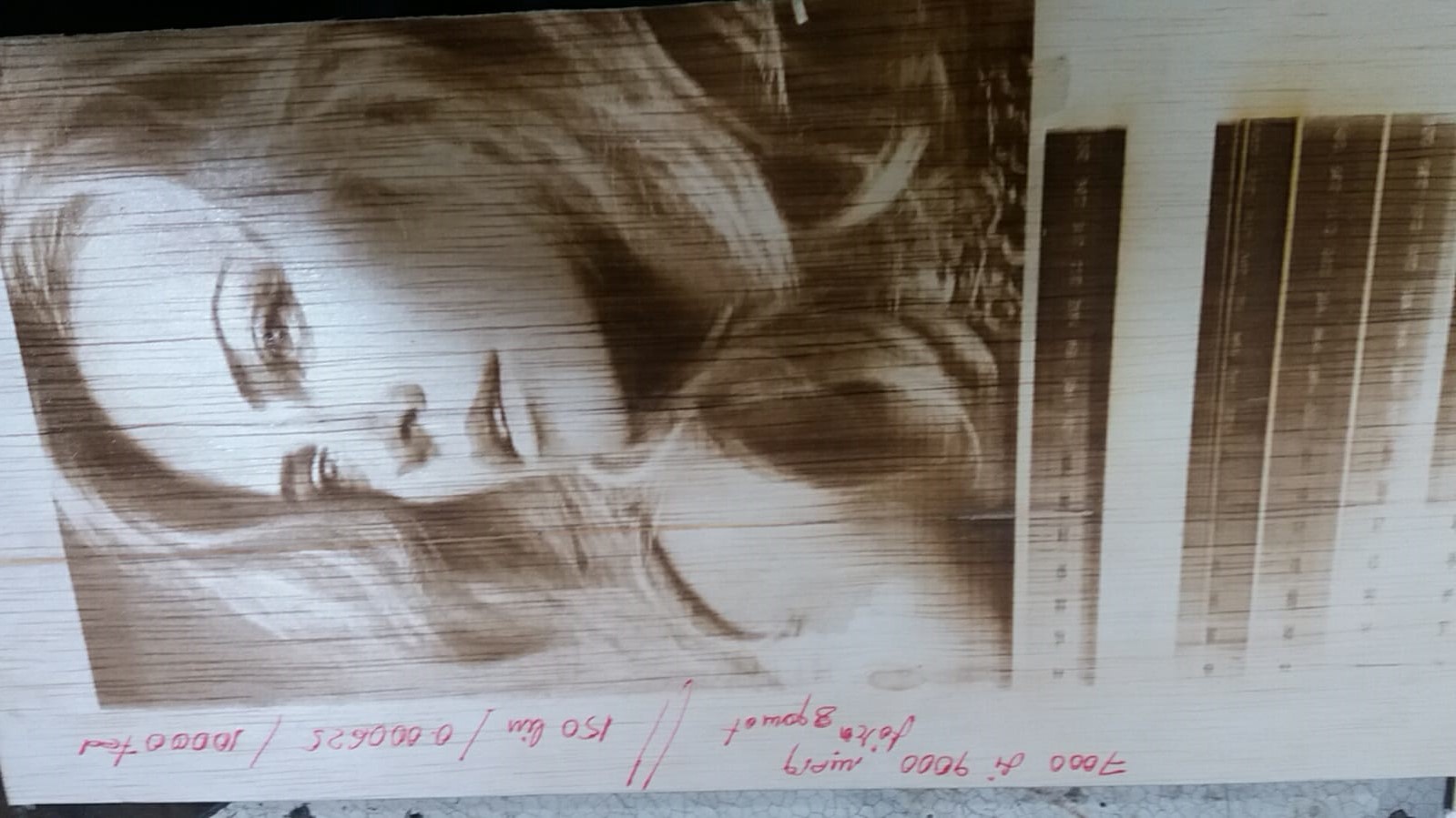

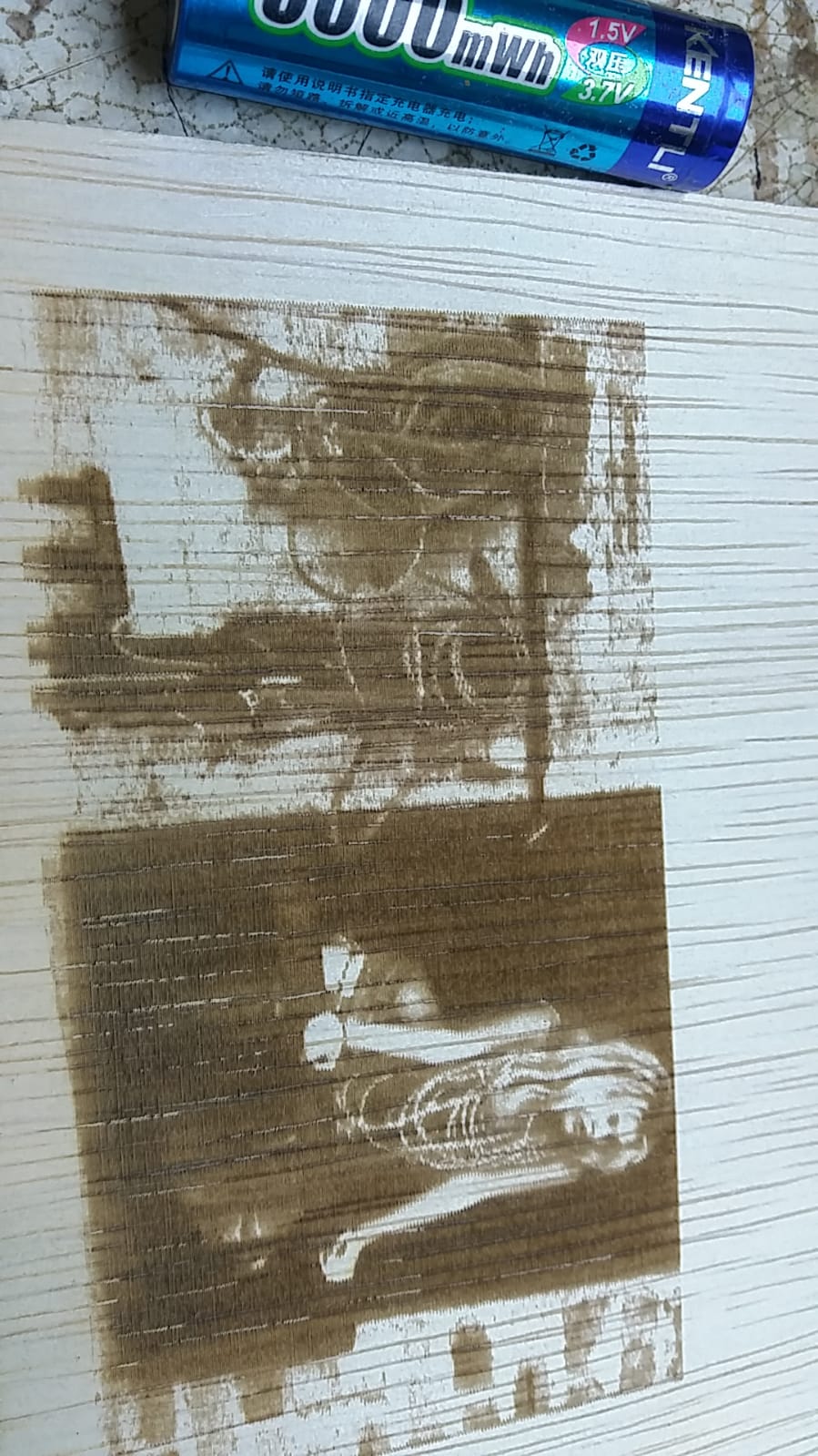

Hi
First new Auggie test .
Way better when you see what you doing.
And of course the sugar dont missing.
Bobby
Bobby

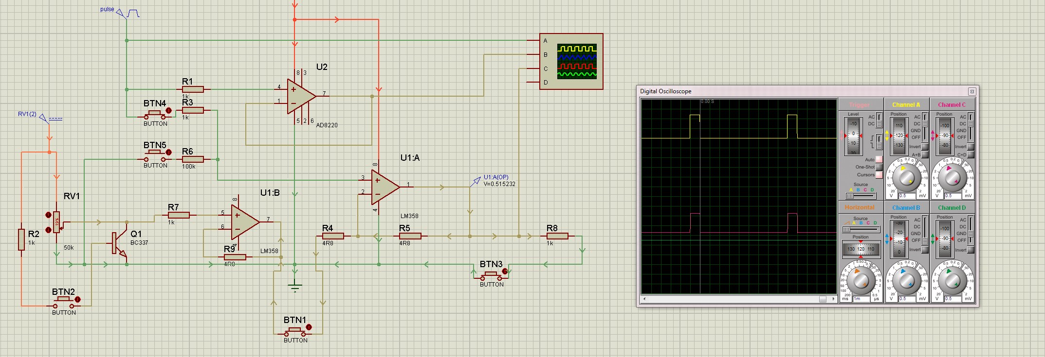

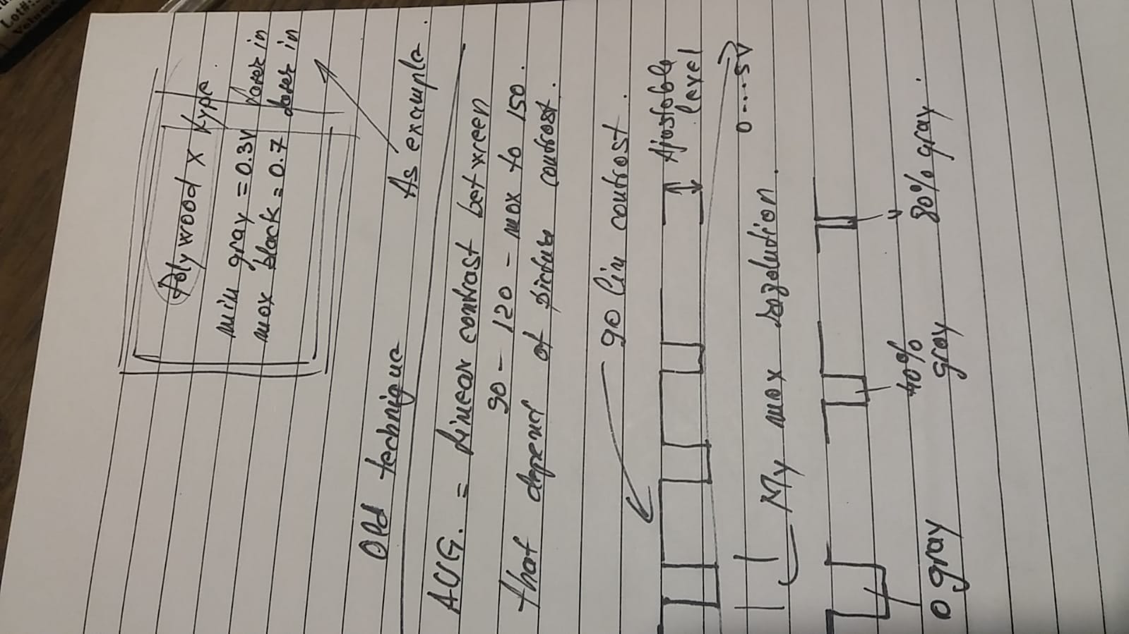

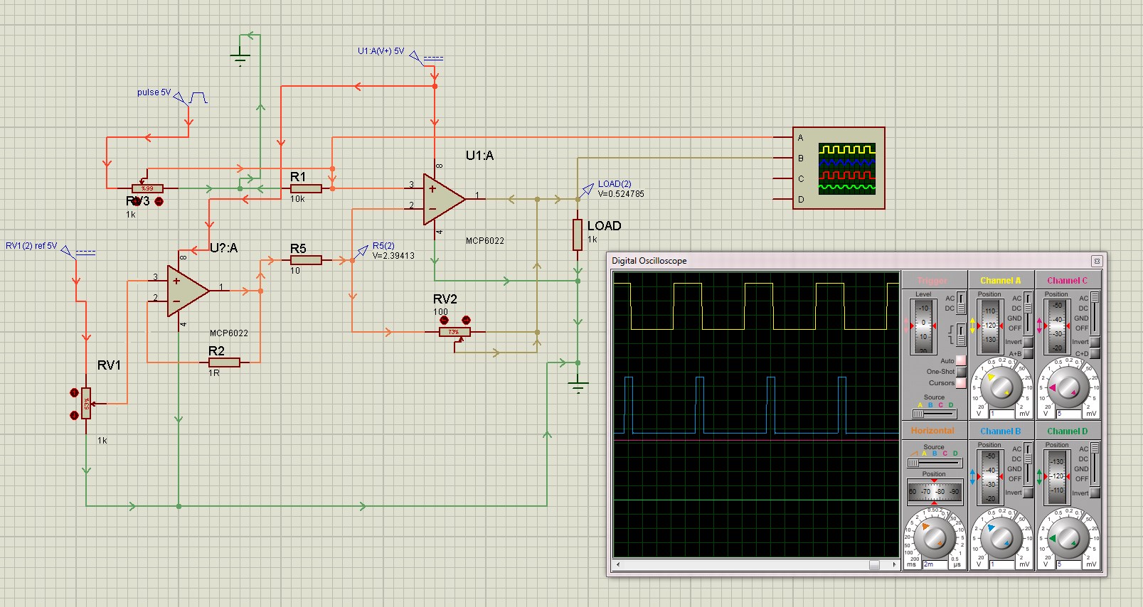

I resume all facts until now and i suppose i jump in a error without thinking is a error.
So , let me explain.
First off all if you remember i has a hard time with my very low impedance source and residual voltage input at 1.2v or something.
Well i fix that and starting to develop different interfaces i end from high end PWM to DAc converters to banaly MCP or LM324 OP.
Work good so fare but when i develop all that stuf i do it blind in FR without even have a banal osciloscope. Back home i have everything i need.
So i start measuring everything and i found the issue.
Here we talk of 3 different solutions to control the analog laser input.
1: My solution was to made the PWM between 0-800mv and find the laser trigger point by linear contrast in auggie.
Not bad but the resolution is limited by any type of photo in different ways.I put below a paper to explain my old solution.
2: Is you solution. To reformat the signal with atmega help . Well not bad at all but after i made my own to testing i run in one
issue when i look closely with magnifier what happen on polywood. So i found a saw mark on the end of black parts and whyte parts
(at least that was very visible). So thinking why , i change my microcontroler to one with PLL and FRC up to 120MHz.
Was totaly wrong , that marks still exist and after some time i realize , doesn't matter how fast my processor is
he will always wait to measure the input signal to be able to give the out 50% signal or any division.
Is true it is some improvements , but when X go from 0 to 100 (as example) the delay will be in left side
and when the X will return the error will be in right side , at the end the little error will be *2.
I try it , and also i try to made a linear OP divider . The result is way better but not as i expect.
I put below a printsc from that.

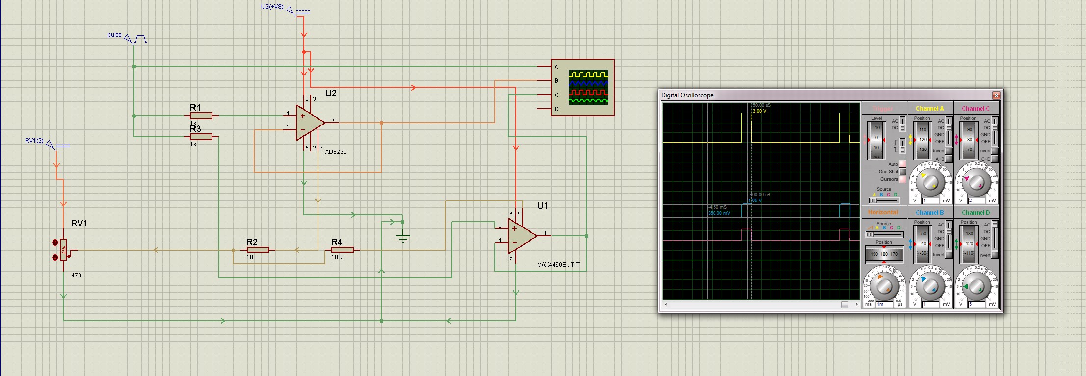

3: That is last one and i think is the best solution to have on any type of laser a full resolution between
black and white and also simple to be adjustable.
What i think is (as example ref). If the laser start to leave a mark on polywood from 300mv input and up to 700mv on max black
basicaly we need to have a 400mv PWM with +300mv offset . In that way the laser will be prepared to start burning
and the PWM will be in full black white resolution.
I put a printscr below on what i thing is the best way. Now i try to find a good OP with good adjustable offset

Hi.
Well can not sleep until to finish my idea .
I made fast with one Op LM358 was close to me.
I have some single supply rail to rail OP but can't find when i need it.
The PWM don't reach more than 2.45V but to engrave i need no more
than 700mv.
That is the vid with my old technique with linear contrast in AUGS.
https://youtu.be/k26aoKRzsGE
And this one with what i think is better result and at least standard for most
of wood materials.
https://youtu.be/vpEETVXhbrQ
The wave is not perfect , can see some ripple but i will move one to
AD8220 have built in reference offset.
That's for now , more test commin'
The first photo engraved like that , and very small size. Before was impossible to go
below 140mm W
Bobby
Bobby:
Your English is far better than my version of your native tongue.
I think I see what your speaking of. Your laser seems unusual in that its very
tight on control. All of mine are really end controlled by average voltage, but
its not close to your sensitivity. Your schematics seem to show a very close
tolerance to the voltage swing of the pwm. Synrads dont tend to be that
sensitive. They have a max of 20Khx and simply average the voltage
from a 1ms pwm to a range of perhaps 500 steps internally. It looks
from your circuitry that the power range you seek is very tight..and probably
specific to that laser.
I congratulate you though on your solution and experience, you really
tracked it well, I think you have tighter control than most.
I like your solution, the ability to test the actual range output was clever...
Good work.
Hi Art.ArtF wrote: Bobby:
Thanks for the kind words . Usual people correct me in not a nice way , but
i say to all " if they realy want , can correct me in my native language"
I'm Romanian , i speak very good Ru and Fr language , in my time english wasn't on
school . I run in it in my faculty , of course technical english , but still .
About my laser control , well i think is the source issue. Is very tight on small power
rise fast , and after decrease until 4.2V = 20mA. I dont use more than 10mA but
the control look like 30% logarithmic increase and after keep some linear shape.
Hard to tell without measure device on laser power.
I finish my interface , i solve that little noise on voltage offset (i was stupid , no any decoupling cap
and no small low pass to first AO input. I was tired. Is solved all .

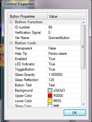

Hi
Well i think i found the issue.
I dont know if that's true but now working.
Becoming tired , i didn't pay to much attention and i become frustrated
in one point . Simple things made you crazy .I assume exist some order to
create that. I saw later after i delete everything and start over , soon you create
a button , will be assigned a variable for that. And that corespond to the ID of button.
My mistake, i was think i need to create my "own" variable , otherwise
the function don't make sense.
I modify that after i create , to be easy to find after.
I delete again , to start over :D :D.

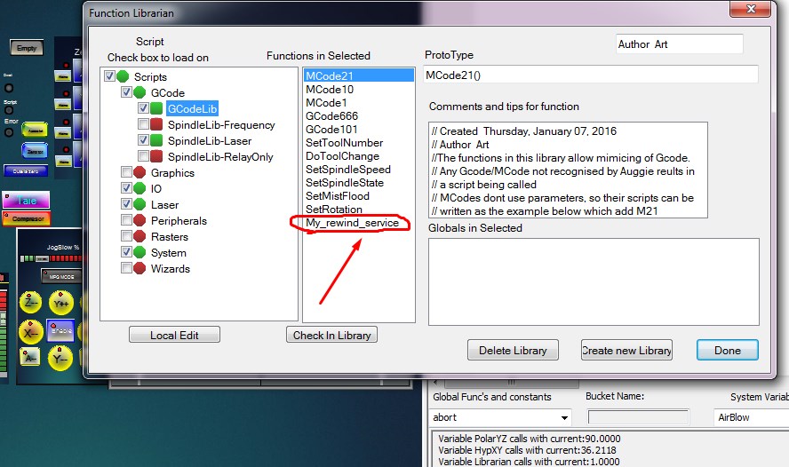

Now the big question . " how i can delete a variable from system "
even i comment the function , that remain in system.
I just comment right now , but seems that wont dissapear
after. And was some restarts , even on OP system. I put pic below.
Bobby
