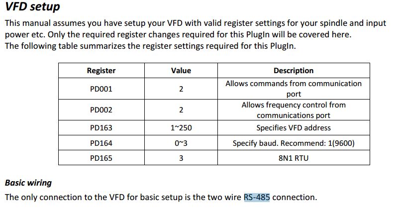

I tried my Huanyang VFD spindle controller and a 485 USB interface, and thou it connects I never found a way to control it with the hex data. I must be missing something here. The photo is the options I set. Are there others I missed? My spindle never started.
Can you provide your completed script? Thanks. Something I am missing or this controller is different than yours.

Posts: 152
Re: Functional overview
Post by Richard Cullin »
ya-nvr-no
that matches my settings , I have a few issues with windows changing the com port on me, every time I plug the adapter in its different port
pd165=3
pd164=1
pd163=1
if you call the &nbsp;GetVfdSpeed &nbsp;modified like this it will read the set freq , I call it from the &nbsp;m10 function when testing its wery handy and the spindle can remain still (quiet)
global GetVfdSpeed = function( )
&nbsp; &nbsp;CRC=0xffff;
&nbsp; &nbsp;vfd={1,4,3,0,0,0}; // will read set freq
&nbsp; &nbsp;...
you need to confirm the comms are working I here some vfd have missing rs485 chips
Last edited by Richard Cullin on Sun Jan 08, 2017 1:57 pm, edited 1 time in total.
