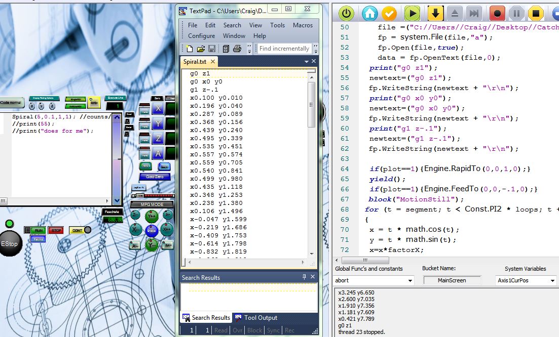

I read some concerns about scripting and motion directly from scripting.
Well why not open a file in the function and write to the file as formatted gcode?
after all its just math and numbers all doing the same thing.
What do you think a Post Processors does ???
So there is no reason not to create functions that can give us unique shapes and post the data out to your gcode read only controller.
Embrace scripting as a new vehicle to give you a new creative tool.
PS: This was my crude way to do it but it shows that its an easy process.
I'd like to see a function created, we just pass the positional data too and it writes the Gcode.
that way ever function can use the same GCodeOut() function

Code: Select all
g0 z1
g0 x0 y0
g1 z-.1
x0.100 y0.010
x0.196 y0.040
x0.287 y0.089
x0.368 y0.156
x0.439 y0.240
x0.495 y0.339
x0.535 y0.451
x0.557 y0.574
x0.559 y0.705
x0.540 y0.841
x0.499 y0.980
x0.435 y1.118
x0.348 y1.253
x0.238 y1.380
x0.106 y1.496
x-0.047 y1.599
x-0.219 y1.686
x-0.409 y1.753
x-0.614 y1.798
x-0.832 y1.819
x-1.060 y1.813
x-1.295 y1.779
x-1.532 y1.715
x-1.770 y1.621
x-2.003 y1.496
x-2.228 y1.340
x-2.441 y1.154
x-2.638 y0.938
x-2.816 y0.694
x-2.970 y0.423
x-3.097 y0.129
x-3.195 y-0.187
x-3.259 y-0.521
x-3.287 y-0.869
x-3.278 y-1.228
x-3.228 y-1.593
x-3.138 y-1.960
x-3.006 y-2.325
x-2.831 y-2.682
x-2.615 y-3.027
x-2.357 y-3.355
x-2.059 y-3.661
x-1.723 y-3.940
x-1.352 y-4.187
x-0.949 y-4.399
x-0.516 y-4.571
x-0.058 y-4.700
x0.420 y-4.782
x0.914 y-4.814
x1.418 y-4.795
x1.928 y-4.722
x2.436 y-4.594
x2.938 y-4.411
x3.427 y-4.173
x3.898 y-3.880
x4.343 y-3.535
x4.758 y-3.139
x5.136 y-2.695
x5.472 y-2.206
x5.761 y-1.677
x5.998 y-1.111
x6.179 y-0.515
x6.299 y0.106
x6.356 y0.746
x6.348 y1.398
x6.272 y2.056
x6.126 y2.712
x5.912 y3.360
x5.629 y3.991
x5.277 y4.599
x4.860 y5.176
x4.380 y5.714
x3.840 y6.208
x3.245 y6.650
x2.600 y7.035
x1.910 y7.356
x1.181 y7.609
x0.421 y7.789
g0 z1
