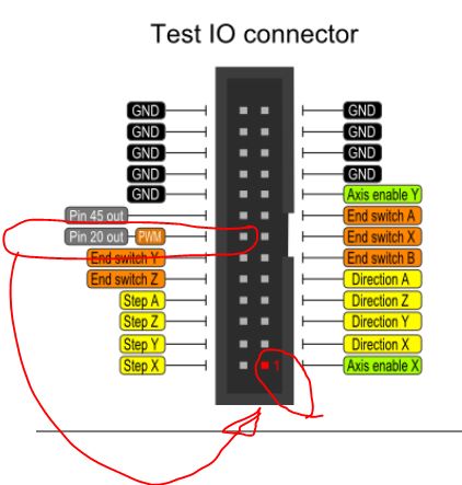

One more piece of data, ( because threads such as this exist for years and many tend to read them for info..)
The following photo shows the Pokeys57 revision 2 changed the PWM location on the TestIO connector. As indicated by the arrow..

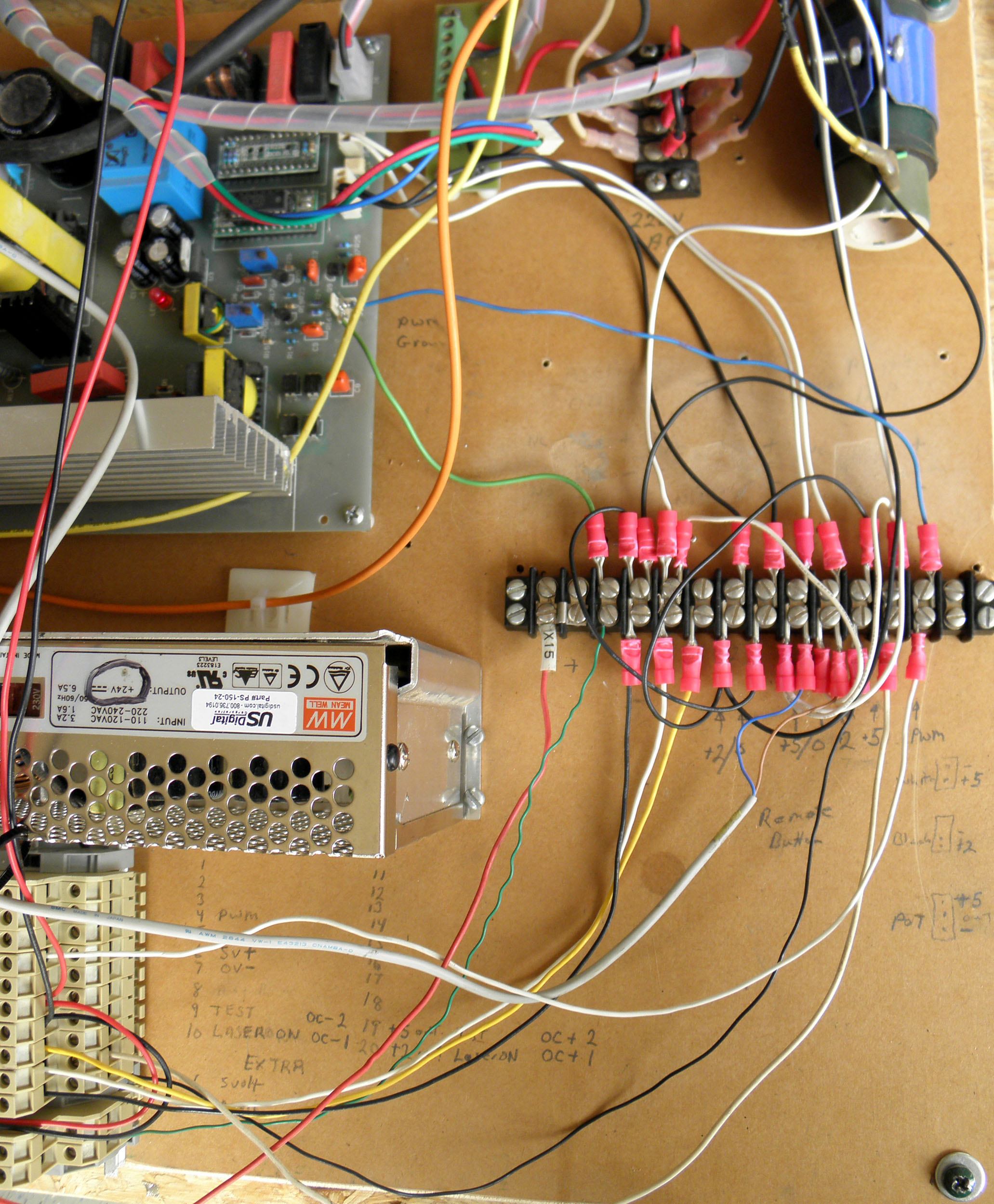

Here is a view of my wiring on the laser board, I tried to label the connections, but it turned out to be quite straight forward. That is other than the pot plug had to be removed for the pokies pwm to control it.
In my case I used the OC's you just have to provide the OC+ with the voltage source from the buttons (note where the +/- are) and when the pokies turns on that OC it closes the contacts just as if I pushed the button. I wired them so I can still use the buttons in a manual mode. I also added a remote Test button so I can fire if i need to walk around. (not necessary but it makes it nice for laser/mirror alignments)
So hopefully you can see on one side I send the signal over "TO" the pokies thru a terminal block then the pokies is connected OC- "FROM' back thru the terminal block. (more that you follow the logic then using this hardware)
And then the pwm test connector art showed in my photo above was just connecting my choice (Pin22 PWM2) back to the center tap of the pot with a common ground from both laser and pokies boards.
In my case it takes about 2volts to start to fire the laser, somewhere around 42% on the pwm slider. And that's what lead to the scaling routine Art created for your particular requirement.
Safety Note: stay away from the left side of the board if testing with button or firing laser. Take my word for it ;)
its pretty straight forward and damn cool to see in action.

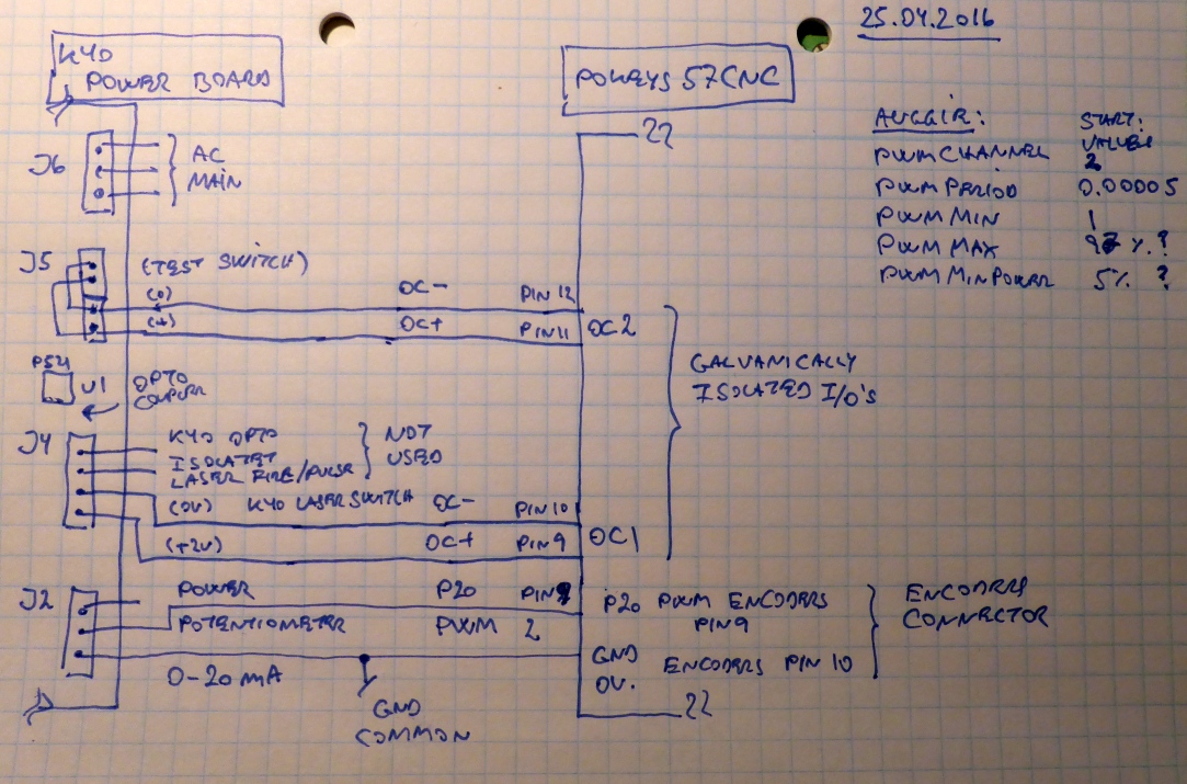

I have summed it up for my board and have made a sketch (only handmade).
1) The power is controlled with PWM 2 on Encoders pin 9 and GND on pin 10. (It is the same as DB-25 connector or Test IO connector but without the version confuse).
2) The Laser On/Off button is connected to OC1 on the Galvanically Isolated I/O.
3) The Laser Fire (Test Switch) is connected to OC2 on the Galvanically Isolated I/O.
This input bypasses the opto coupler on K40, but it makes sense as Pokeys has its own opto isolation and the delay will be less.
Ya-Nvr-No:
I made the drawing before I saw your post. Only difference i see is that we switched OC1 and OC2. I haven't made the physical changes yet so I will change to match your configuration.
What I don't understand is the PWM connection to the power pot. If I measure the voltage on the center pin it is about 1.22V. Switching it to ground will not give the correct voltage (0.9 - 3.5V) as the pot gives.
I will keep the manual switches as well - good idea.

Looks good. As to the pot, the center tap being connected to the pwm means it shoudl see from 0 - 5 as pwm goes up.
The 0volt line of the pot is connected to pokeys ground just to give it a referance for the pwm.. You do need to remove the pot
though. You sould then be able to measure form 0-5 volts as you slide the pwm slider on the pokeys software..
If so, your good to go, we're runnign tests, so we'll tell you what to look for as we find weaknesses in setting up..

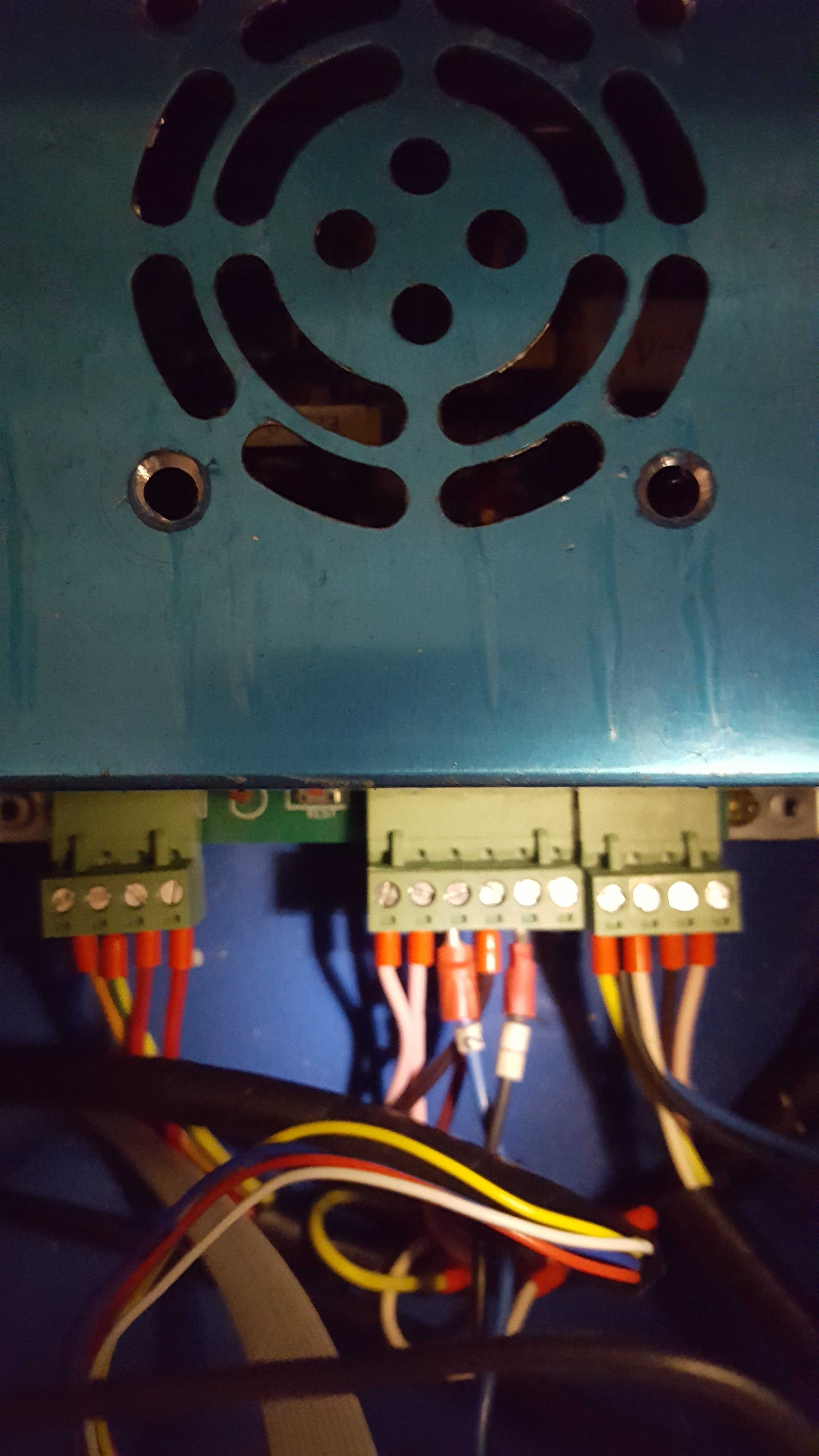

I only unhooked/hooked the TTL line and the PWN line (sorry for the dark blurry photo).
I did that to just test it out.
I still have to hook in the water pressure switch and a door switch but it runs.
I am pulling the 24v off of this power supply to run the Pokeys as well.
The blue wire labeled 2 goes to the Relay OC1
The black wire with the label is using Pin20 for PWM(PWM2). I have it run through a small 3.3v to 5v booster circuit.
I used encoder connector since it had a smaller foot print.
The bob I am using is shown as well.
I will post a picture, I got off of the google K40 site, over in the laser stories side.
It looks reasonable.
Glenn

I understand PWM 2 is not OC and will drive the laser power pin (as pot meter). I forgot that PWM 2 is a "normal" PWM.
Running latest Auggie 1.47(b) I get RT PWM on axis 8 and nice PWM signal on Encoder pin 9 (PWM 2) when pressing the fire button.
