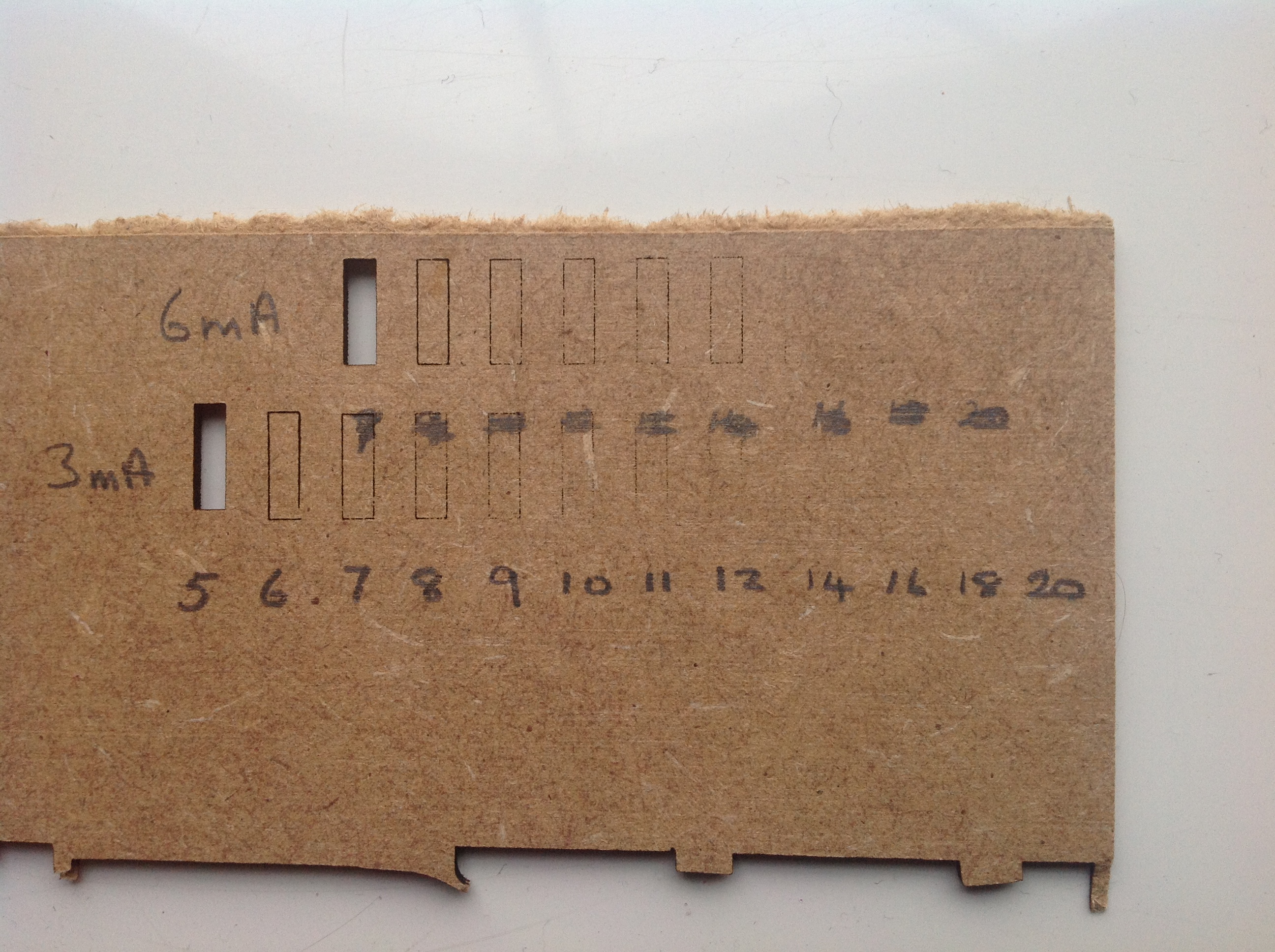

Re: Variable laser power
Just ran a test while cutting 2mm MDF at 6mA and 3mA power settings at speeds from 20mm/s down to 5mm/s. I have attached a photo of the results as seen from the backside of the material. The 6mA is not a great improvement over the 3mA?
Seems to indicate a nonlinearity in power..
I would imagine that varies from system to system and power supply to power supply..
It will be interesting to see similar tests over various systems. I could be all wrong as to
how they react generally, I have only 2 that Ive cut with.. but they seem more linear that
that. 6ma still seems low though, what does it do at 15ma? do things get more linear as
power goes up?
Thx for the examples, interesting results.

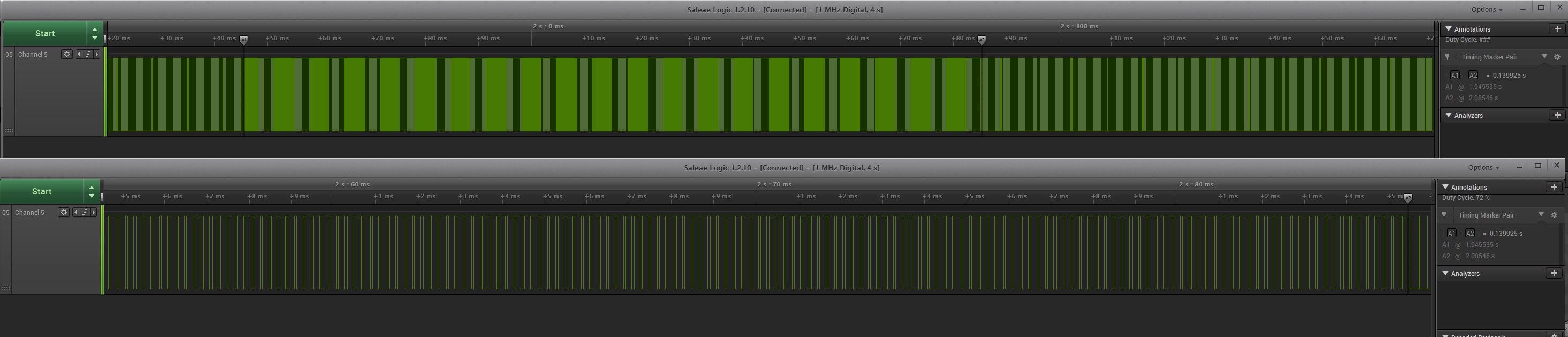

- Posts: 152
screen shot of salea logic analyser measuring fire pulse
bottom trace is zoome in a bit to show duty cycle better
fire time set to 200mS power 72% result 139mS of pwm @72%
Richard:
Hmm, that one is new. I just used testfireing this week to retest power, it did a good 38 second run at 38000 in the timer.
Im trying to think what could make that variable.. its hard to imagine as its coded to the tick timer..
I did have trouble last week with a system that hadnt been booted in quite a while so the tick timer went negative, I wasnt
checking for the upper bit to toggle. Can you reboot and see if the fire test works properly. When the time runs out, does the led go off as well or does the laser just stop firing? ( Like if you do a 10 second test, does the led stay on for 10 seconds on the firing panel?)

- Posts: 152
rebooted and tried again ,set time 1000mS power 72.7%
result 141.981 mS of 72% pwm
- Posts: 152
tried another pc , same result.
did notice the first test after a boot did for a 10 seconds test did fire led for 10 sec , all subsequent tests fail time wise
