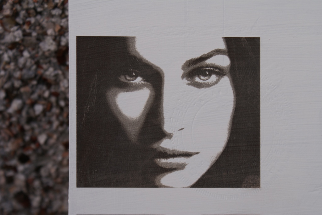

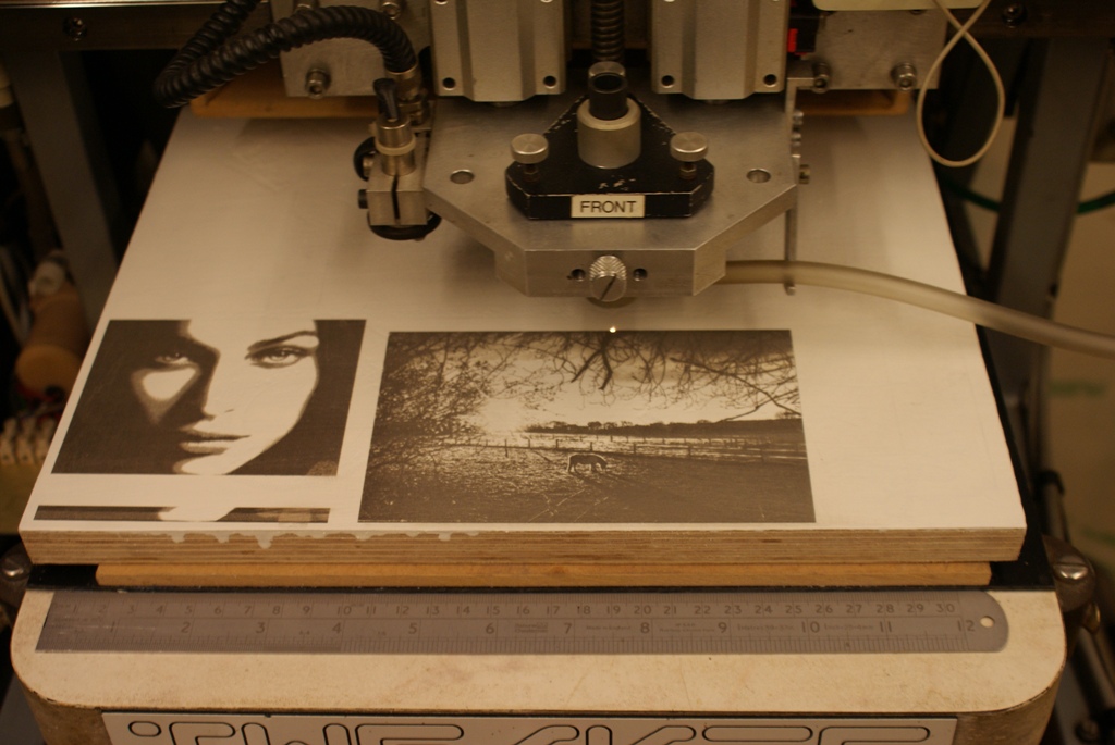

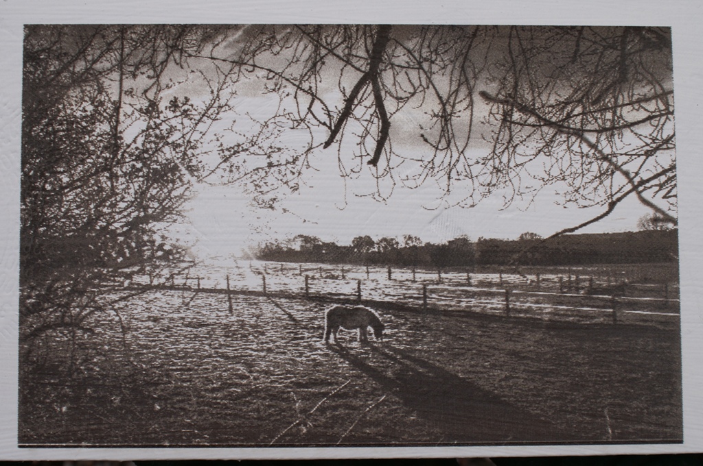

This is just a scrap piece of ply which has been painted white. Interesting that this paint has just two tones (plus the base white). Does all white paint have just two (or perhaps 3) tones I wonder ?
I get the same results from white melamine coated chipboard. I suspect its
a type of plastic that's in most paints and seems to go from white to charred
very quickly.
You can see in a grey scale print that it actually can do a range of about 5 steps
in my tests that are readily identifiable. Not much range compared to raw wood.
