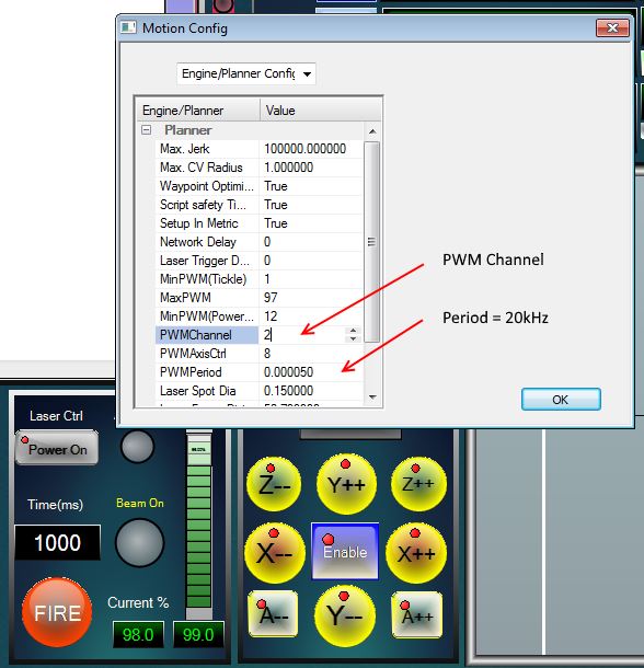

I my setup, the laser power slider and S word is controlling PWM #2. That is the way I configured it.
Replacing PWM #4 back with the potentiometer will engrave using the output on PWM #2.

The other K40 was the one run by YaNvrNo. There he has the TTL gounded, and uses the PWM only into the place the analogue pot went.
Yes, he sets it to 20Khz, the TTL simply gets grounded. It is fast enough for the engravings he shows on the forum so it seems plenty fast.
The other channels will work, but cannot be changed during realtime PWM mode. This is because setting the PWM duty causes a reset which can cause a false fire signal. As a result, all PWM commands are locked out during realtime PWM active mode. In the case of a laser,

I am also running as YaNvrNo on my K40.

Re: M3 blocks changing PoKeys PWM
Art:
Thank you for explaining the inner workings of the power supply and CO[sub]2[/sub] gas lasers. I sounds right to me!
High voltage in transformers can only be generated with an AC input or pulses, as we know it from switch mode power supplies.
The voltage and current on one side of the transformer is proportional with voltage and current on the other side. That make sense if the current control is handles with PWM or pulse frequency modulation (pulse length constant) internally in the power supply.
If we send a PWM signal to the current control pin, it takes over the job of setting the current for the power supply, bypassing it to the transformer - could be confirmed by connecting an oscilloscope on the primary winding of the transformer.
Having the TTL as an on/off gate seems as the most logical way to have the supply to work both in "DC" and PWM mode.
I see the trouble in my current configuration, pulsing TTL and having a DC value on the potentiometer input. That input voltage is internally converted to a "unknown" frequency / pulse modulation to feed to the transformer. At the same time I am chopping that signal through the gate (TTL) with a high PWM frequency to turn the laser beam on/off.
These two frequencies are mixed and may give unexpected end results...
It is like driving both inputs with PWM signals, and one of them is unknown.
For now, I will keep the analog input from the potentiometer and see if it gives trouble. Just received the ordered 6N136 fast optocouplers from eBay, I was planing to use at the potentiometer input. They could now come in use :)
As I remember, both GlennD and YaNvrNo are switching the potentiomenter input between 0 and 5V, not between the two other inputs from the potentiometer plug.
This is important as the PWM signal must be limited to avoid burning the tube with too much current.
Earlier I have measured that the DC on that input must not exceed 3.5V (15 mA).
I found this technical article on CO[sub]2[/sub] lasers http://www.repairfaq.org/sam/laserco2.htm by Samuel M. Goldwasser. Be aware it is technical, but it answers a lot of questions on how CO[sub]2[/sub] lasers work.
It helps a lot, having an good inner model of the workings...
Joakim
Hi J:
>>These two frequencies are mixed and may give unexpected end results.. .
Yes, this was my problem with it, using 2 PWMs would seem to have a sync problem, though it still works..
>>For now, I will keep the analog input from the potentiom eter and see if it gives trouble. Just received the ordered 6N136 fast optocoupl >>ers from eBay, I was planing to use at the potentiom eter input.
Sounds good.
>>As I remember, both GlennD and YaNvrNo are switching the potentiom enter input between 0 and 5V, not between the two other inputs from the potentiometer plug. This is important as the PWM signal must be limited to avoid burning the tube with too much current.
True, the average DC shouldne exceed a set alue, though 15ms is low, Id suspect 20ma is more reasonable an upper limit for a K40.
Feeding the analog input with 5 volt PWM is fine, youd just need to not exceed the duty cycle where the voltage averages that 3.5-4 volts..
A much safer way is to use the PWM of the pokeys to fire a transistor as Glen does, where you could feed the pot voltage to the transistor so that 100% PWM is only 3.5Volts average DC, thus keeping current to within limits. Some have claimed the pot voltage
imput is too slow, but tests on YaNvrNo's show that to be untrue, he runs at 20Khz on the pot input line, 0-5voltPWM, and
has done engravings that show timing isnt an issue. It IS possible to tell Auggie with MaxPWM to limit the current anyway, if set to 80% for example, the DC voltage on the pot input will never exceed 4 volts , so the current is properly limited.
Most of your tests in the K40 have been done on that setupo, using PWMMin and PWMMax to find the best range for his K40,
which we find fires at about 50% PWM, with no radiation below that value with TTL jumpered to ground.
This isnt totally unusual, my Chinese laser fires at 17%, with nothing below that.. point is though, that the analogue input line
seems plenty fast enough to control on/off as well as power simultaneously, though TTL is a fine way to do it as well, it all
goes to show the flexability of a K40, it can be run in many ways, and they all seem to give pretty good performance..
I appreciate your feedback, Ill bet its ready many times over the next few years by K40 users looking for data on hooking
their units to software of any kind.. Its hard information to find.. I know, Ive looked. :)
