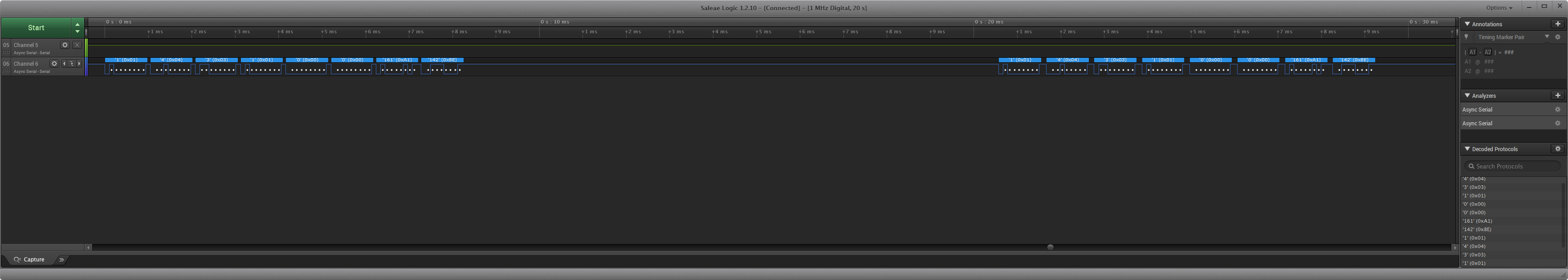

first try at getting some data back from vfd ,although the the vfd accepts the cmd and replies accordingly
myser.ReadData( 8 ) returns nothing &nbsp;:-\
[the vfd takes at least 8mS to reply] see &nbsp;pic for &nbsp;cmd and response
