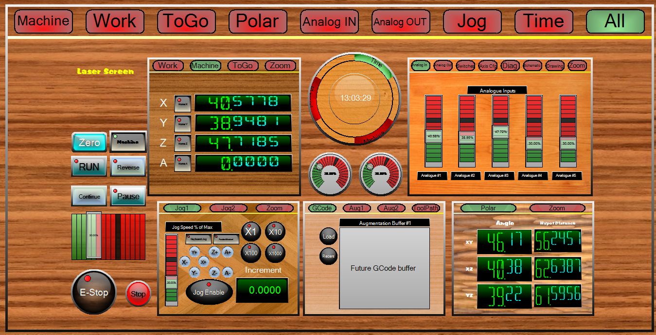

shows how you can take a whole screen and make a panel out of it and they all can still interact with a little script editing.
(changed Main to Default2)
Main was my initial screens, main panel name and Default2 was the screen name, save it as a panel and it is now the Default2 panel
Video also shows the ability to use a button as a toggle to set states.
Getting ether the Work or Machine Coords and creating the vectors from the axis DRO's
Note: at this time i am just using the sliders to drive the dros for ease and to show response.
I can assure you this is a snap to grasp and fun to play with. I can envision screens with tabs of wizards. Create your wizard write the script to control it, then share the wizard and script as a panel set with others. Someone includes it in their screen and refines it and passes it back as a new updated panel.
This is the easiest possible control interface ever created to use. and I would bet $$$ this will keep getting better. You don't have to do CNC, you could create a screen or panel to calculate and balance your checkbook or keep track of inventory or you name it. It's just a graphical tool to display the data in the scripts or in do time a motion controller or an I/O board. And you can make it as pretty or sinister as you desire with your own graphic files.

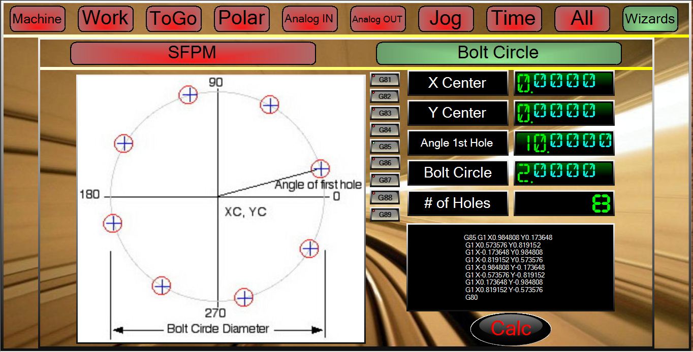

Re: Auggie Early posts
Roughing in a Bolt Circle Wizard
Code: Select all
global BoltCircle_BUT0 = function( current )
local a = {Interface("BoltCircle_BUT1").curr,
Interface("BoltCircle_BUT2").curr,
Interface("BoltCircle_BUT3").curr,
Interface("BoltCircle_BUT4").curr,
Interface("BoltCircle_BUT5").curr,
Interface("BoltCircle_BUT6").curr,
Interface("BoltCircle_BUT7").curr,
Interface("BoltCircle_BUT8").curr,
Interface("BoltCircle_BUT9").curr};
local Gcode ="g80";
for( i = 0; i < 10; i=i+1)
if (a[i]== true )
Gcode = Interface("BoltCircle_BUT"+(i+1)).text;
local x_center = A.CtrlGet("BoltCircle_DRO0");
local y_center = A.CtrlGet("BoltCircle_DRO1");
local StartAngle = A.CtrlGet("BoltCircle_DRO2");
local dia = A.CtrlGet("BoltCircle_DRO3");
local numberofholes = A.CtrlGet("BoltCircle_DRO4");
local PI = 3.14159265;
local stAngle = (PI / 180) * StartAngle;
local Xangle = cos(stAngle);
local Yangle = sin(stAngle);
local x = x_center + (dia / 2) * Xangle;
local y = y_center + (dia / 2) * Yangle;
local StepAng = (2 * PI) / numberofholes;
for( i = 0; i < numberofholes; i=i+1)
x = x_center + (dia / 2) * cos(stAngle + (StepAng * i));
y = y_center + (dia / 2) * sin(stAngle + (StepAng * i));
Gcode = Gcode + " G1 "+ "X"+x + " Y"+y + "\r\n";
Gcode = Gcode + " G80";
Interface("BoltCircle_LABEL1").text = Gcode;
return;
BoltCircle_BUT0();

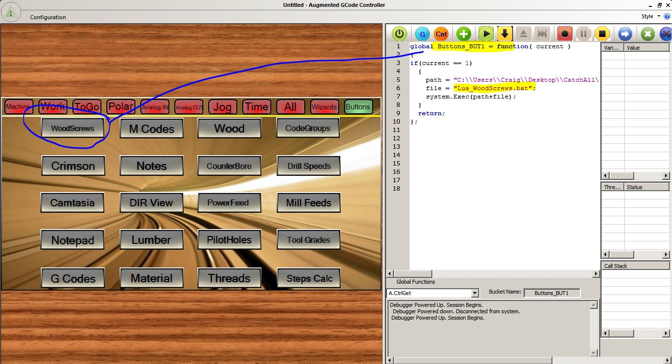

http://youtu.be/ZRhQN331na8
Video shows a created button panel calling Notepad and Lua scripts, and some additional control capabilities.
Here is an idea of an example function that gets data and computes a circular drilling hole pattern
