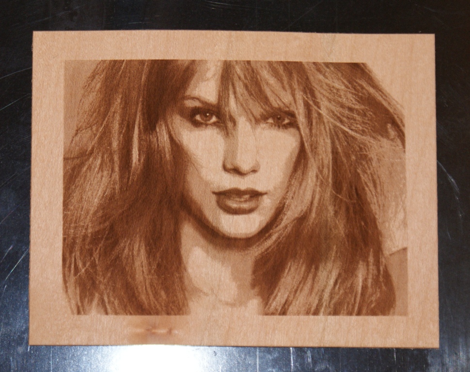

We have had a couple of days of snow here in the UK which just about brought everything to a standstill. As a country we seem to be just so unprepared for anything like this. I could not get any collections or deliveries and work was put on hold giving me the opportunity of more playtime with Auggie.  ;D
Tweakie:
  I think your getting my snow.
Here, we used to have a normal depth of a couple feet through
the winter, Ive yet to see more than an inch or so, and its gone in
a day.  I kinda like it.
Nice burn. Good grey scale. Im waiting for my theta lens, my galvos
are tuned up to speed, and Im looking forward to some test burns next
week to see just how a galvo with 50 watts on it can look..
Hopefully, I wont be disappointed, but if I am a firestar laser is a good
starting point for a conventional laser engraver.. :)
tweakie
Posts: 184
Post by tweakie »
I am sure you won?t be disappointed with your galvo performance but, with regard to greyscale, I will be very interested to learn just how speed affects the burn results (reaction time of the material to the laser action).
