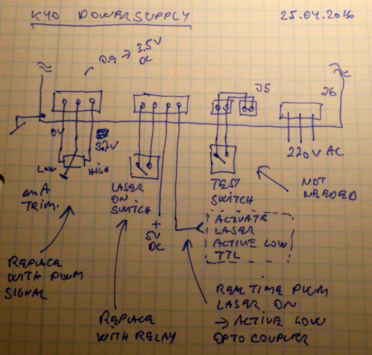

First - Auggie is an awesome program and has been on my wish list for a long time. Just the program for all us, who like to build experimental laser/CNC/3D machines (and hate the limitations on GCode ;)). Thank you Art!
Just to understand the new mode: Is the laser output power a function of time or speed?
Speed dependent mode could make life a lot easier, as the power output would only depend on how far we have traveled since last laser pulse => dept of cut would be independent on the speed.
On the K40 I get these annoying "holes" at vector starts when doing vector graphics and I have to go very fast to cut thin materials like paper... :(
- Joakim
(I have a K40 Chinese laser ready to be rebuild for Auggie (and PoKeys56) :) )

Re: Realtime PWM mode added.
Hi Joakim:
I think perhaps Ill explain the full theory of what Im doing here.. I think Ive hit that spot.:)
Forgive the length of this one...
The PWM control is set every ms ( while in motion), here is the way it works..
Normally, without considering power, motors are moved in 1ms way-points
from the jerk planners. There are two of them one for each set of 4 axis. That's
8 bytes of data for each ms, the byte varies from 0 ( no steps or system is motionless)
to 125 for that ms as that makes 125Khz the maximum speed. These control
speed bytes are constantly sent by Auggie to the pokeys, no matter what, as long as
your not in E stop mode , speed bytes are sent continuously.
What Pokeys has done for me, is change the meaning of the byte for
any axis I declare to a number from 0-100 as duty cycle for the PWM. This means
you trade any of the extra 4 axis ( 5,6,7,or 8) for pwm control of the laser.
You can trade another ( or 2) for use as an index-able conveyors, spindles..whatever..
What that means in implementation, is that I will control that byte to
set power based on a few things. Speed, acceleration, and power requested,
I will make averaging algorithms to spread the power as a "Joules per mm"
setting rather than joules per second.
This has a very nice feature, it means if speed is zero, power is as well,
so laser power is ensured to be off when not moving, and power goes
higher the faster you move. Auggie will calculate ( with user assistance
by selection of options, ) how much power per mm, and what kind
of correction function to apply for acceleration periods. Lasers are
very often nonlinear in their output, so my initial thought is to add
visual calibrations, so a matrix of small engravings on a test board
to quantify that lasers linearity ( or non-linearity) visually by selection
of "which of the following 10 is smoothest", or "which of the following
has the best grey scale " or ..whatever.. I suspect between those
of us who join in we can come up with what are basically test patterns
from which you will selected the items that represent your systems ability to cope
with the various nonlinearities in its operation, you will then apply
correction filters to that profile to make that laser operate as closely as
it can to other lasers running the same program. My current thought
is to make a high order polynomial to represent your particular lasers
response function as a result of several multiple answer questions based
on small quick repetitive cuts with different curves till an algorithm
can compute the best matching intersection of test pattern responce.
Because of the (no-motion = no laser) property, ( I loved this
in Darwin's Laser mode), when you turn on the laser with
the "Laser on " button, nothing happens. If you jog or do any feedrate
move while in that mode, the laser runs only for that motion, and the
power is adjusted during accel and decel to attempt to make even a
slowly accelerated line as linear as possible in power.
Now, its not possible to do this with perfection, I admit this up front,
but until we actually make calibration and correction tables and bezier
curves of power profiles to match up our systems, we just wont know
how close we can get. But as far as I know this has never been done in
the way I envision it, so...I gotta try. :)

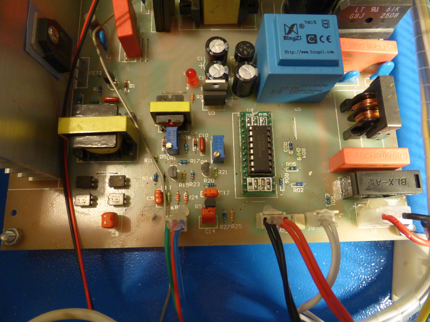

Some time has gone... and I am finally ready... :D
The K40 is rewired, motors are running X and Y (Ethernet requires 0 in delay in my config).
Reading forum posts, seeing videos and playing with Auggie, I am still not sure, how to connect the fire pin on the laser power supply to PoKeys57CNC to get real time PWM. Is it the Step/Dir on axis 8 or some other PWM pin?

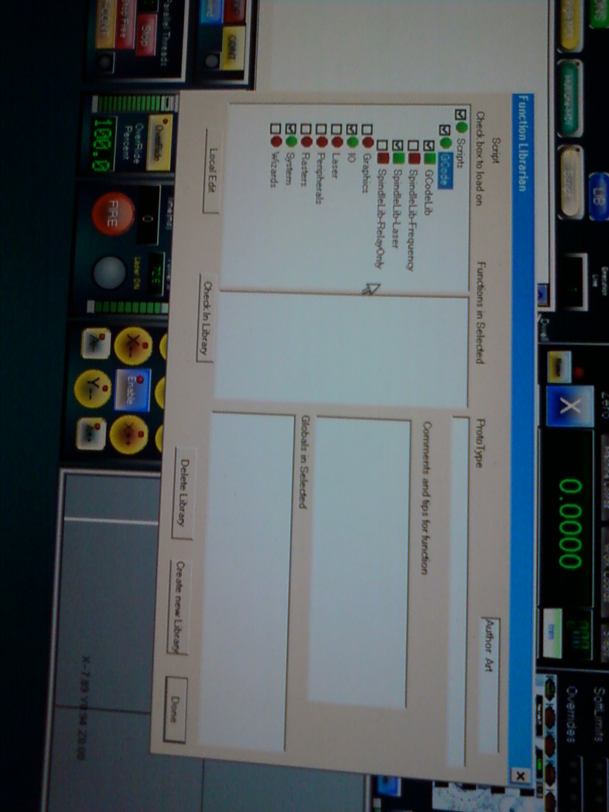

Hi Joakim:
YaNrNo is just hooking his up too, so we'll have more info shortly...
But as to what to do.. Turn on the laser Spindle Library, (Turn off any others..).
You have to edit that library file by checking it out in the debugger and editing the PWM
number to use. Generally, youll use two signals depending on the laser power supply.
Most have "LaserOn" or "TTL" as the first, and PWM as the second. What you need to feed each depends on
the power supply. Some, simply leave the TTL float , ( which enables the power supply), and feed PWM into the
PWM input, this works fine. Others need to pull the TTL input high or low to enable the laser. I use relay #1 to
turn on my laser supply. You need to know what it takes turn on the TTL or LaserOn input. Wire up Relay1
to do that , and it should turn on or off with the "LaserOn" button on the main GUI beside spindle speed.
The theory here is we enable the supply with that button, recoding the button script to turn on some
other relay or pin if required. Once on, the laser doesnt shoot because PWM will be at 1%
( or whatever PWM minimum is set to.). So long as the laser on button is active, the laser supply will be live.
The PWM stays at PWMMin unless commanded, and it wont turn on without M3 being in effect. The SetSpindleState
function in the laserSpindle library controls this from variables at the top.
global LaserAxis = p.GetInt("Axis",8);
global LaserMaxPower = 100; //max power = 100%
global LaserPWMPeriod = p.GetFloat("Period",.0002); //for 5khz tickle
global LaserPWMChannel = p.GetInt("Channel",4);
I wouldnt change LaserAxis, leave it 8 for now, I need to add some config changes to allow it to be changed,
but you may change the LaserPWMPeriod and LaserPWMPeriod to use whatever channel and period you like.
Its set for 5khz.. but if you need 20khz for a glass co2.. change it to look like this..
global LaserPWMPeriod = .00005; //for 20khz period
global LaserPWMChannel = 4; //for channel 4
Just change those last 2 if you need to. You will typically hook the Pokeys 0 volt to the 0volt terminal,
and the pwm channel to the PWM input..
We're working on this now, so within a few days Ill post more about how this works with hv lasers,
Ill have to issue an update as I just added scaling for lasers that dont turn on till they hit a
minimum limit.. Dan has his working so perhaps he can kick in on how he wired his as well.

Dont change any script, I have added selection of PWMPeriod, channel and axis into the main planner config. Ill update tomorrow..
Update:
Great, I will wait with script changes.
My power supply is a real Chinese Style, open and have few markings on it. Earlier I did some measurements and wire following to get a schematics of the inner working (hand draft attached).
With Mach3 I had the laser fire working, attached to Z direction signal and it fires when pulled low.
The laser activation (Laser On) can be a relay simulating the switch I have today.
Laser power (mA) can be a PWM signal simulation a voltage between 0.9V and 3.5V - now it is a potentiometer 1k 2W.
Test switch will be in software (Auggie).
First test will be the real time PWM and get it working.
Laser On switch and mA control can follow when laser fire is working.
