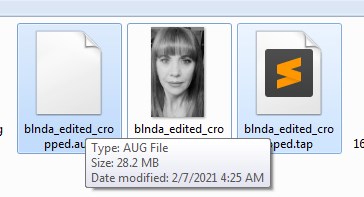

What i figure out is :
the .TAP file are line by line coordonates to engrave , nothing special
but Auggie generate a second file .AUG who store entire photo information like
all pixels " depends of size of you pic to engrave" and also the value of that pixel
in 8 bit " i think" . In time of laser travel , on each pixel the laser will fire
with the power equal with that pixel value. I assume Art limit the pixel value at 100
or made the conversion 1*100/256 because pokeys will know only 0 to 100 . He know how is programmed.
If you will see , on any pic the .AUG file will have different size in close relation
with the pic size.
I can not tell how .AUG file are encoded , only Art know that and can be any language , even one
invented by him.
But the principle i think is not different . Art can correct me where i'm wrong . I'm a user like you are :)

All True. And good explanation. Auggie has a pixel data for each pixel and scales it from 0 -100.
Then a formula is applied. Output = (PixelValue * ( current feedrate / commanded feedrate))) * (power/100);
If the current coordinate is not over a pixel, the PixelValue is zero.
Your PWM gets a command from 0 - 100, which gives you a PWM output. The voltage is actually always 5 volts during
on time and the frequency is always 400hz if set for that. But the average voltage is then 5vdc * ( OUTPUT/100);
So if 50% is commanded, you should have 2.5volts.
Most laser are full power on the PWM input when its 5vdc and go from there to zero. Many , like my sinrad need 1% as a tickle
voltage. It turns the laser on for 1-4us at 2khz which is my base PWM frequency.

Bobby:
Yes, that is correct. The system uses the # of motor steps as compared to photo size.
So the pixel to be burned is (((currentpositionSteps - startofimageSteps) / length of image in Steps) * #ofpixelsinline)
as to what pixel will be used for power.
Power will then be (Current1msspeed / FullFeedrate1msStepRate) * (powerslider% or spindleRate%) = PWM%
This is done every 1ms as to position and power. You can literally make sine waves over an image
and only the image will burn , and in a sinewave raster.
