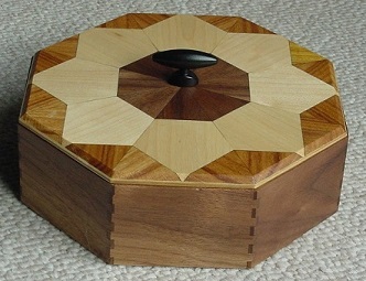

I did one of those some years back, but I used a different joinery method. I cut box joints, cut off the ends of the fingers at 45 degrees (I used a disk sander), and glued it up. After glue-up, there was another nub sticking out from each finger to trim off.
"Bevel box joint" is probably as good a description as you're going to find for it...let's see if this drawing makes more sense, looking down from the top edge:
