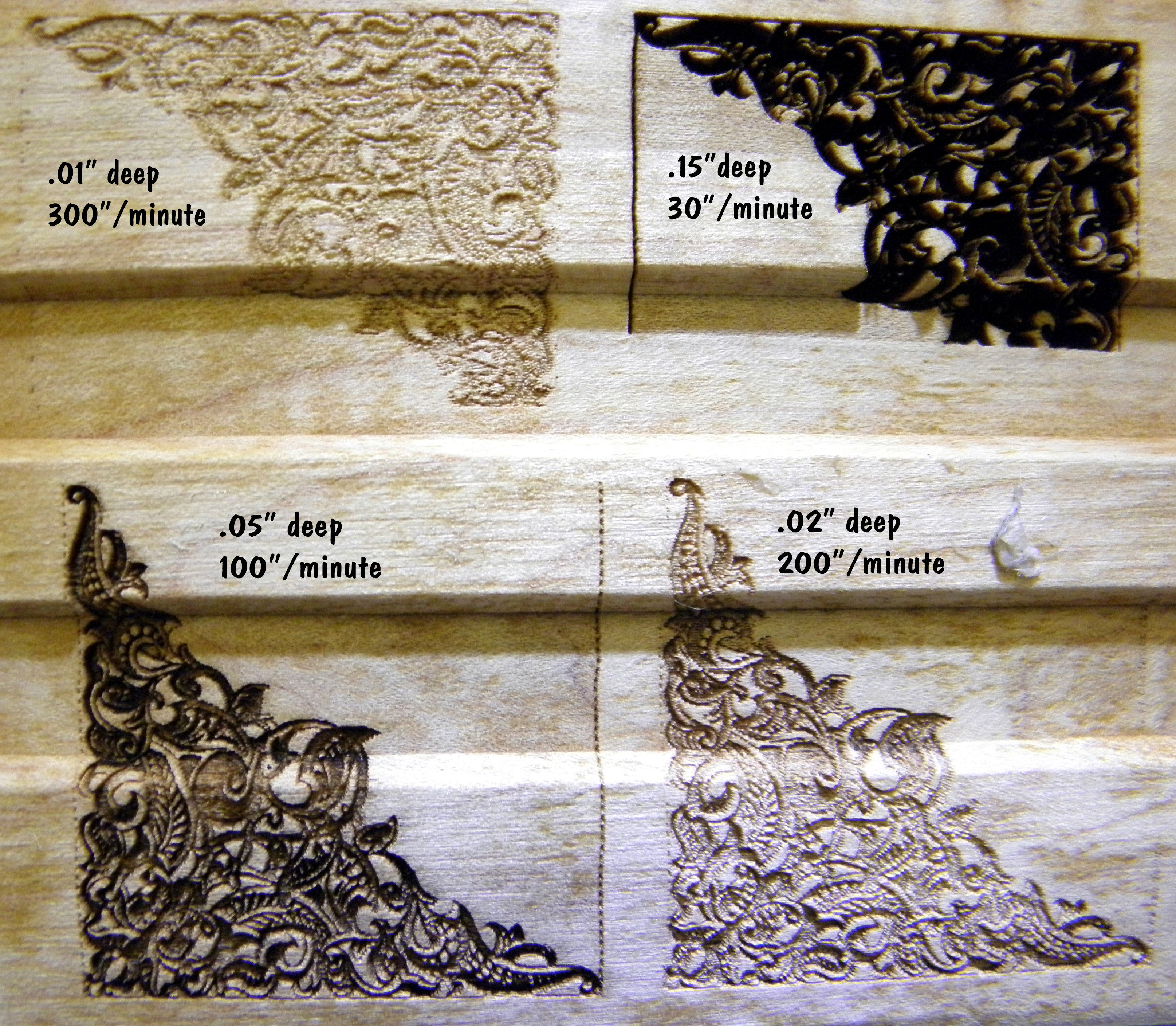

Did some raster testing today in Hard Maple (I use samples from the big box stores)
K40 Tube
2-5 volts firing using a modified circuit like glenn provided, (the 5volt supply is dedicated, not from pokies, found it only provided 4 max during firing)
min 50 max 97
Pin20 / PWM2
100% power setting
my preference is the lower left, but at least now have a range to fine tune.
might be closer to 90"/minute for me, as id like a little more depth for this material.

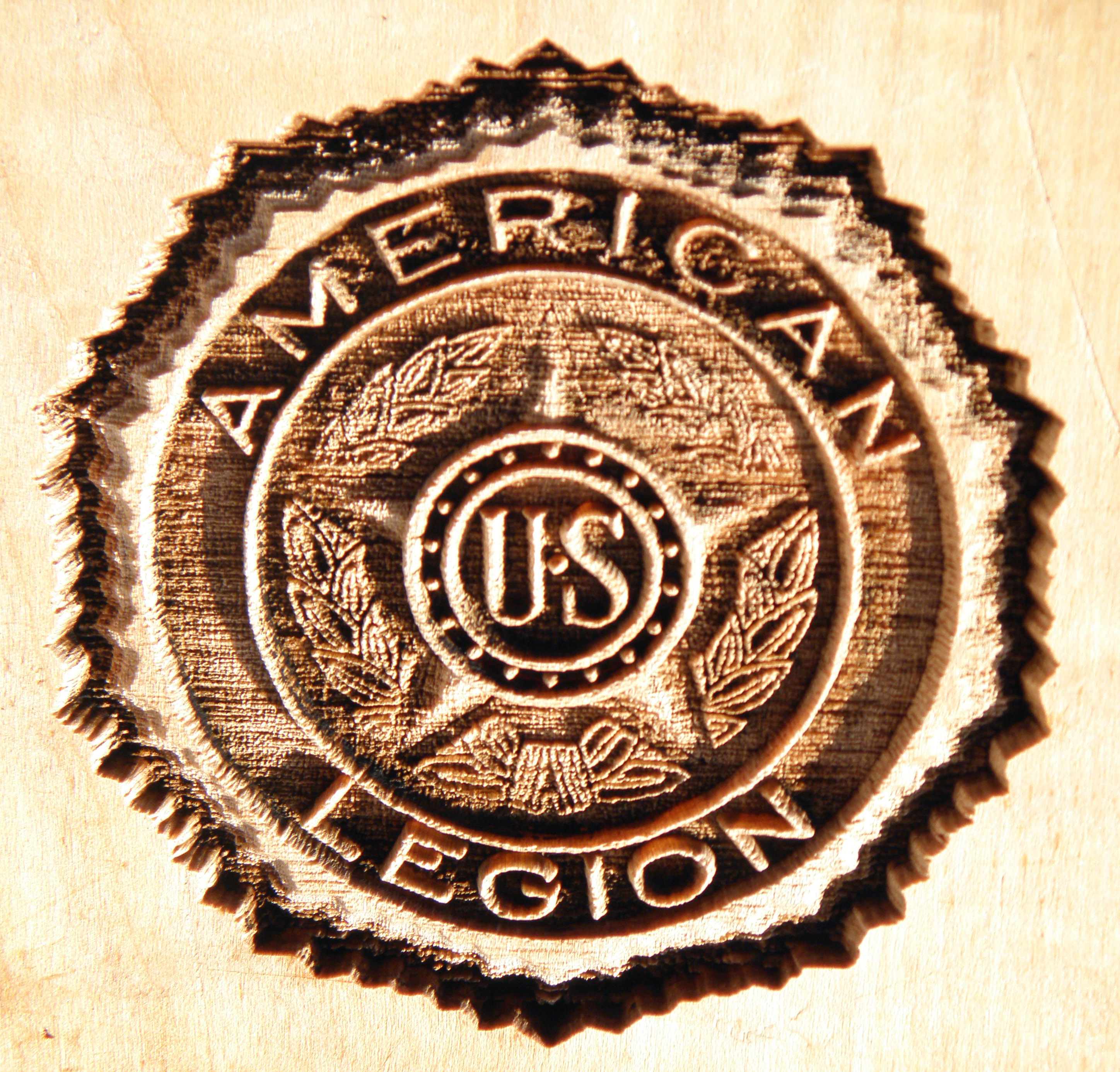

200"/min 90% power
46min 95max
3 passes step down of .03" each pass
3" diameter in Hard Maple
best i can measure on the outside edges is 0.171" deep (so my overall burn was more than i calculated for)
more testing till i find the sweet spots.
total time: I estimate at just over an hour total (I was so impressed, forgot to check timer)

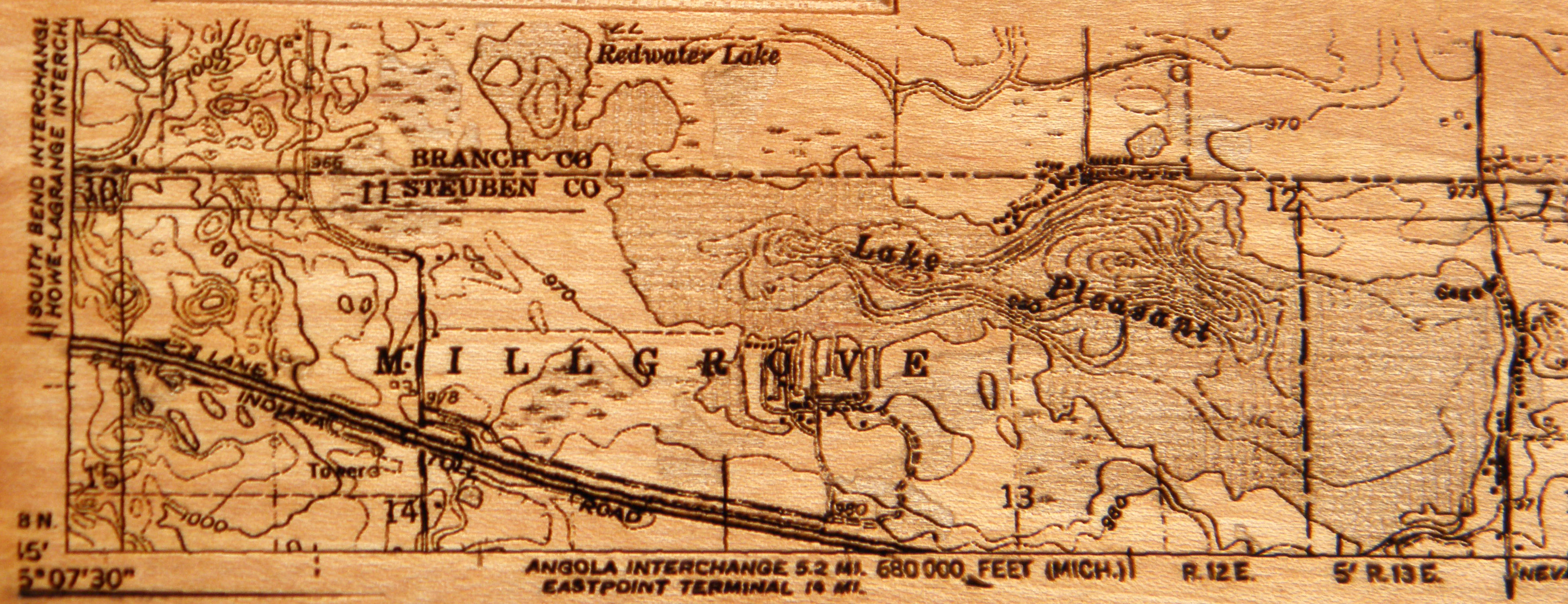

16" x 13" map
testing on clear acrylic, mirrored image from back .008" deep
and then test burning thru three different foams, the black is 55mm thick.
