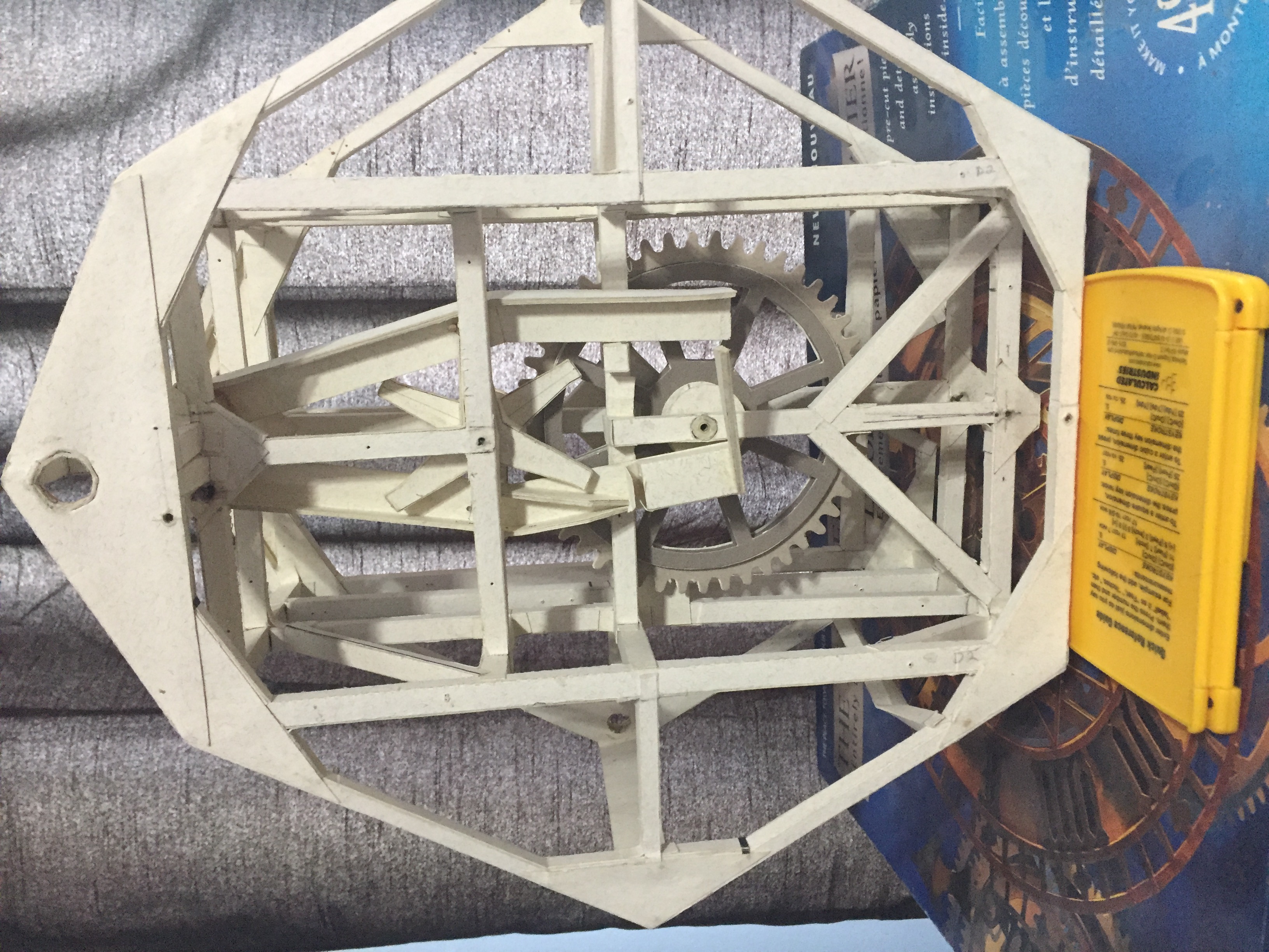

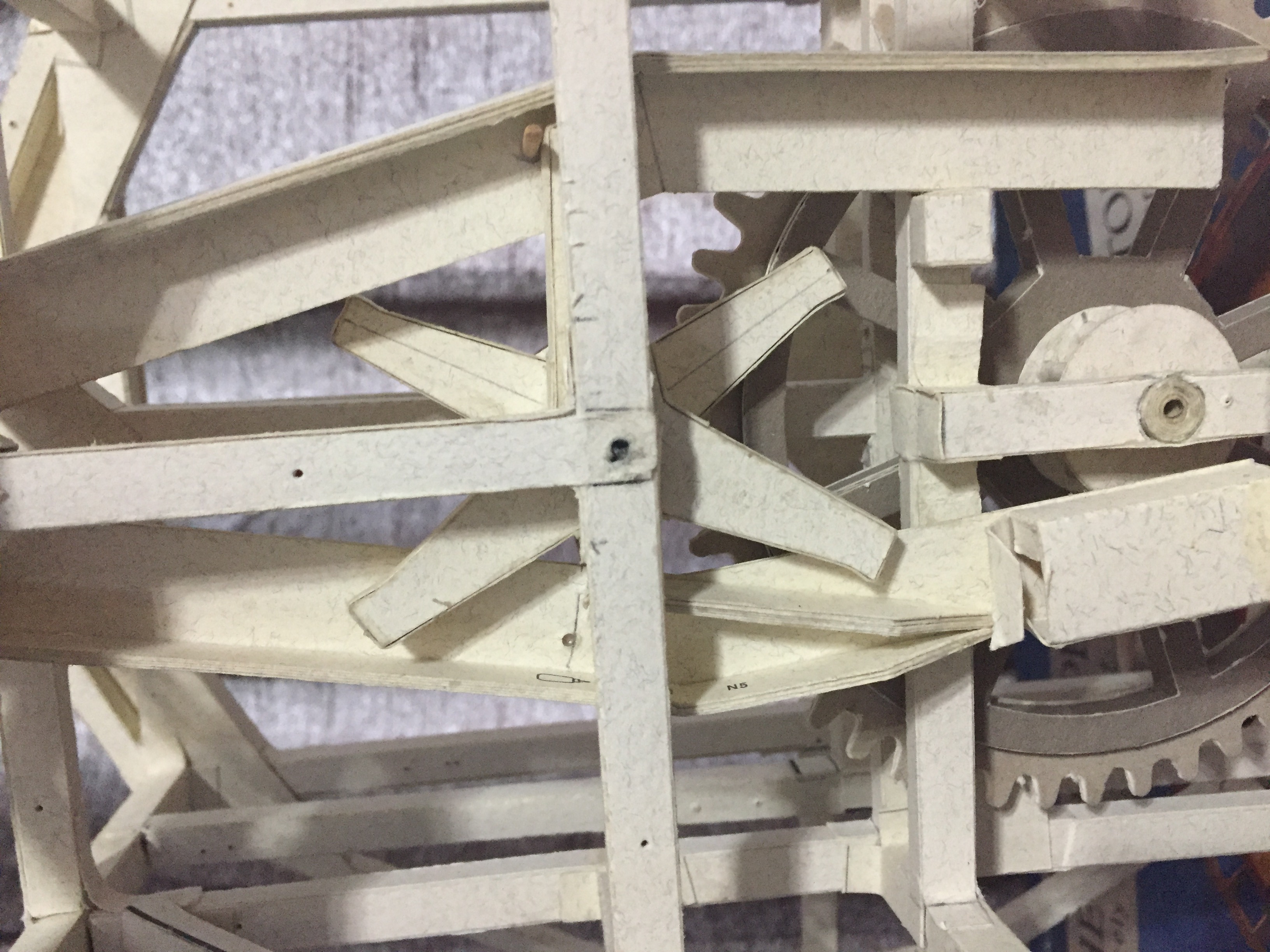

Re: Simulation of Denison double 3-arm gravity escapement
Good Morning Bill, Art,
I was going through the forum this morning and came across your post and remembered that many,many years ago I build a clock made completely out of paper. It uses, I believe, is the same escapement as you are describing. It doesn't use a spring but rather a small paper box that I filled with sand (as a weight) . when the pendulum pushed the left arm out and released one leg of the (Star wheel) I believe that's the term the instructions used to described the escapement wheel) the weighted side would return the leg.
My intentions where to dig the paper clock out of the catacombs and duplicate it using wood and recreating it using Gearotic Motions. (that hasn't happened yet, LOL) I thought this would be of interest to you.
Thanks for letting me share
Jerry
Jerry
Hi Guys,
I have done what you guys are talking about. I had the original paper clock so I was able to reverse engineer the unit. The gravity escapement is not exactly the same as the one you posted here - but it does work as a gravity escapement without any springs. I you are interested in my experience you can read about it here
http://jtwoodenclocks.com/peace-tower.html
