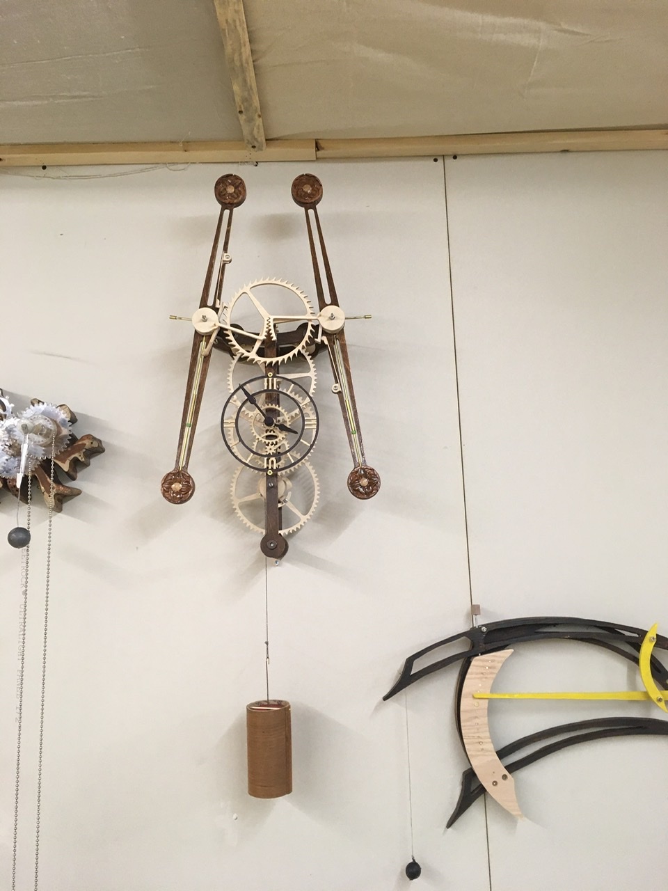

I’ve just completed David Atkinson’s Sextus design and it is the first clock that I installed steel bearings. Although David has bearings in several locations I only installed them on the pendula. Since the escapement is a grasshopper type it is highly sensitive to the drive weight to regulate the time, I found that sufficient weight to maintain the running of the clock meant that the clock was being overdriven. By installing the bearings in the pendula I was able to use a much more acceptable drive weight, and thus more overall time accuracy.
Here is a picture of the finished clock.

Awesome work. I agree totally with you, a bearing can do wonders for almost any work, and I
really advise using them when one can. Merry XMas and thx for showing us your work.

Really wonderful clock John !
Once I did read that bearings give a 70 % reduction in resistance, in comparison to fine polished (e.g. steel in bronze in clocks) pivots.

That's a nice example of the Sextus. It's a very hypnotic design to watch!
I was surprised at how much difference there is between ball and plain bearings. Soaking them in solvent to remove any manufacturer-installed grease apparently helps as well. At the speeds we run these bearings, grease and oil simply add drag.
