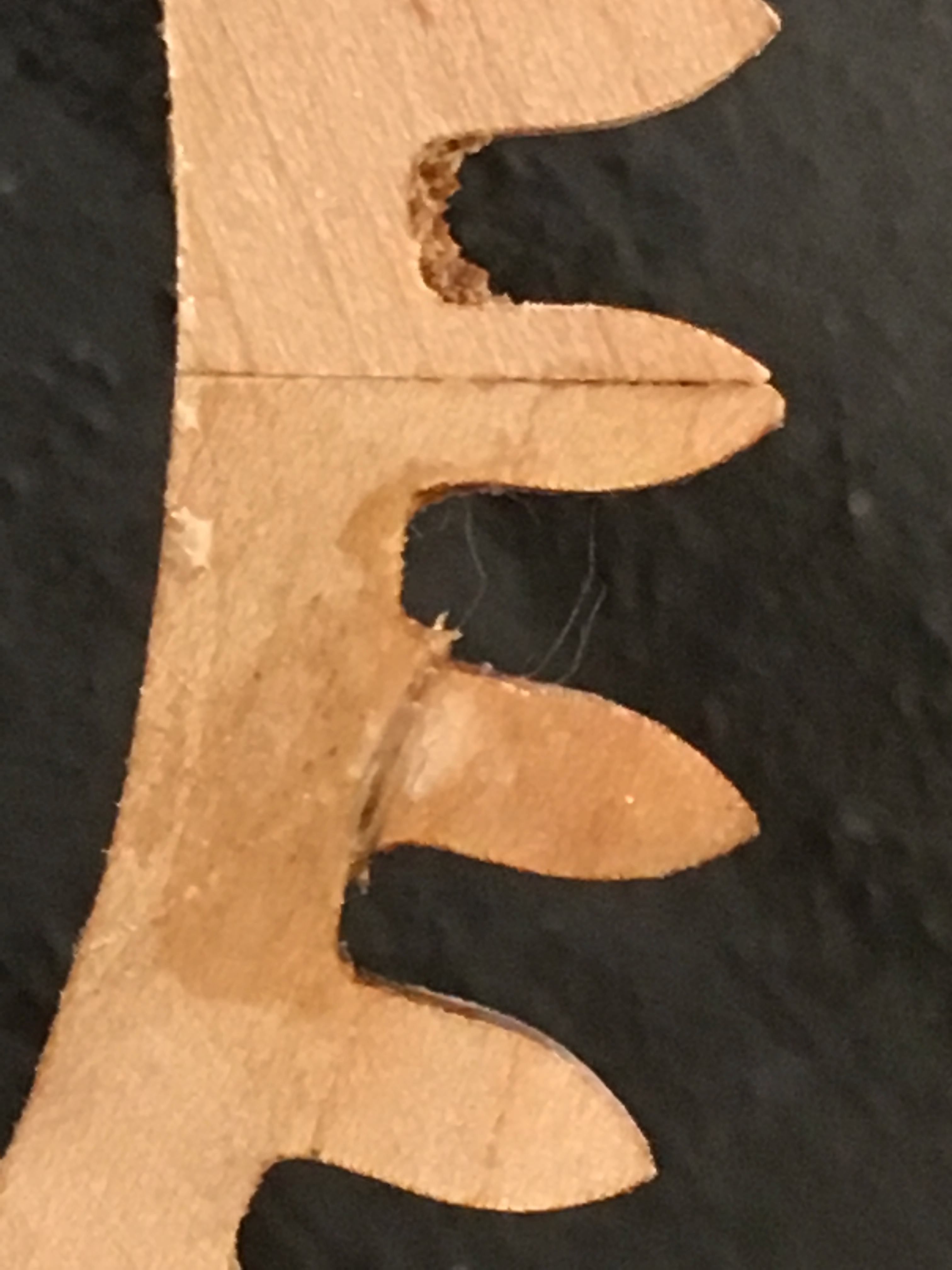

I have a clock that I built using solid maple instead of the usual Baltic Birch plywood.  I wouldn't recommend solid hardwood for many reasons not the lease of which is that the teeth on the gears are "fragile".  Under normal operating conditions they are fine but when there is a upset things can go wrong.
The gear shown below has had a couple of teeth broken by the winder and trying to re-attach them while maintaining the original alignment proved next to impossible - so while the gears seemed to mesh then were enough off to stop the clock.

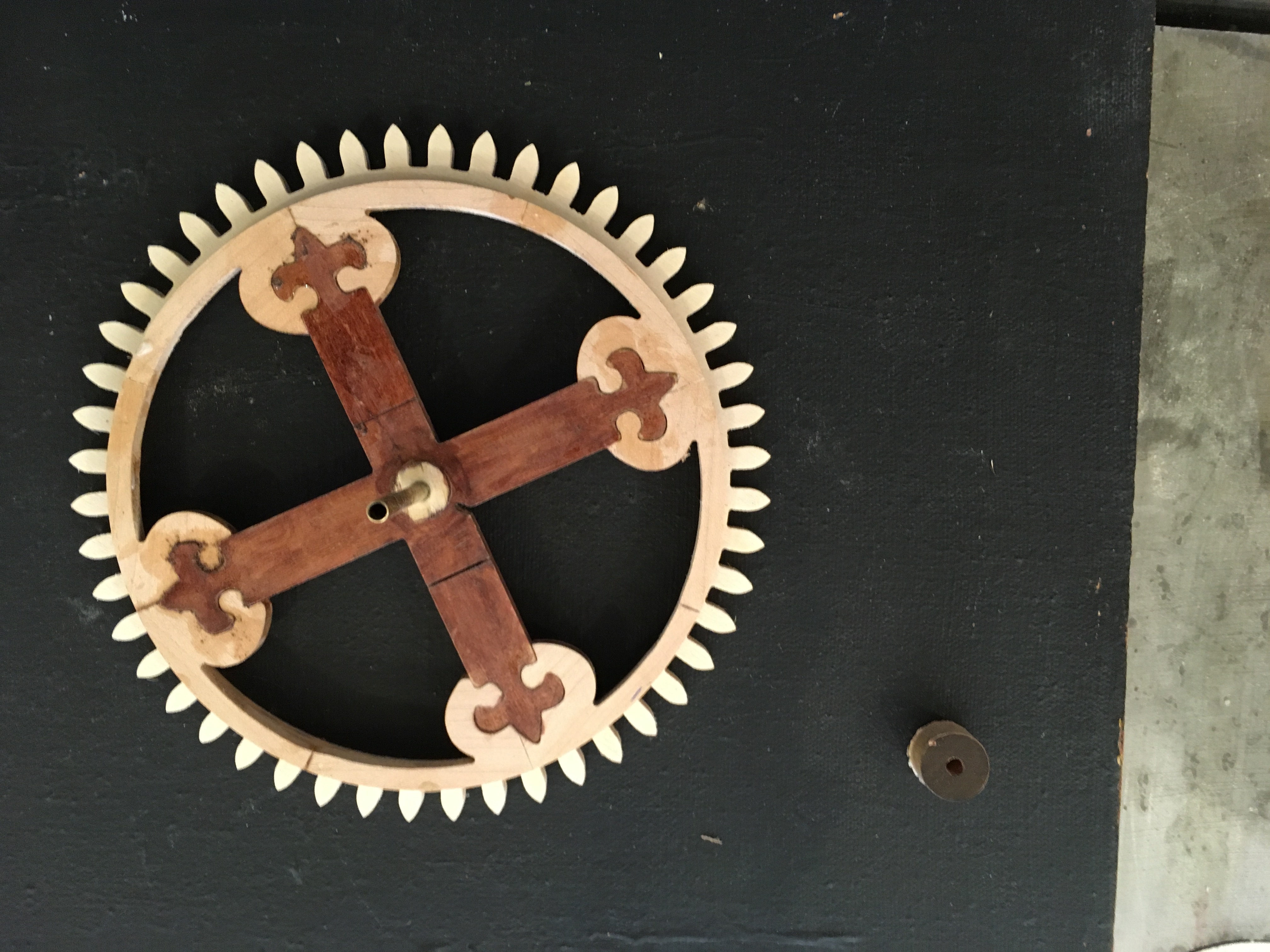

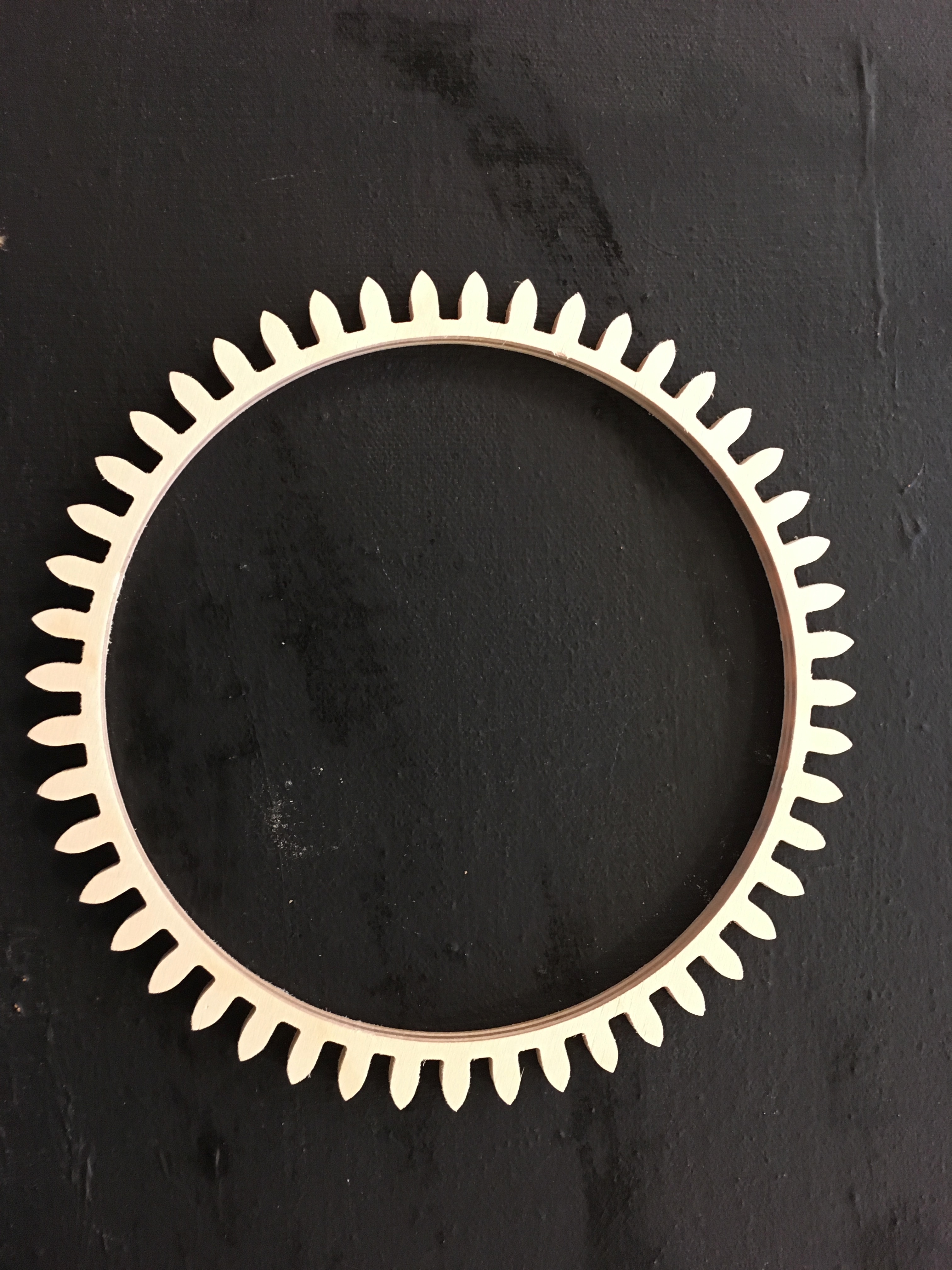

My solution was first to cut the teeth in Baltic Birch with the rim 1/2 the original gear.
Next I took all the teeth off the hardwood gear and half of its rim.

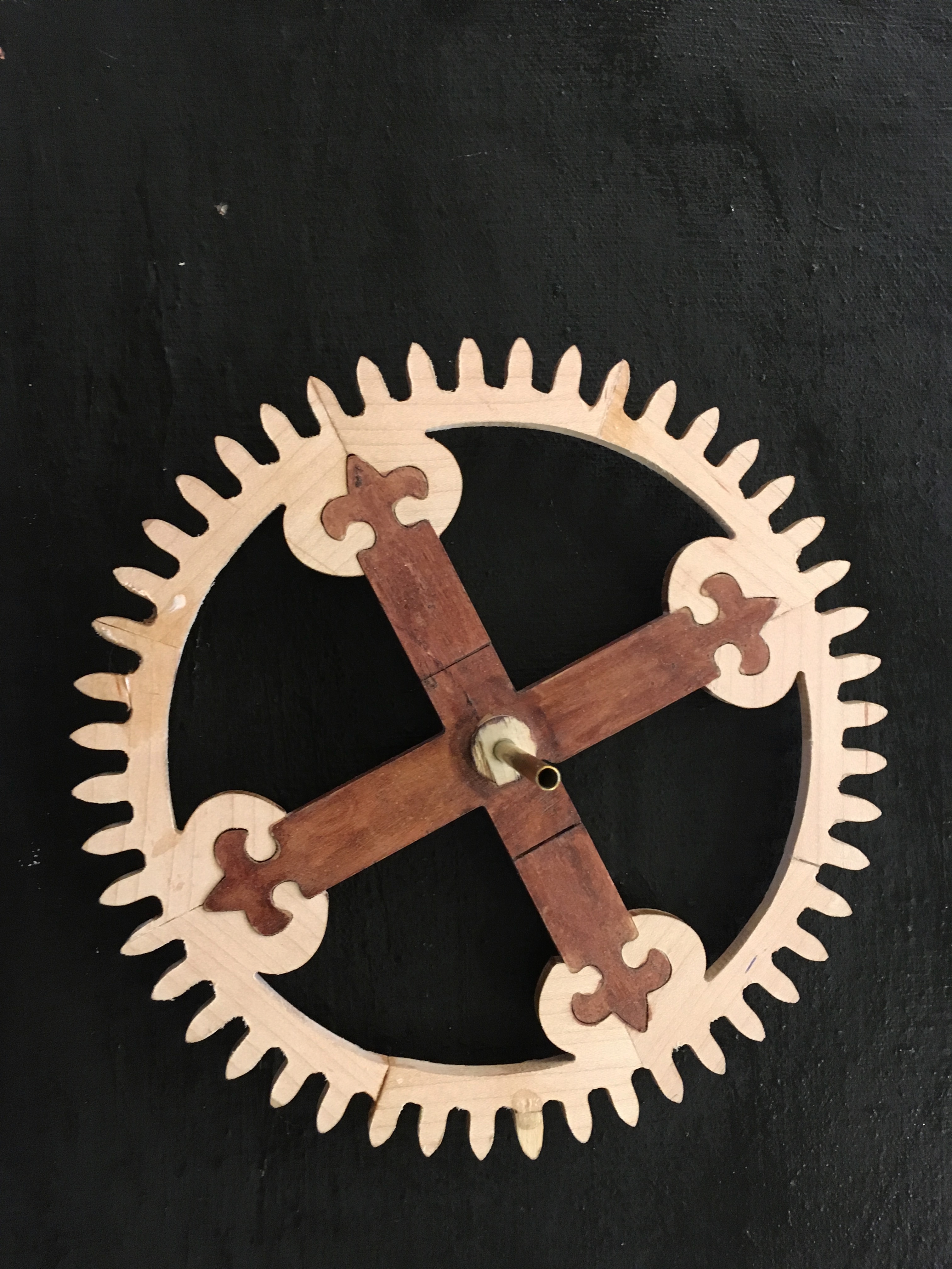

There was a fair amount of careful fitting but the final gear had the hardwood features and perfect teeth.
The clock now runs reliably.

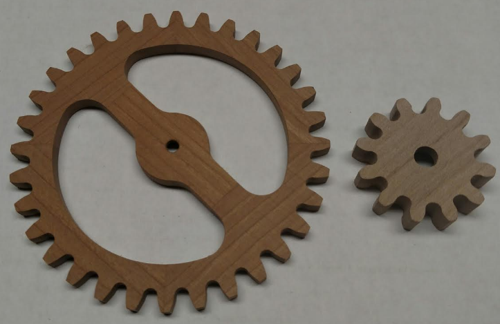

Here is a wood gear with involute teeth in cherry.  The teeth seem strong enough.  I used a 1/8" router bit that naturally leases rounded shoulders.
Steve
