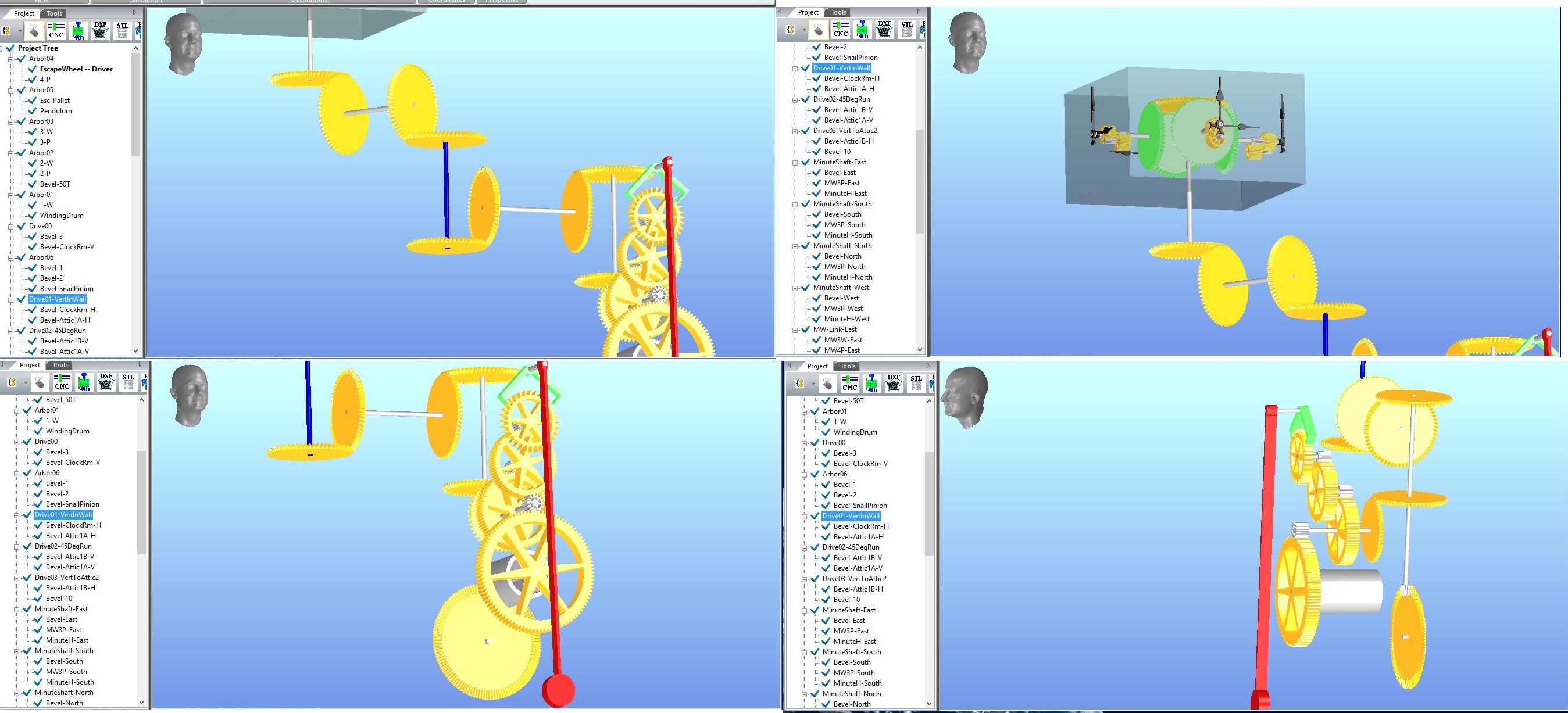

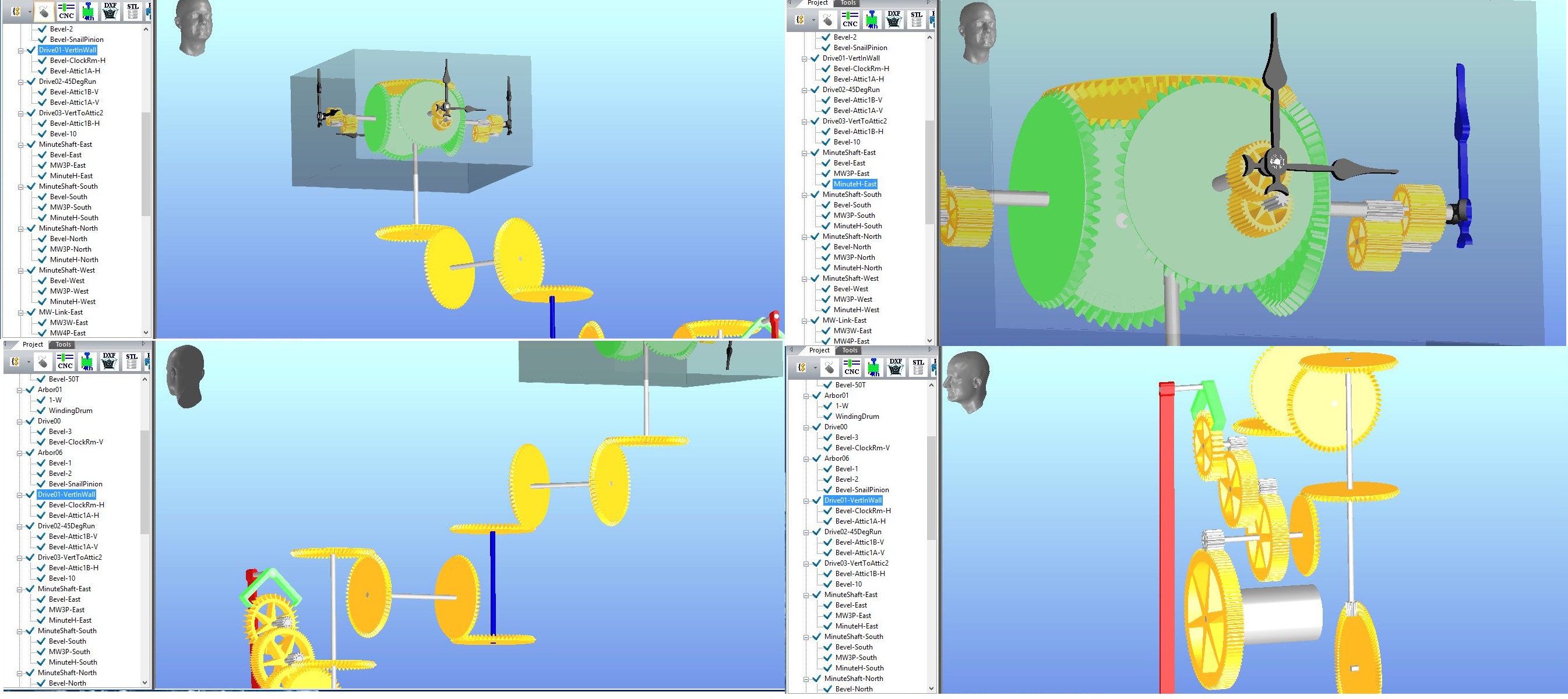

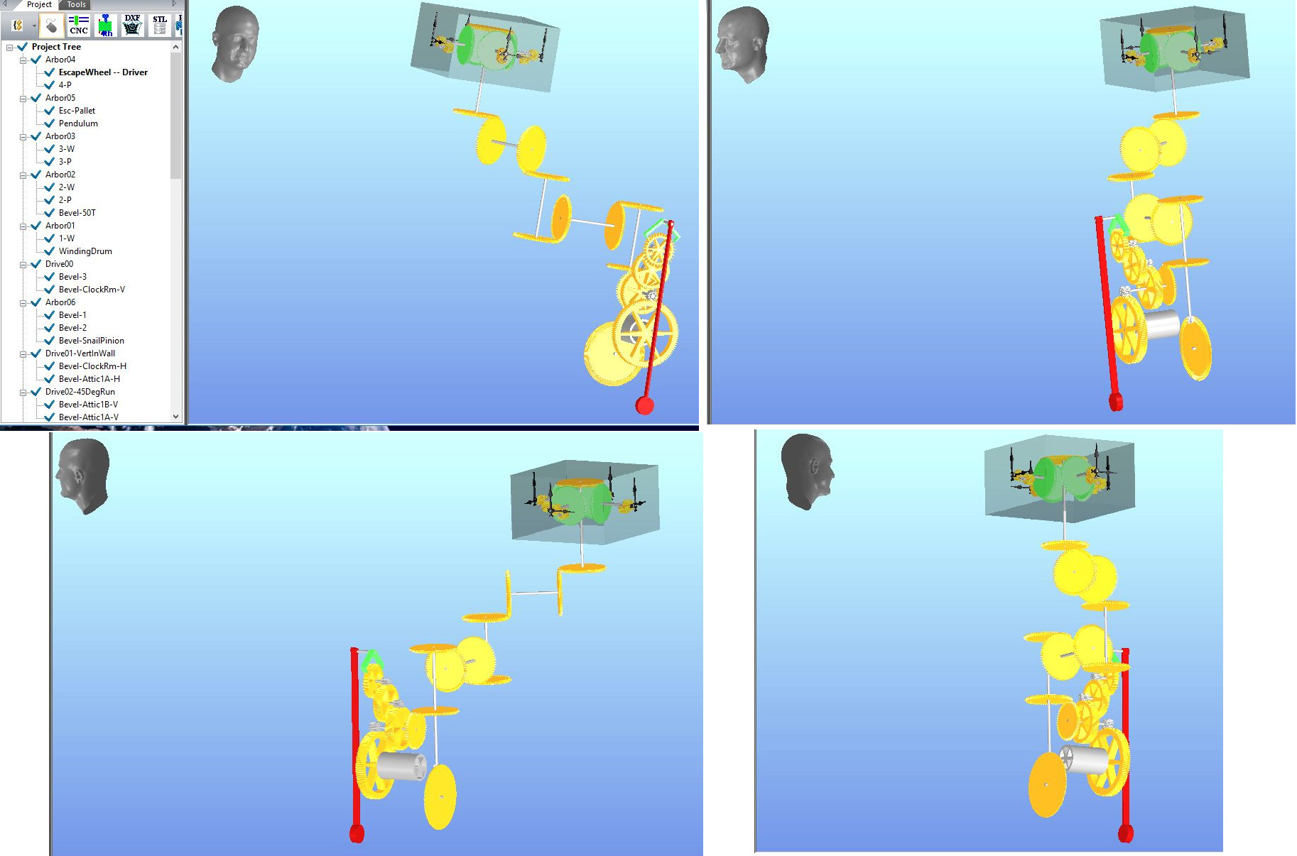

Thanks for the info. Attached are jpgs of the Tower Clock simulation that I'm working on when I stumbled across the additional anomaly with the reversed bevel gear.
I'll work on a video of the running model in the next few days. I'm impressed how rapidly the .gth file grows as the bevel gear sets get added to the model. The .gth file is now >93MByte...not something that will ever get uploaded anywhere. I may put it up on my google drive.
I am impressed that even with the size/complexity of the model that the simulation runs well on my notebook computer.
Bill

Re: Linkage error when reversing Bevel Gear
Thats quite a piece of work that. Yes, they do get large. Each object holds quite a bit of data, all one object type really ,
with variables telling each object what to look like and how to rotate.. Nice to hear it still runs smooth even at that size, I
havent made anything that complex in quite a while...
The tower head is quite impressive...
Thx for the look,

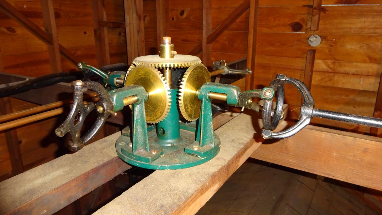

Nice work Bill, always wondered how they did that 4 side clock face, thanks for sharing.

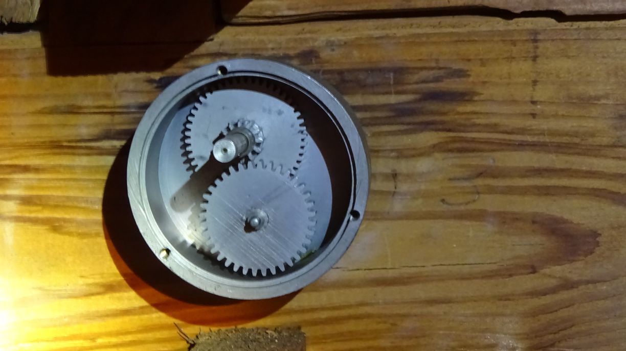

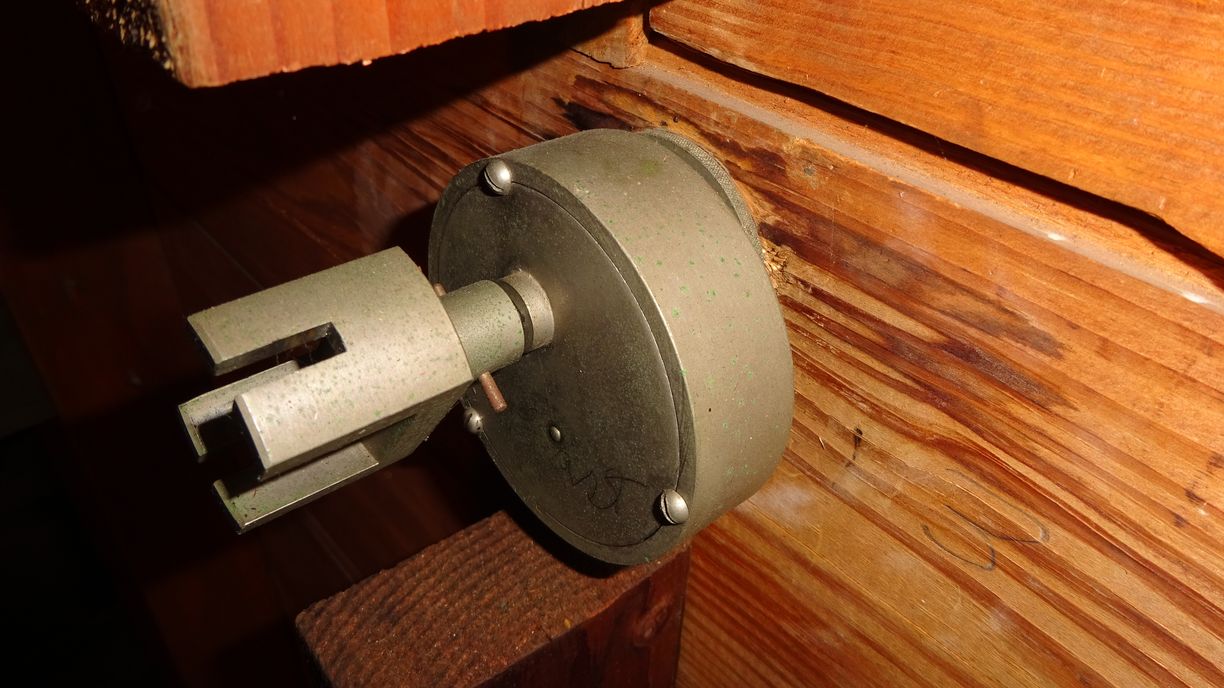

Hi Bob
The attached photos show the inside of the clock tower. The 4-way bevel gear split is kind of unusual..the top gear is 60T and the mating gears are 50T. This reverses the 50T-60T gearing in the clock room. Our guess is that the first 50T-60T reduction may have been used to bump up the torque a bit prior to the chain of bevel gears to the tower. When the clock was last running in early 2010 the wear and buildup of friction had reduced operations to a single dial. Input /Output of each bevel set is driven via universal joints.
The current installation is different from where the clock came from. The clock mechanism was probably mounted directly below the 4-way split which would have greatly reduced frictional losses in the drive train.
The second two jpgs show one of the motion works. The input to the motion works is the minute shaft. At the time we examined one of the motion works I did not have time to document the gear thicknesses, # of teeth, or gear diameters. What I modeled in Gearotics was my best estimate of the gear ratios and sizes.
My goal of the simulations is to document the mechanical details of the entire clock.
Bill
